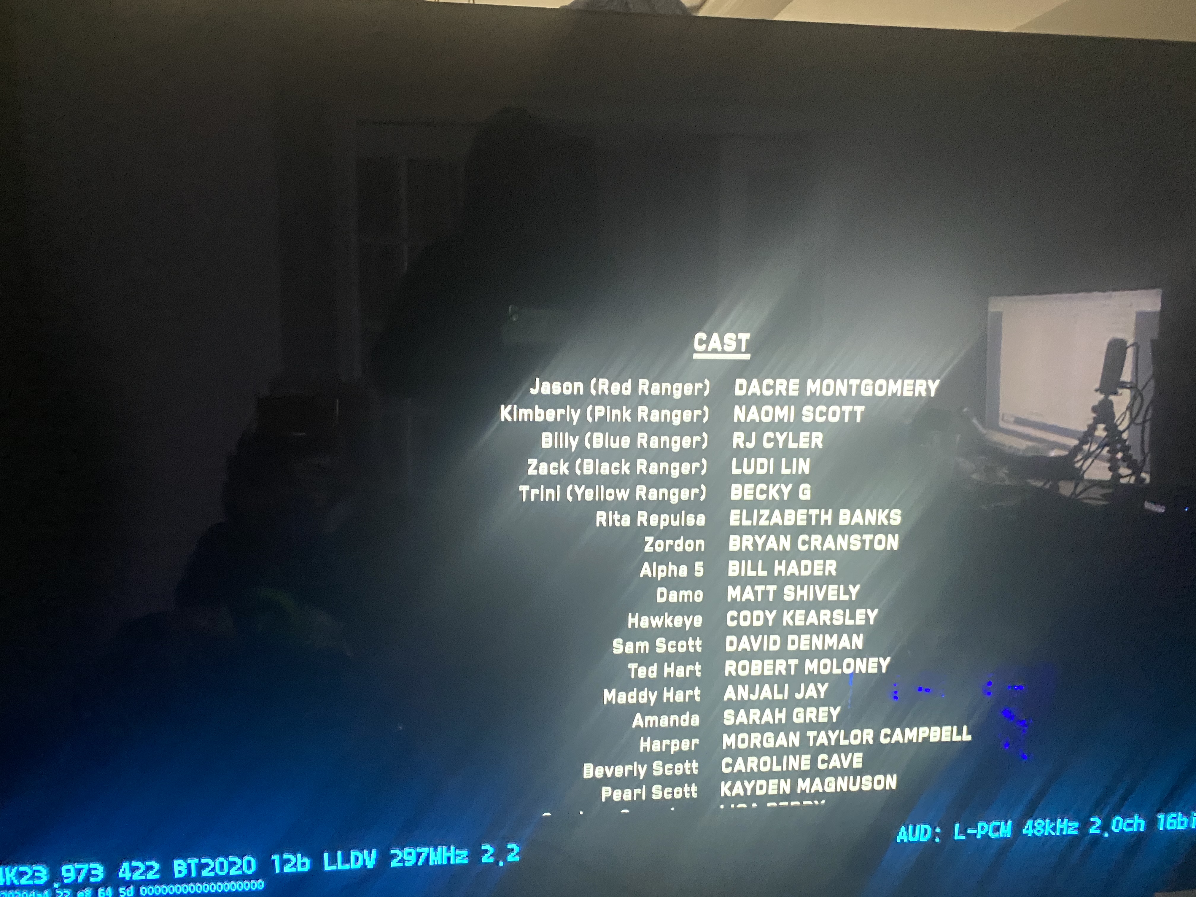

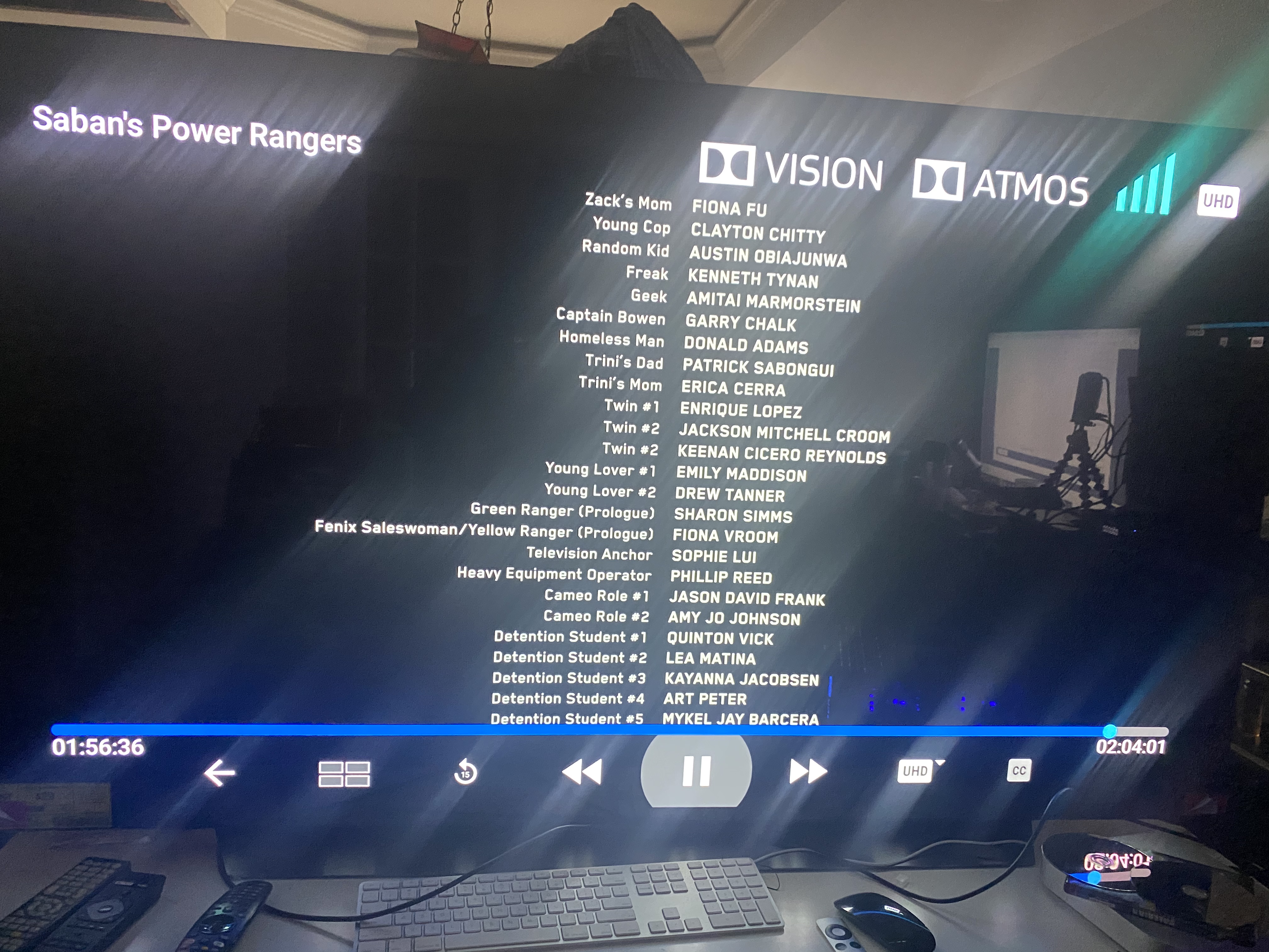

Post by Manixx2020beyound » Tue Mar 16, 2021 6:26 pm
On another topic myself & @reset9999
I Had a bet:
I think I won lol,
P5 is the same as using p7 fel
Even doe the itcp is different seem like in the final encoding process the 12/16bit rgb tif DV meta is transferred to the p5 as well ending credits for power rangers on VUDU is bright white as well.
So would also mean the p5 uses the fel prior to encoding to p5 which is meta from the xml
So p5 is also better than regular hdr10.
Also means p5 is not just hdr10 with Rpu

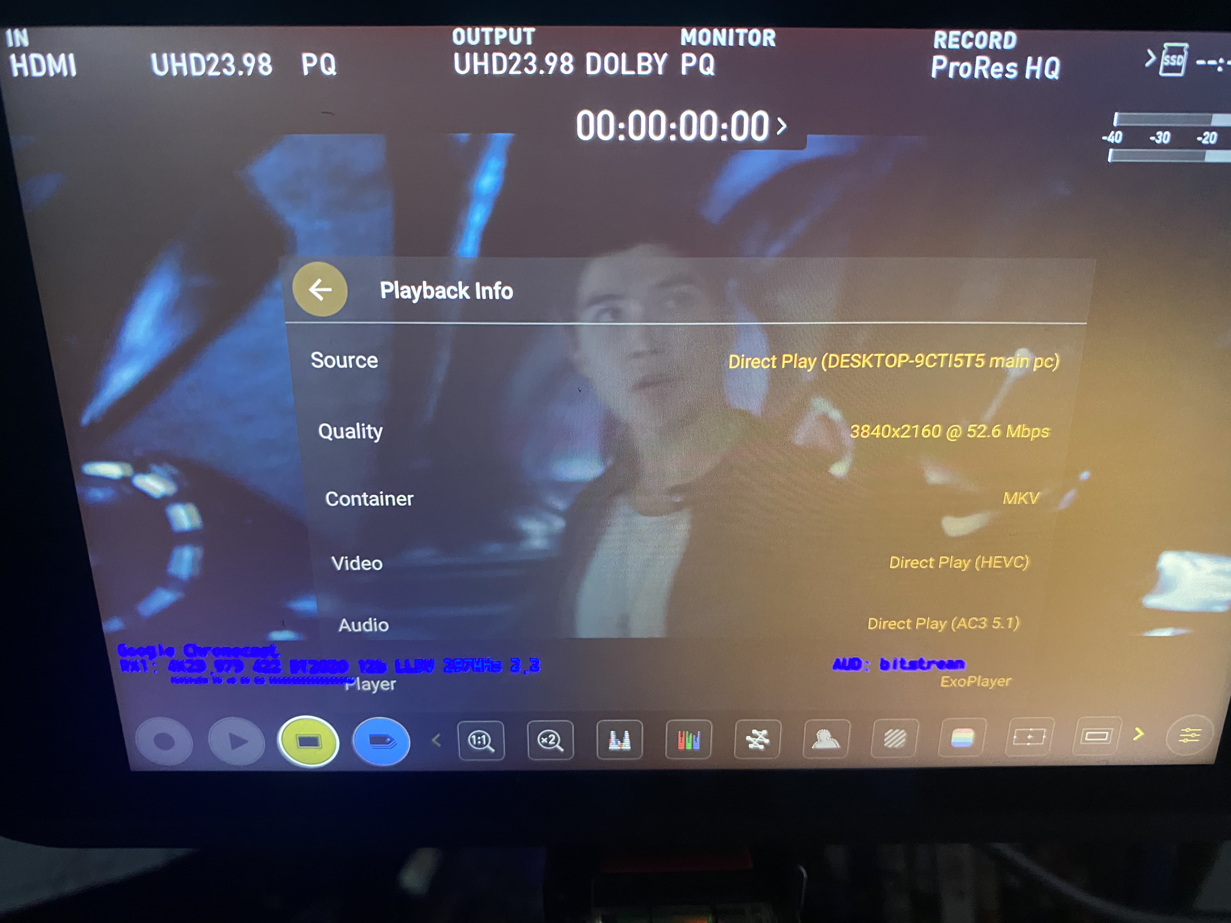

Manixx2020beyound wrote: Tue Mar 16, 2021 3:39 pm Patiently waiting lol C129E41E-7225-49DB-A88C-6B4D8865361B.jpeg
So Chromecast can read fel?

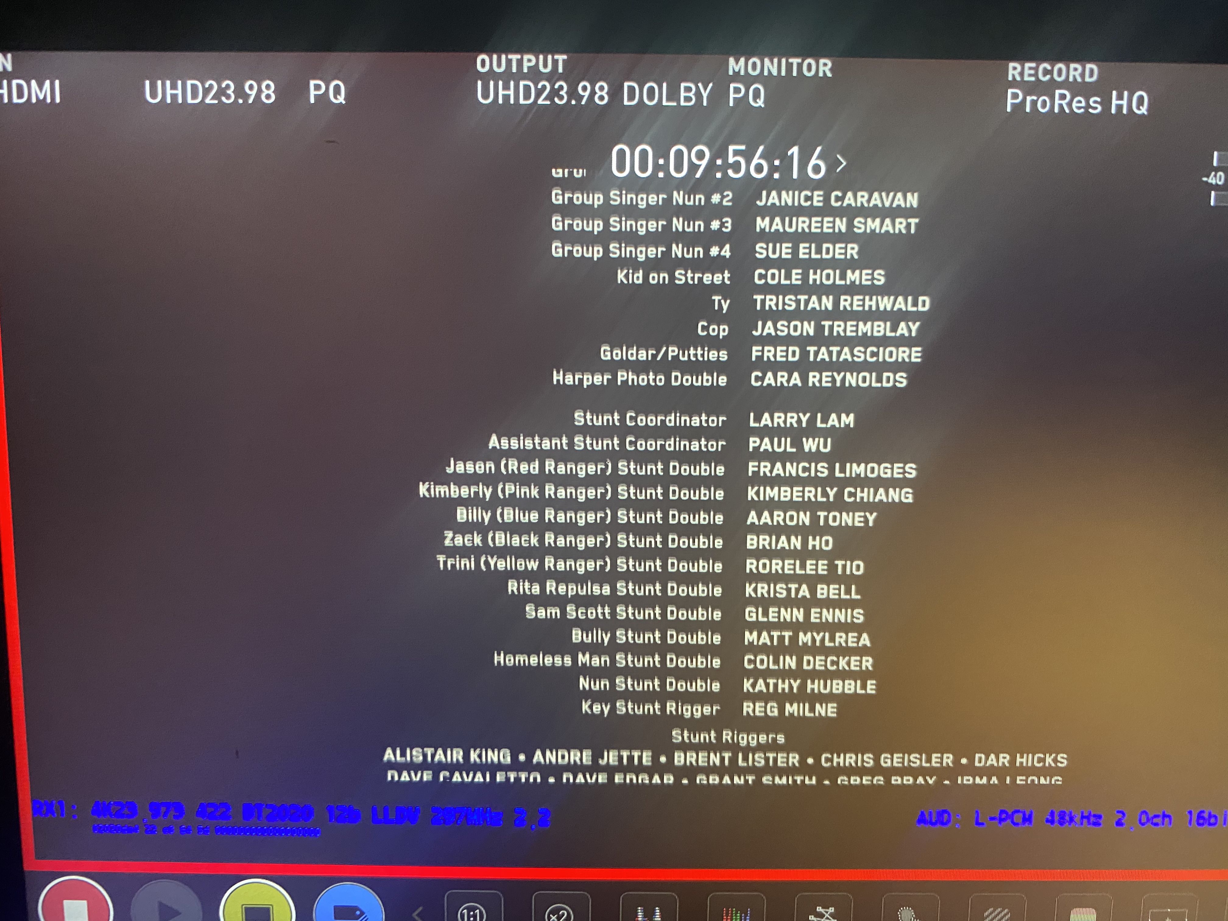

Post by Manixx2020beyound » Tue Mar 16, 2021 10:23 pm
hepe9 wrote: Tue Mar 16, 2021 10:10 pm
Trying 1 last time
Set timer came back tv was off lol
Strange thing doe if I force LLDV from the device it plays the whole movie but NO fel
Trying when it triggers naturally is the issuse .
But I’ll keep trying seeing that the ugoos is no go.
Sonyx700 or streaming platform still the best option for fel movies.
