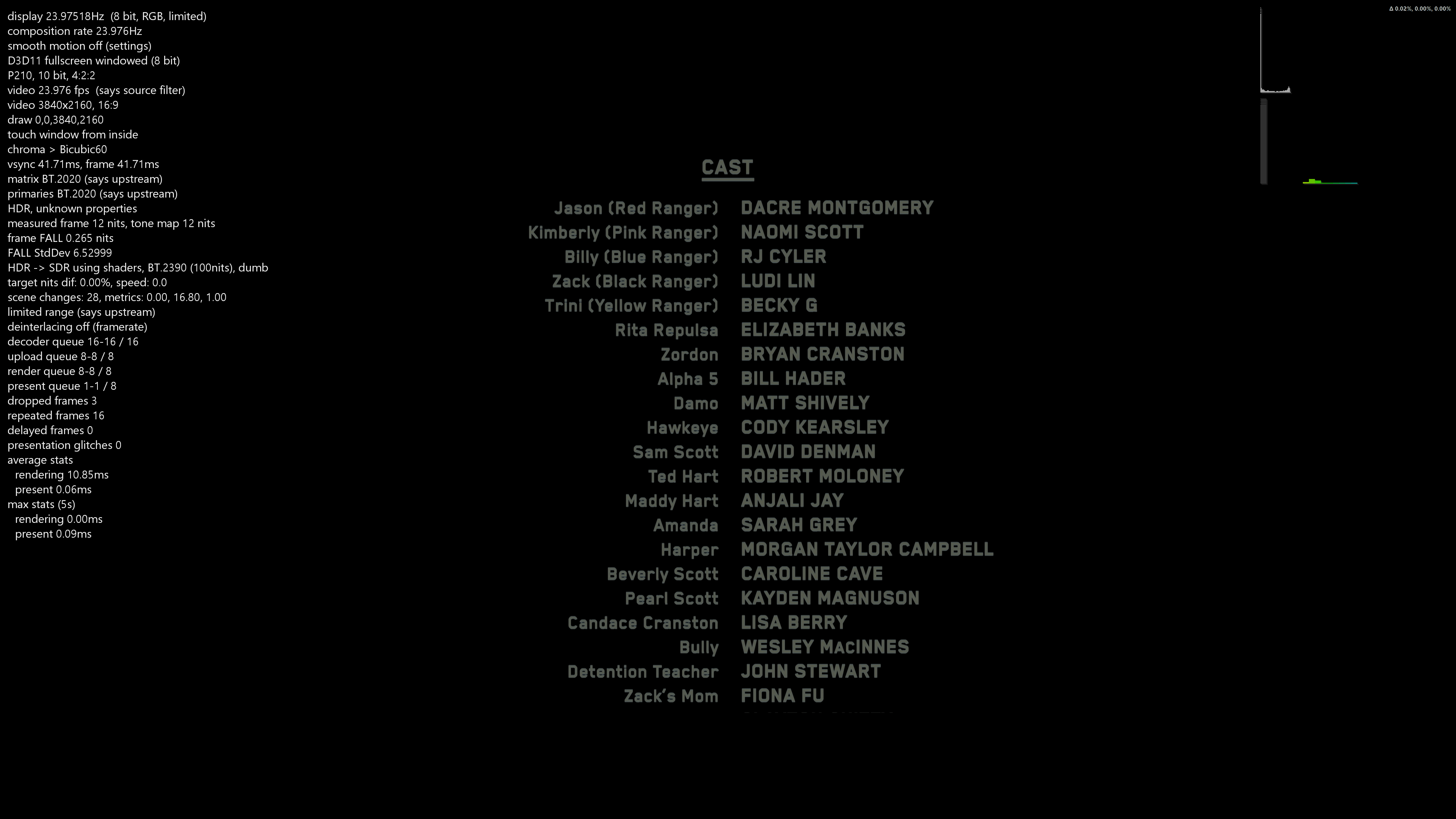

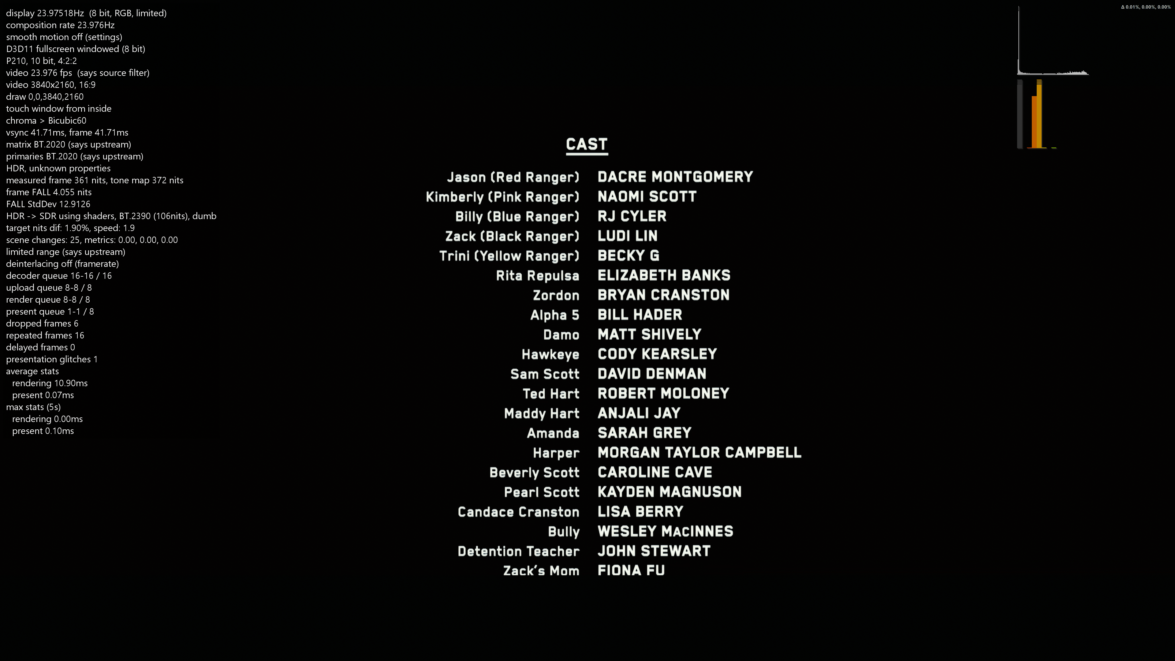

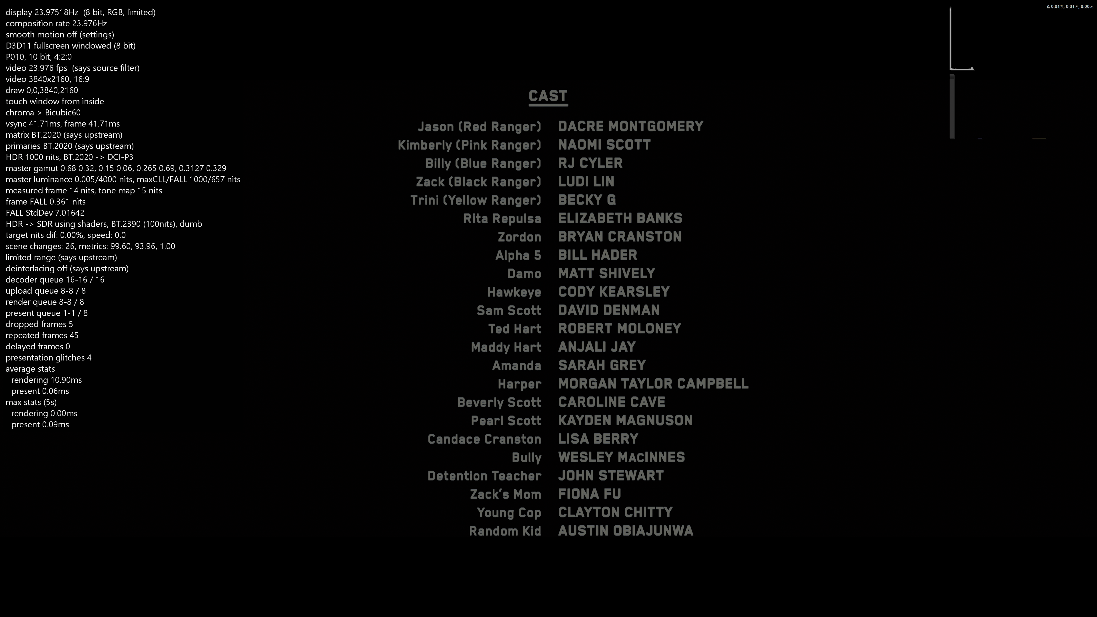

#4653 Post by Manixx2020beyound » Sun Mar 14, 2021 5:50 pm
Ending credits Power rangers
Hdr10 version is faded
LLDV dune version not playing Fel from iso.
Sony x700 LLDV using the Fel.
As we can see LLDV on dune looks worse than the real hdr10 comparison when not using the fel.
And when internal LLDV processing is done right fel it is clearly diff from hdr10.
Actually during playback on the dune just the ending credit there were green white red blue flashing in the background as it seems to disregard the fel on the fly.
If anyone can show a comparison with the real hdr10 credits looking like the x700lldv I’ll rest my case that LLDV is NOT worse than hdr10.lol
Fel
Last edited by Manixx2020beyound on Sun Mar 14, 2021 7:16 pm, edited 5 times in total.
