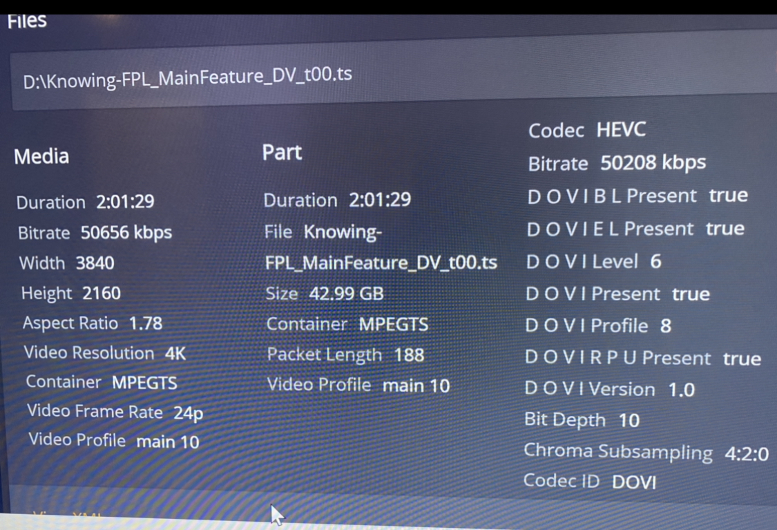

Just tested the Knowing which is FEL as well watching looks good too,
I made a single layer fel ts using make mkv 1st.
Ok got a nob question for u guys that make
Thes conversions
How did I manage to get profile 8 with bl-Rpu-el ??
Please help on that part is that real
Thes conversions
Thes conversions
