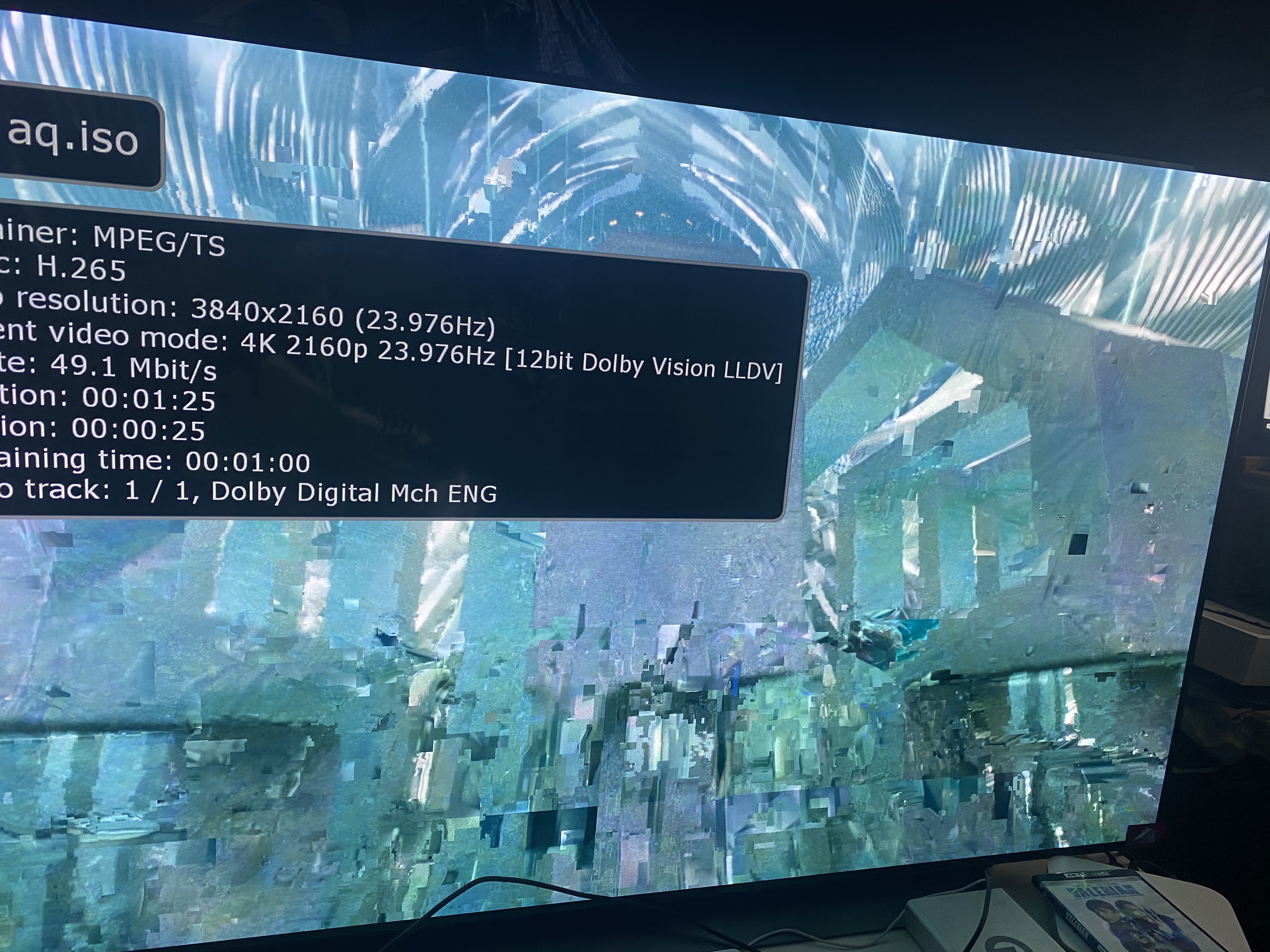

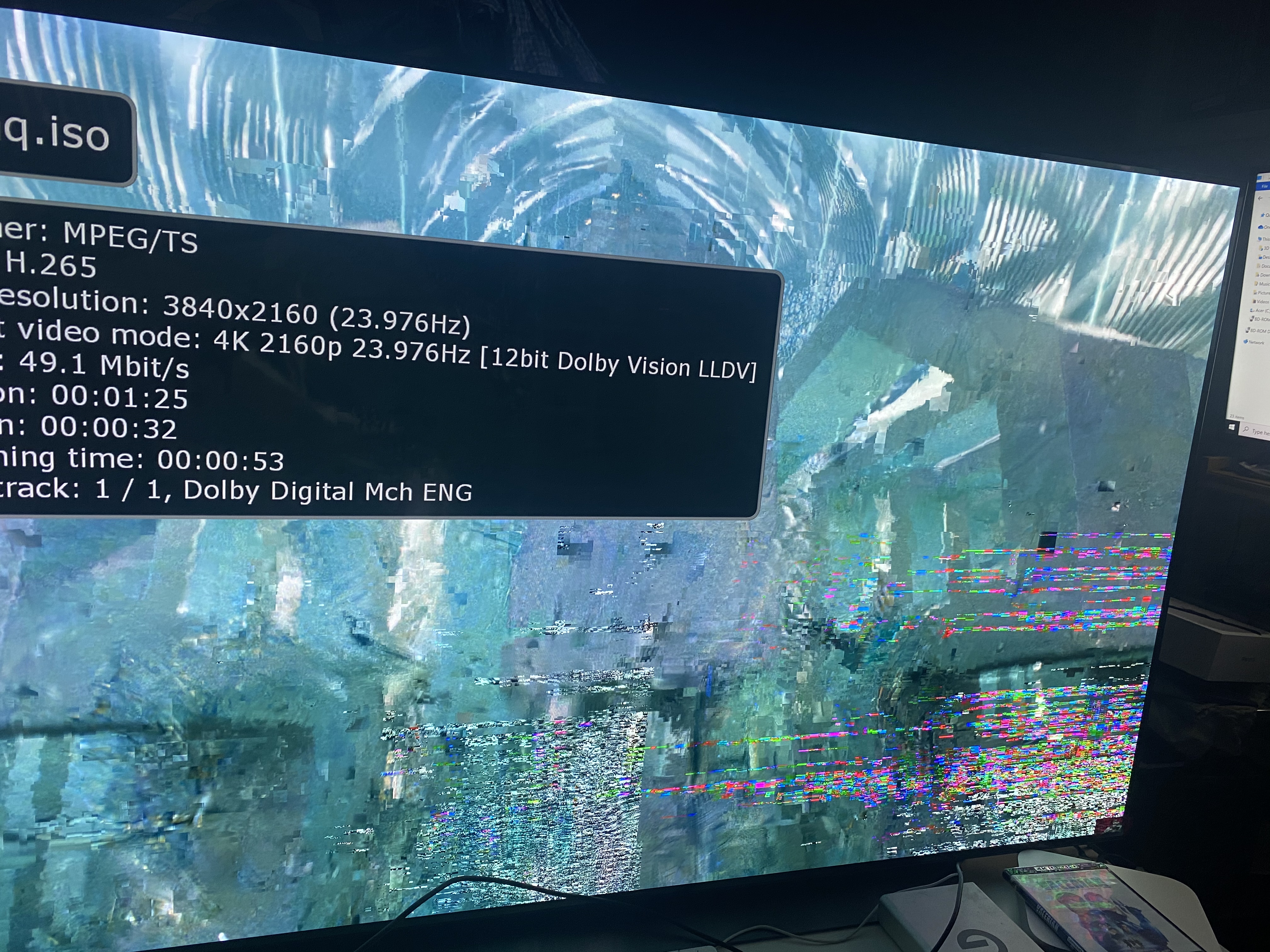

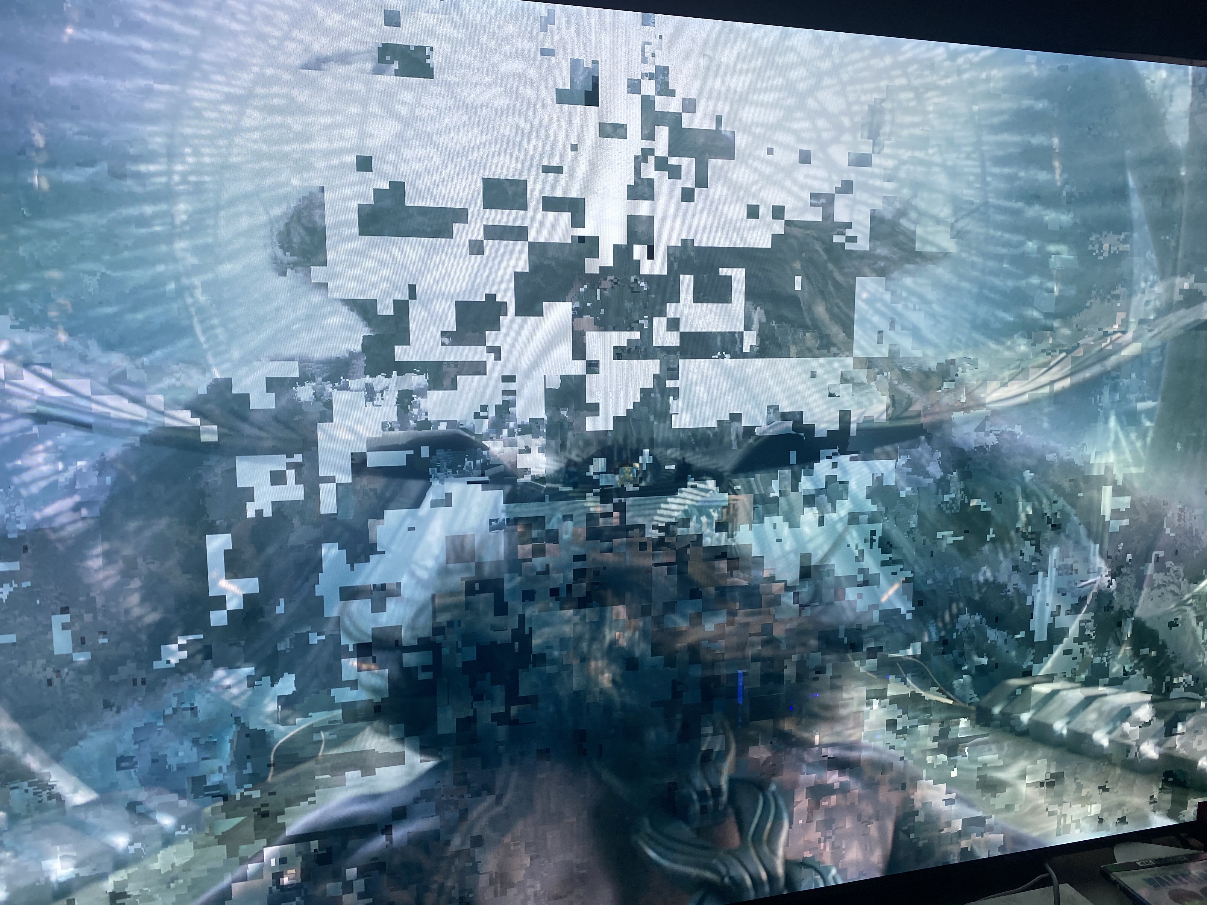

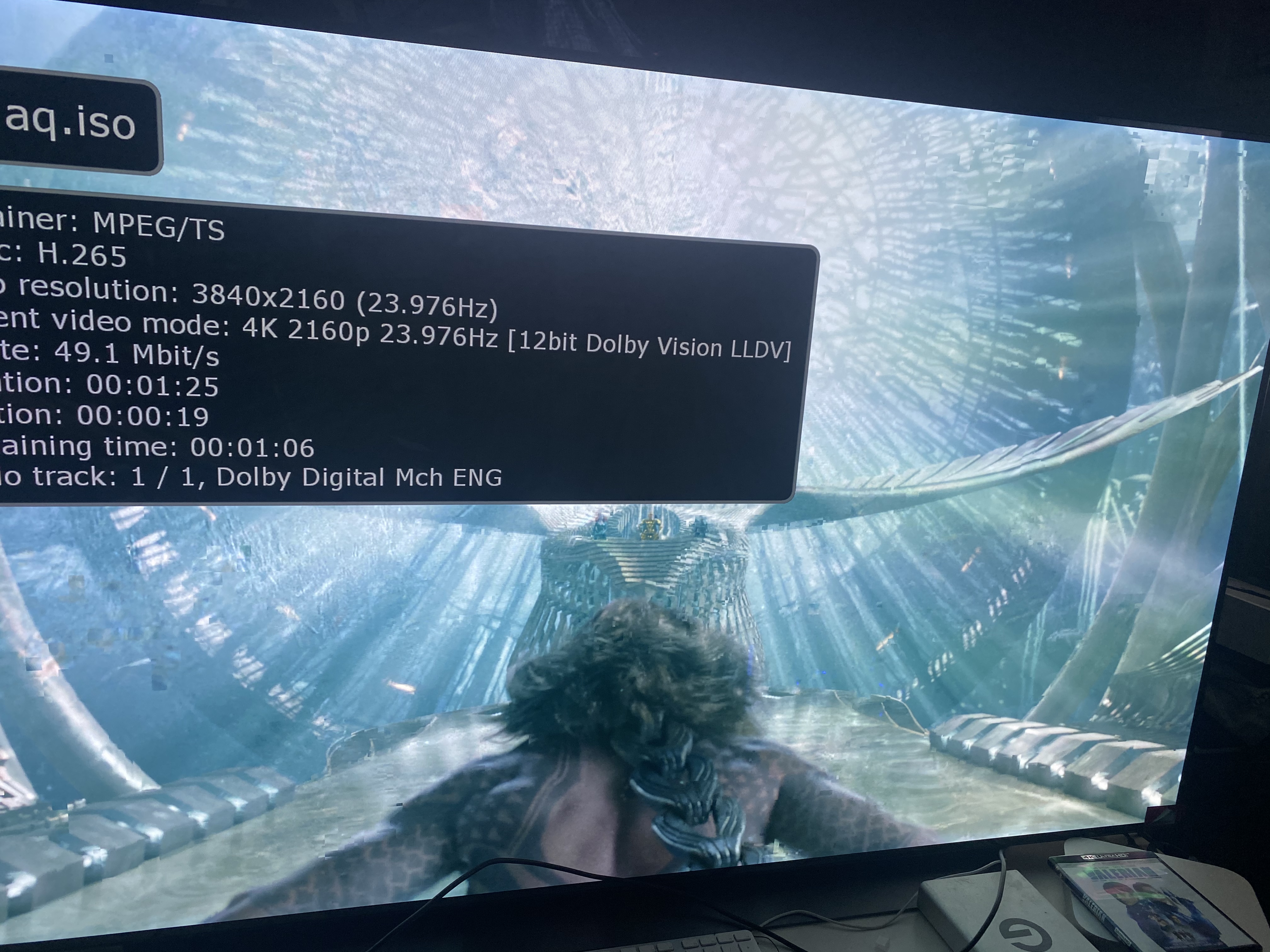

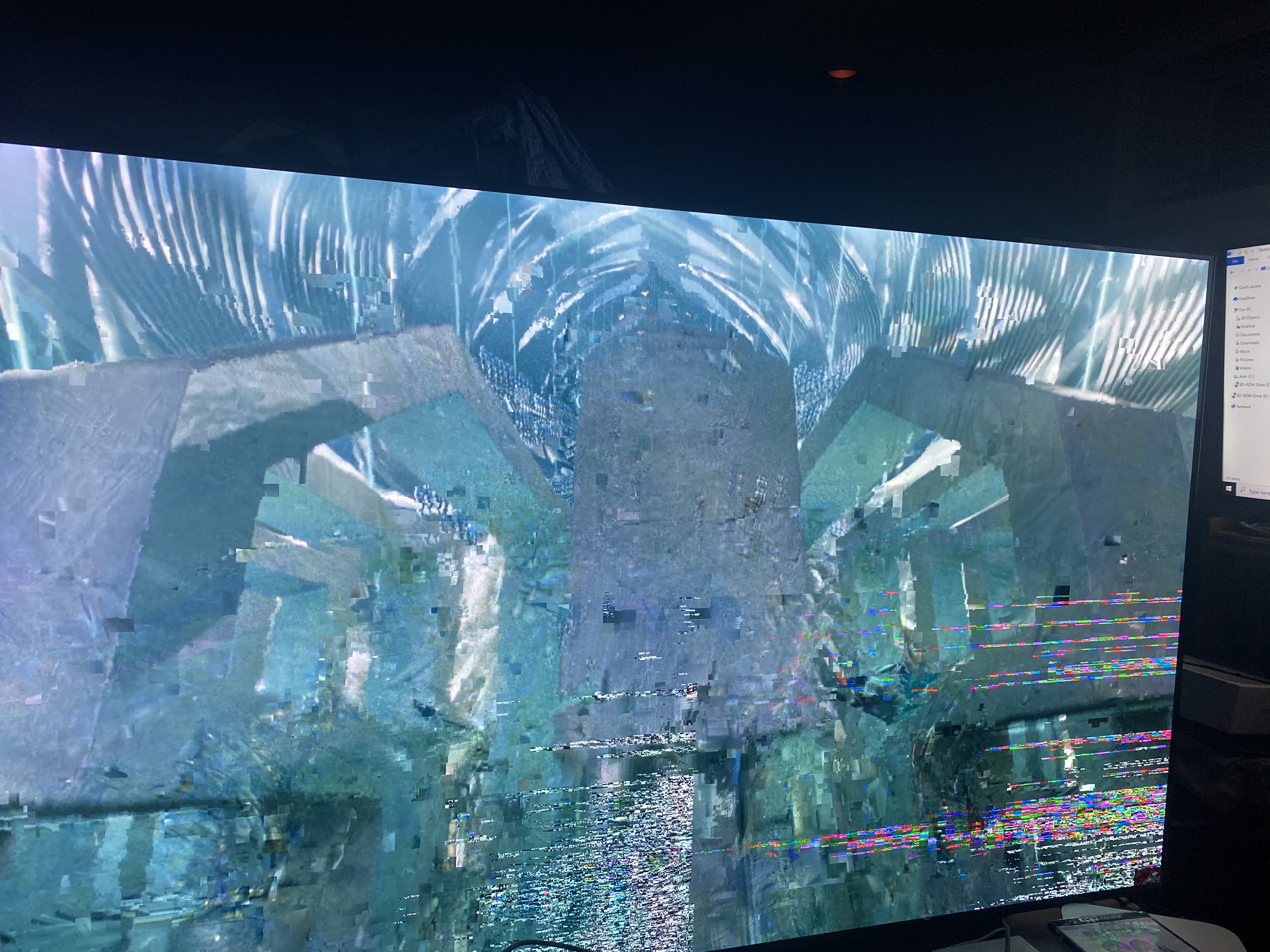

Did anyone with a dune try kodi dv build ?regular xbmc does hdr fine on the dune.
Tested aquaman el test works on dune
Used tsmuxer on the mp4 I see the errors and lum shift only in iso mode to lite but has to be iso
According to the test file the dune is processing the el

    Post by Manixx2020beyound »
    Processing the el
    Aquaman is MEL
    That's just a glitchy file

        On my setup chrome cast gave me to most issues, bc off my vertex2,
        P8 plays for me but only a few minutes.
        But directly into the tv works better.
        & plex is the only way on Chromecast?
        P5 plays fine of course.
        Chromecast cast feel like the vs10 engine
        LLDV on it clashes with LLDV on the vertex2
        When I use my amplifier u see 24bit 422 yuv as well without the vertex2 another answer that’s it’s LLDV only. Also no forced dv8 rgb from the vertex with that device
        Vs10 engine is LLDV from what the vertex is showing

        Just finished testing mkv dv version playback Total Recall whol movie playback
        Smooth & trigger DV plex ( no vertex) in volved but I can capture which means it’s also LLDV but quality seems better already I can tell diff from the dune.
        El is being used but I’ll wait for confirmation
        @$50 dollars lol with the dune price I can get 9 chrome cast device lol
        I also have no issuses skipping chapters
        File plays normally
