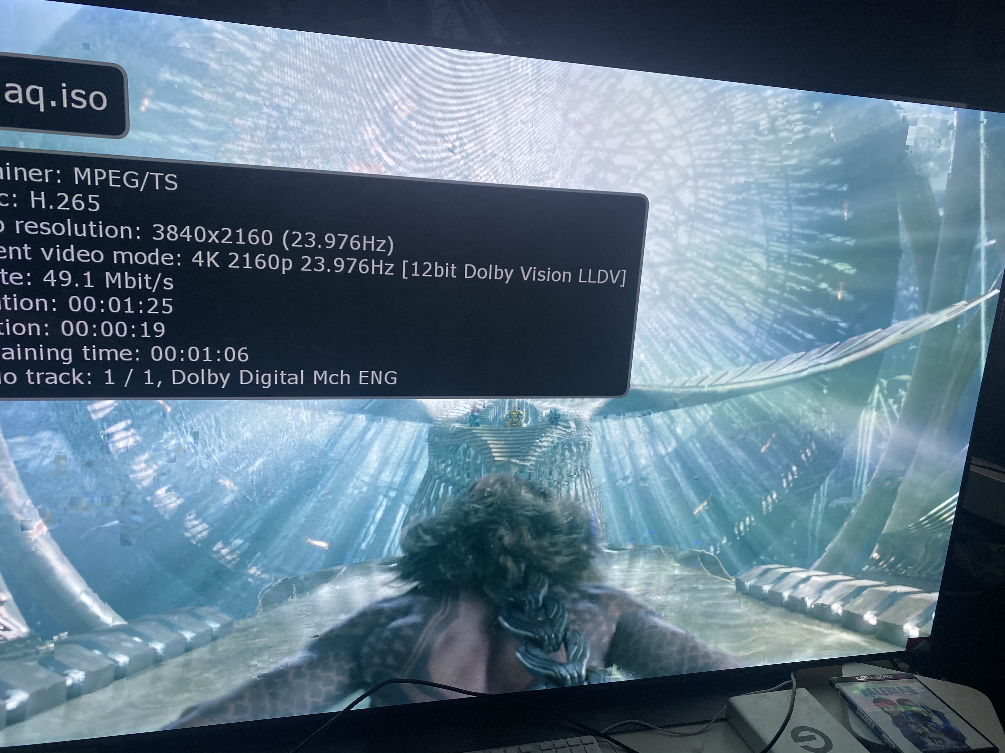

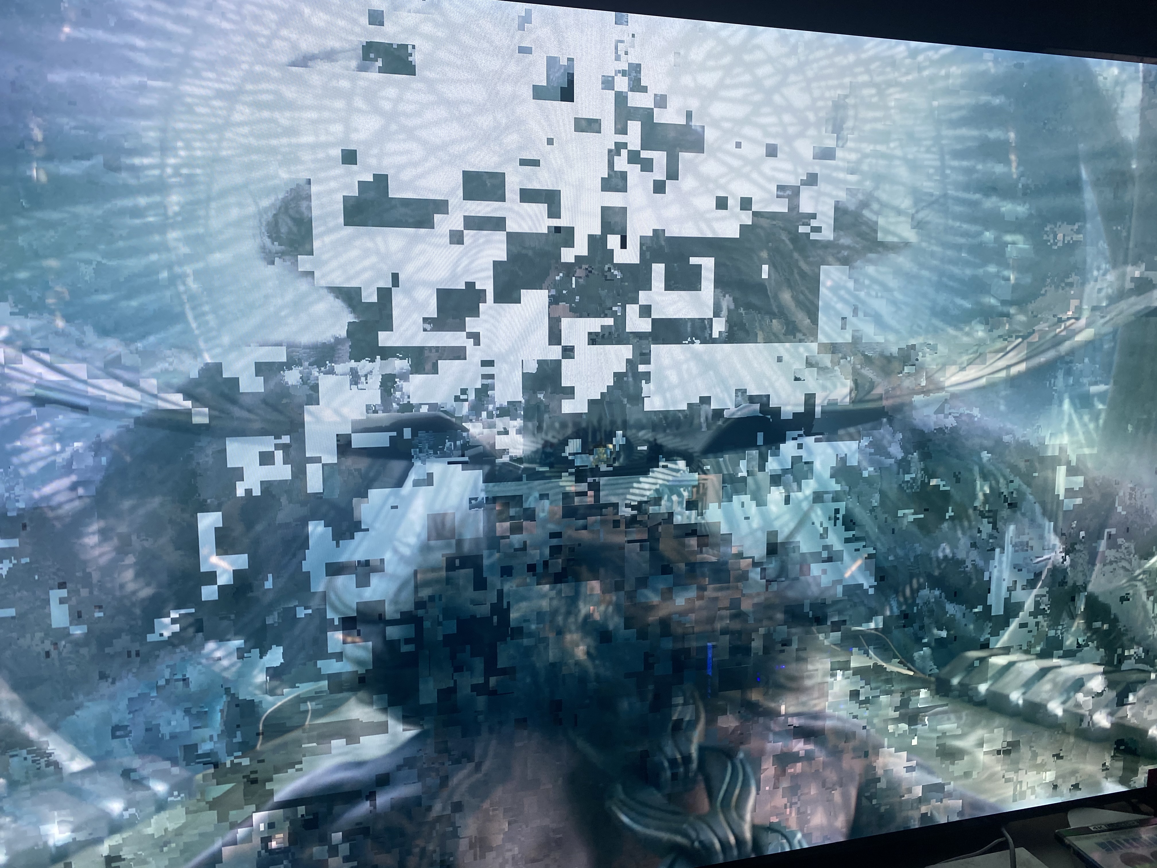

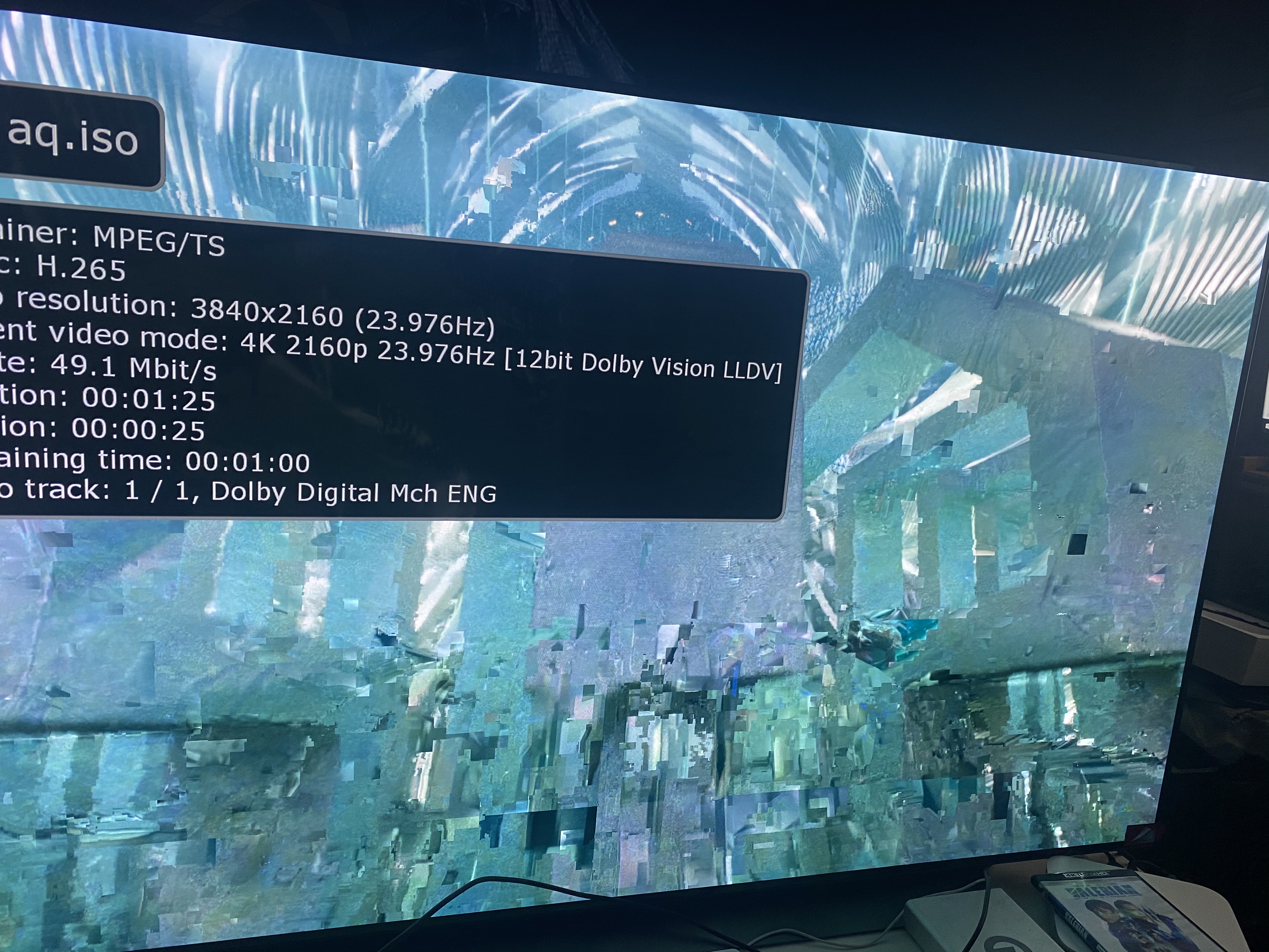

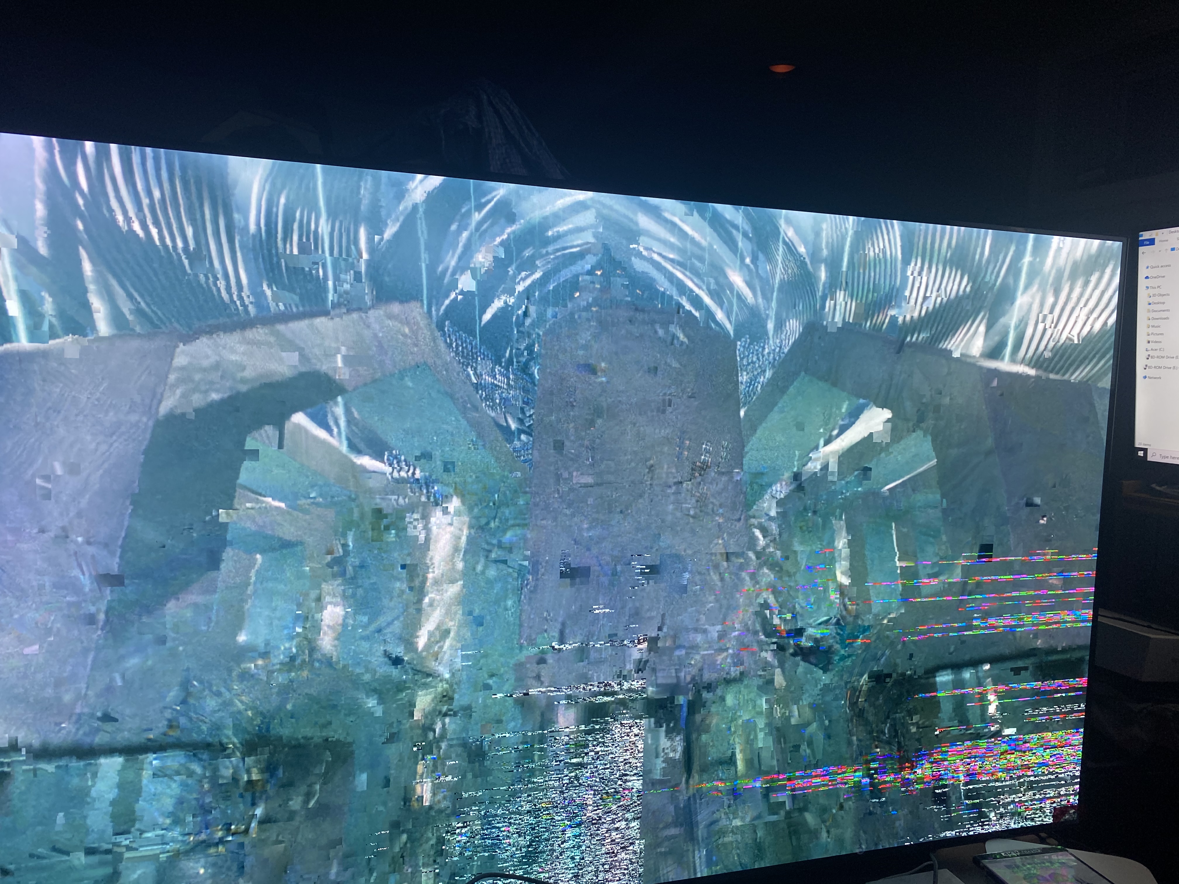

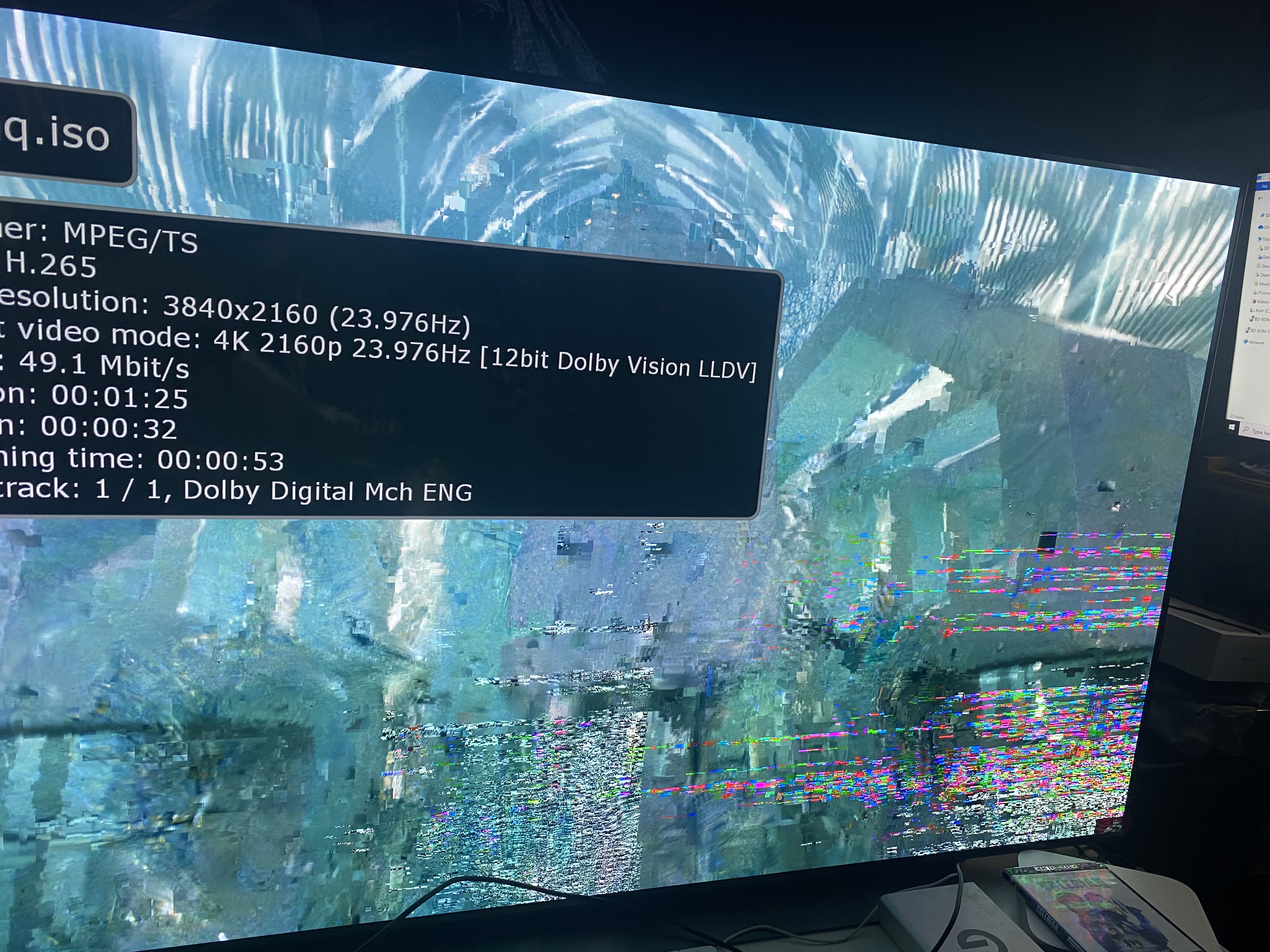

#4520 Post by Manixx2020beyound » Fri Feb 26, 2021 12:05 am
Did anyone with a dune try kodi dv build ?regular xbmc does hdr fine on the dune.
Tested aquaman el test works on dune
Used tsmuxer on the mp4 I see the errors and lum shift only in iso mode to lite but has to be iso
According to the test file the dune is processing the el

    #4523 Post by Manixx2020beyound » Fri Feb 26, 2021 1:04 am
    Processing the el
    #4524 Post by RESET_9999 » Fri Feb 26, 2021 1:11 am
    Aquaman is MEL
    That's just a glitchy file
