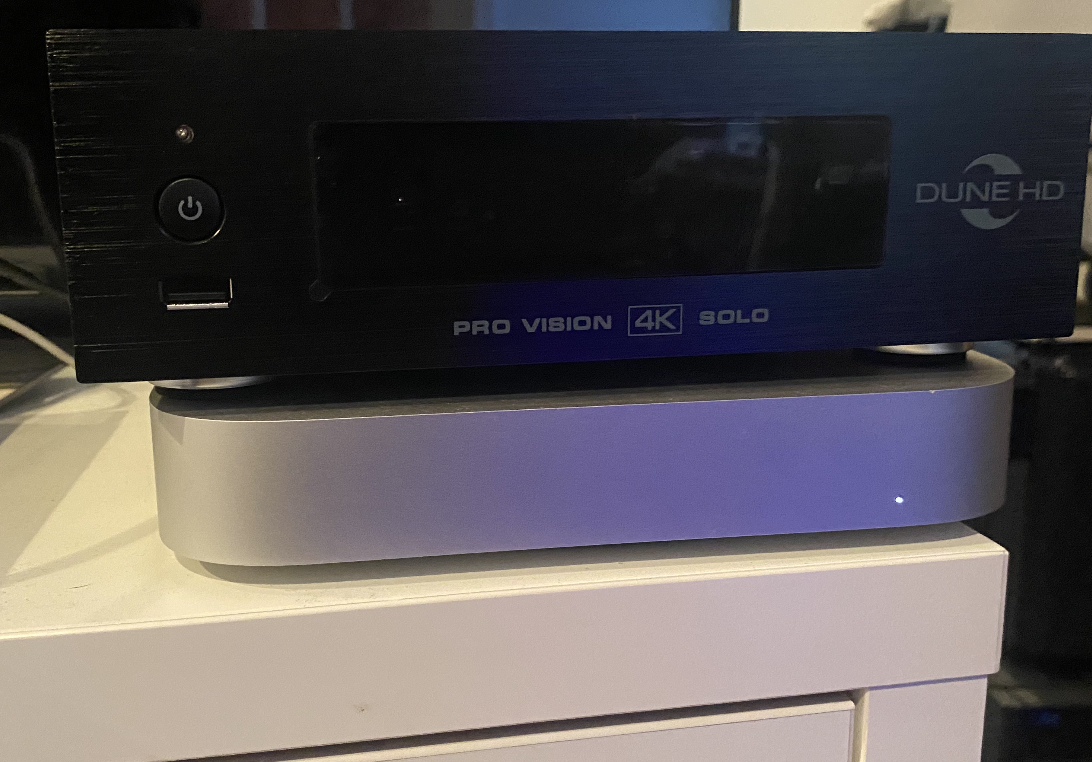

It’s here & it’s a solid build heavy too
Size compared to a mac m1 mini

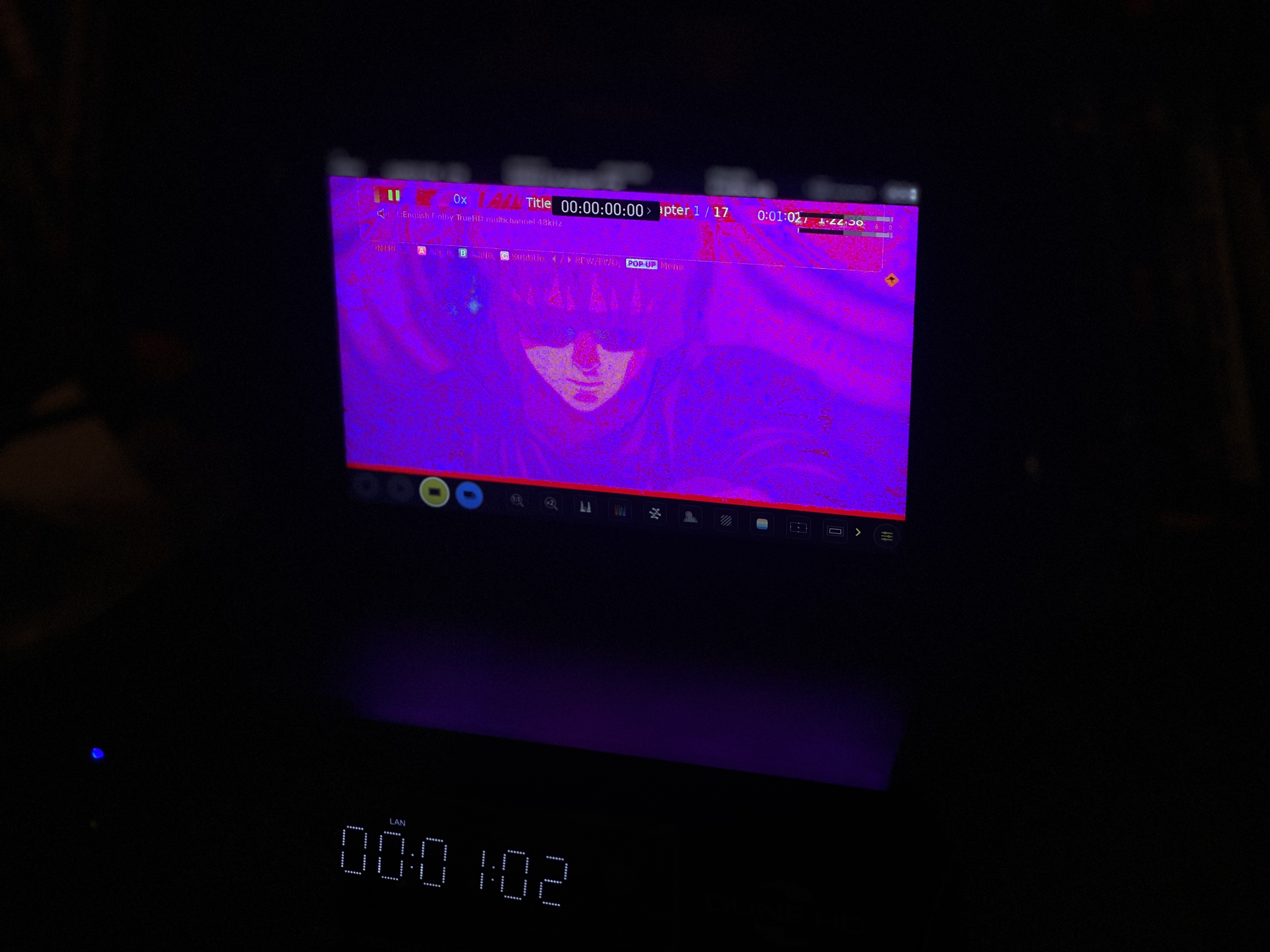

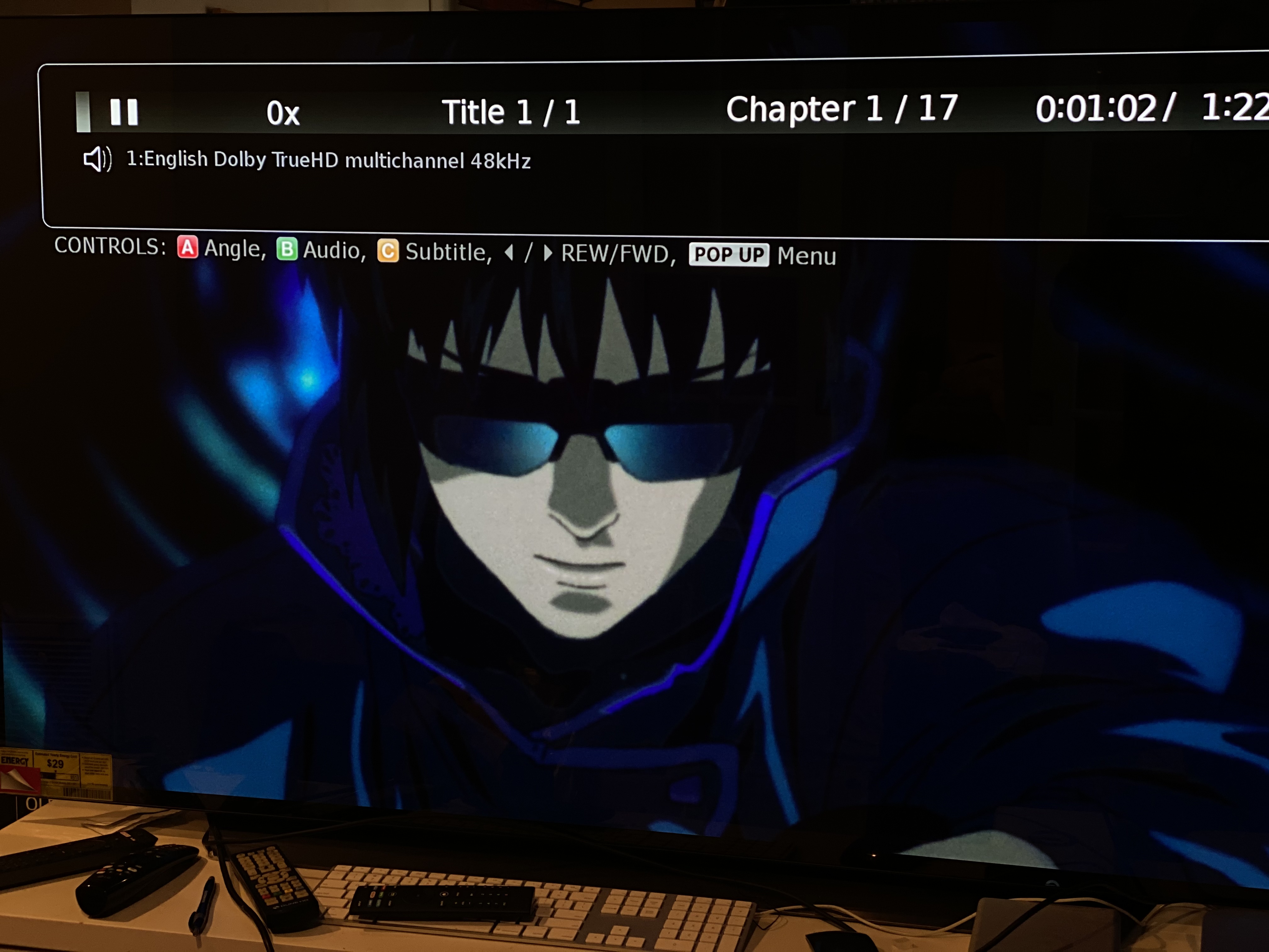

@Manixx2020beyound finally got his hands on the new Dune player, time to do some comparisons :)
Unfortunately, the Dune does like the Shield and ignores the EL but there is no red push and the colors seem to be accurate. Even though it looks like the dune is ignoring the EL, there is still an improvement compared to the base layer. We have to compare it with a P8 rip.
Of course, this is an extreme case and it wouldn't be so different if the studios encoded the base layer properly in the first place but the improvement that the FEL brings here is phenomenal, imaging when we'll have true 12bit TV.
DV captured in PQ with the latest Atomos Shogun.

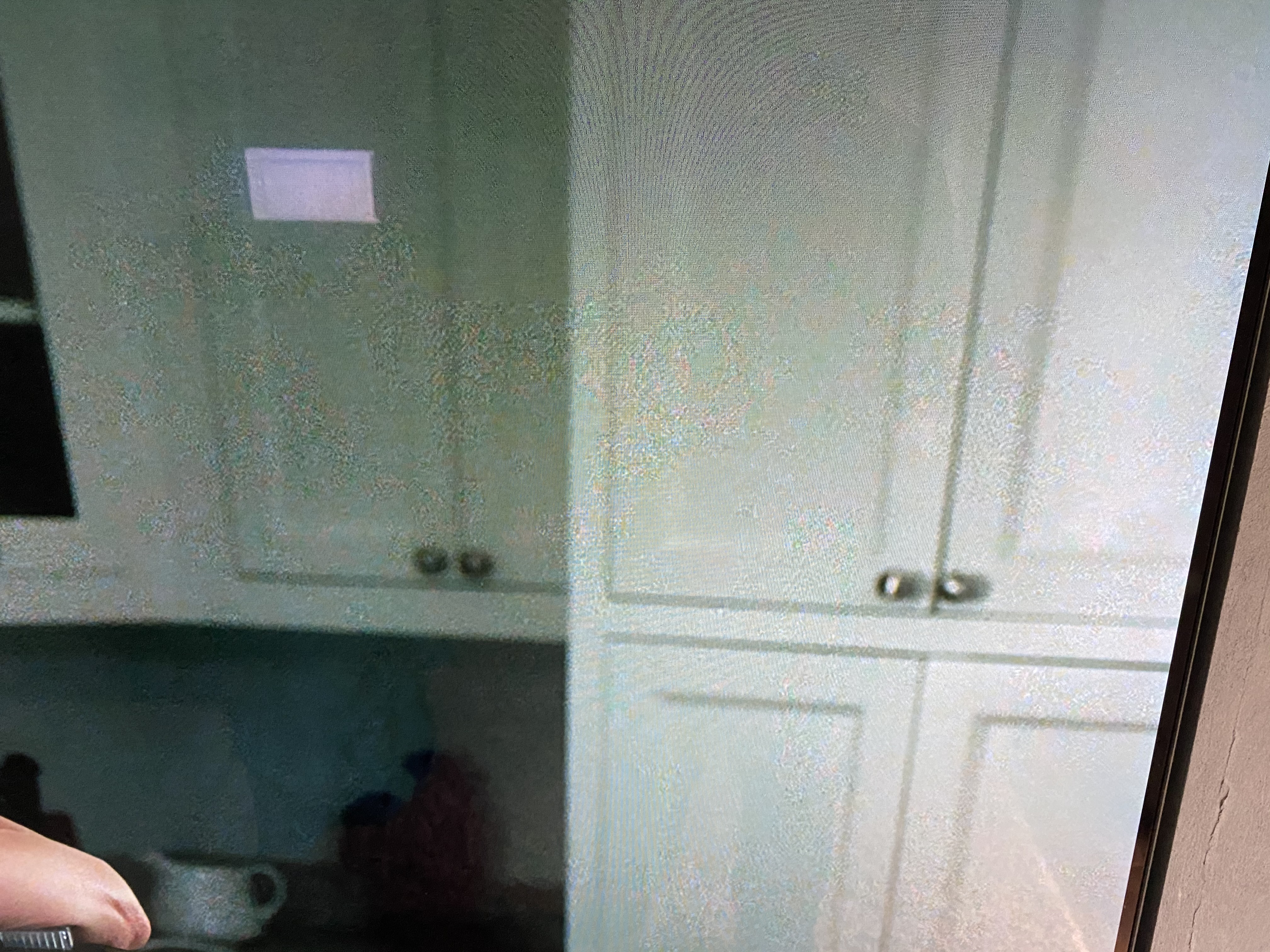

Thinking of going for an Oppo 203 for DV - does anyone know if the issue of the green garbled screen after playing a DV m2ts has been solved?

untouched PQ images from the Shogun:
https://drive.google.com/file/d/16HOh1R ... sp=sharing,
https://drive.google.com/file/d/17-XW-E ... sp=sharing
https://drive.google.com/file/d/18qNpoU ... sp=sharing
interesting, the size difference of the lossless png...
I uploaded samples in different container and profile of that scene:
https://drive.google.com/file/d/11fzJYb ... sp=sharing,
https://drive.google.com/file/d/1LtE3ju ... sp=sharing,
https://drive.google.com/file/d/1jrDF5j ... sp=sharing,
https://drive.google.com/file/d/1mYy3WO ... sp=sharing,
https://drive.google.com/file/d/1nD7-MH ... sp=sharing,
https://drive.google.com/file/d/1on9KfI ... sp=sharing,
https://drive.google.com/file/d/1xJkiL0 ... sp=sharing
Dune tv led is different/ compare to their version of LLDV but there is know way to really prove that
Testing ghost in a shell
iSO which has a 8gg FEl
Curious on a more morden revision
So would the diff here be even more obvious?
Being that the fel is 8gigs ?
Also there seems to be more grain on different settings on the dune so more test is needed diff Fels
