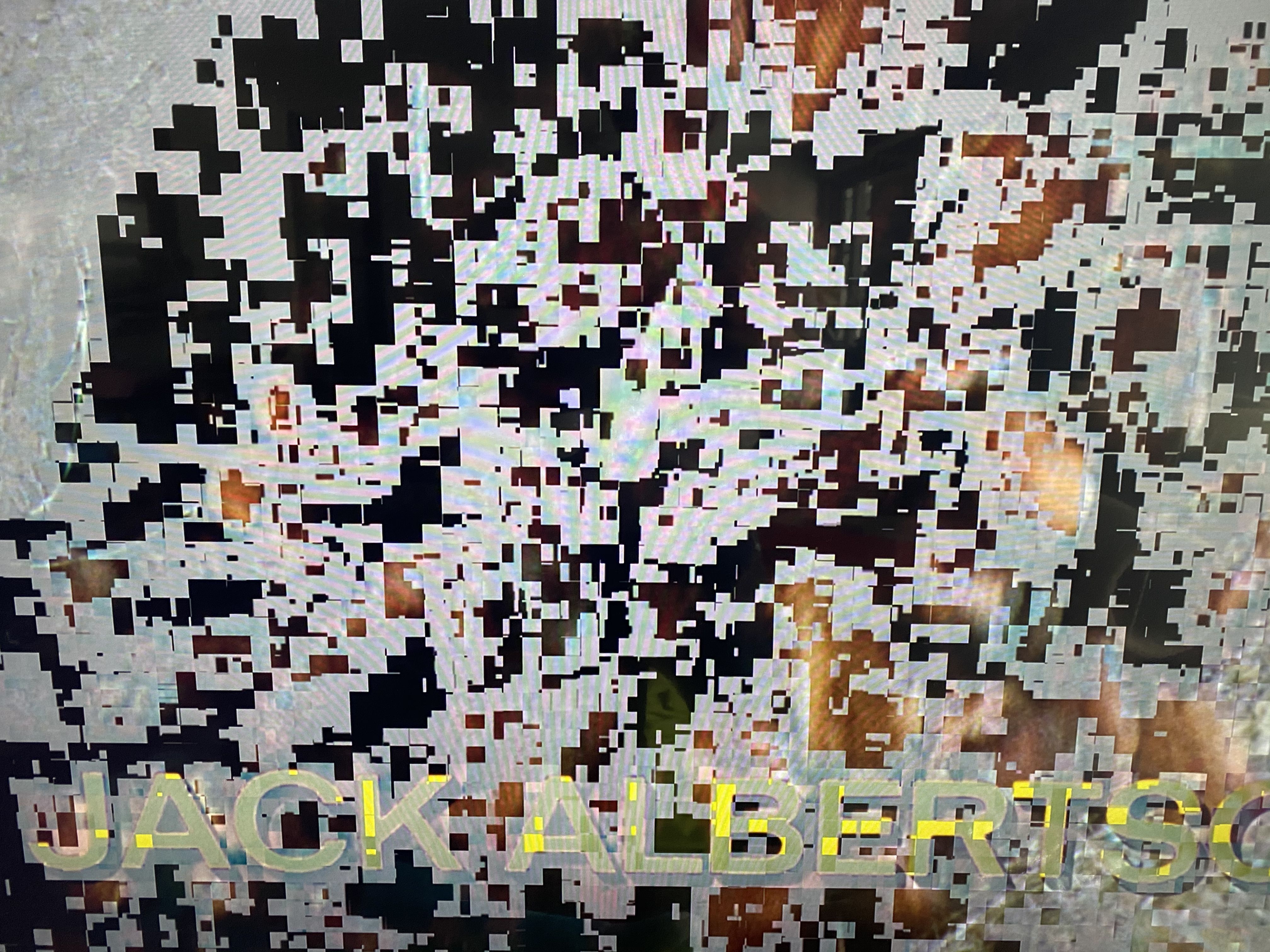

I captured an example of what I am seeing in terms of artifacts - in the attachment posted here.
I am now wondering if the TV CPU can't cope with the decoding load, or something like that? Since the issue happens with two different players. But again, I'm really just guessing.
I will try putting the file on a USB stick next, to completely rule out network issues.

I did the USB test. With the same movie that gives the grey blocks over the network, loaded onto a high-speed USB stick plugged into the TV, I get a very jerky 1-2fps playback with Kodi reading from the local USB filesystem. Not watchable.
So... is my conclusion that the TV (a Sony Bravia) isn't up to the task?
In which case, I have to transcode to some lesser resolution or higher compression rate or something?
Thanks once again for the advice.

I don't have any experience with Sony Bravia TVs, but it is possible that the TV's CPU is having trouble decoding a blu-ray rip I suppose. Do you have any streaming boxes you could try? An Apple TV, a Roku, a Fire stick, Chromecast, etc.?
Handbrake is a good place to start for the transcoding route: https://handbrake.fr Making a h.264 file from a ripped blu-ray can take a little while depending on the hardware you have. For testing, if you have something with hardware encoding (like a modern Nvidia GPU, an Intel CPU with Quick Sync Video, or a Mac that isn't too old), you can dramatically speed up the process.

OK, that was a great suggestion. The affected MKVs play just fine on VLC on my ATV4. I don't even need to convert them to any other format, or re-encode. THANKS for the idea!
Conclusion (such as it is) - the Sony Bravia lacks the capabilities to play high-bitrate MKV files. Is that an issue with the video player implementations on that Android platform, or a limitation of the TV's processing capabilities? Who knows.
The MKV files themselves are fine, though.
