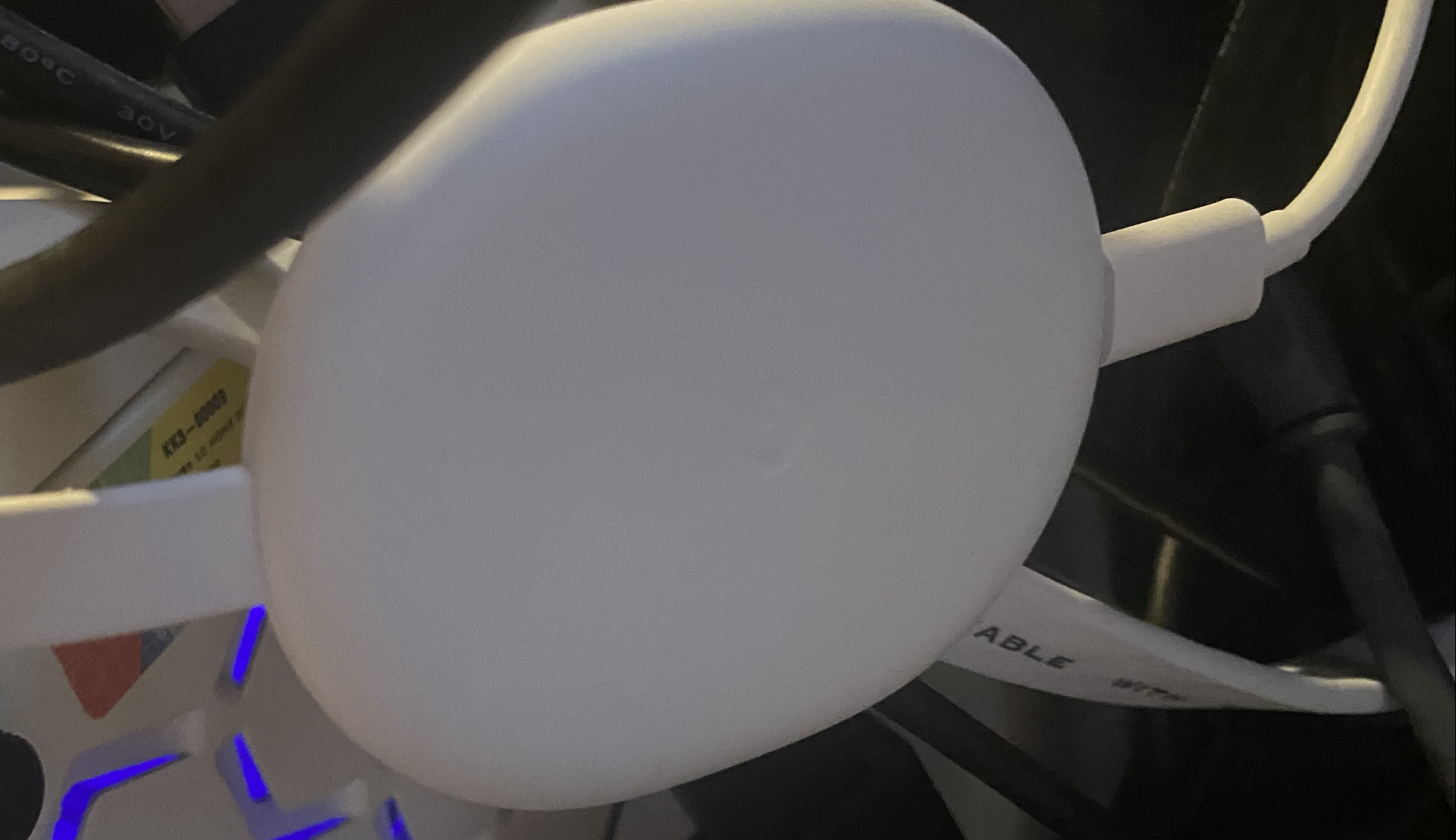

5 seconds,
Yes the test was the new version, colors were saturated before the update
Plus u need plex pass on this device to play hdr, plus it’s LLDV only
The device does drop frames sometimes not very noticeable

The device does drop frames sometimes not very noticeable 1BBBF90D-893E-4EE6-ADEF-9195E296DA1B.jpeg
Thanks for your answer @Manixx2020beyound.
I've got Plex beta without Plexpass and it renders every HDR, I believe that the Plexpass is only needed for HDR to SDR Tone Mapping.
Since the february update I can't see any frame drop in any playback, with high bandwith files.
How do you guess the new Chromecast with Google TV is LLDV only? is very difficult to obtain DV info about this device...
And, can you explain what are the consequences of this LLDV only processing?
The image quality I observe is really good, and I think I've got a good eye for this, but I can't compare with nothing.
Thanks in advance :)

He has the HDfury Vertex which can tell if it's lldv or tv-led DV.
https://www.youtube.com/watch?v=e_a77zJTrO4
