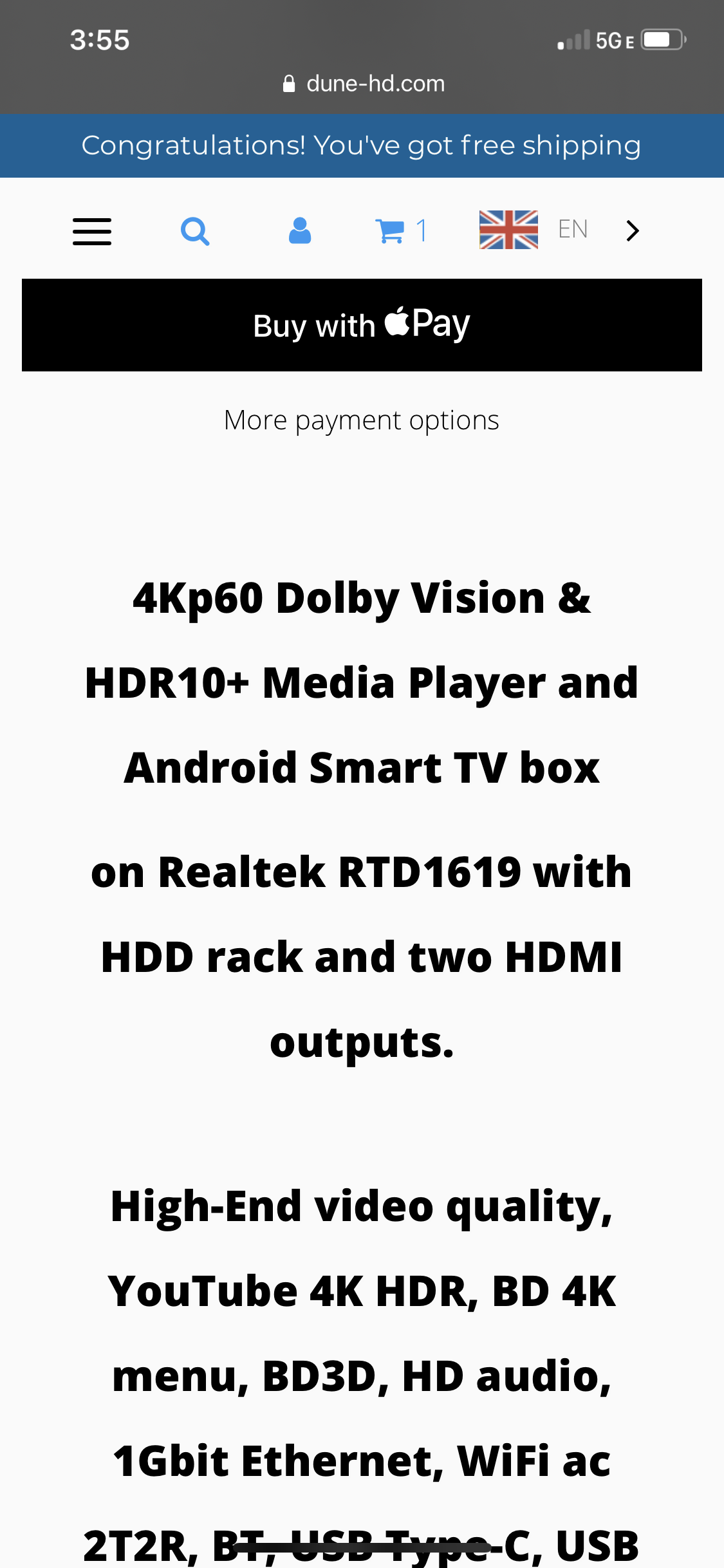

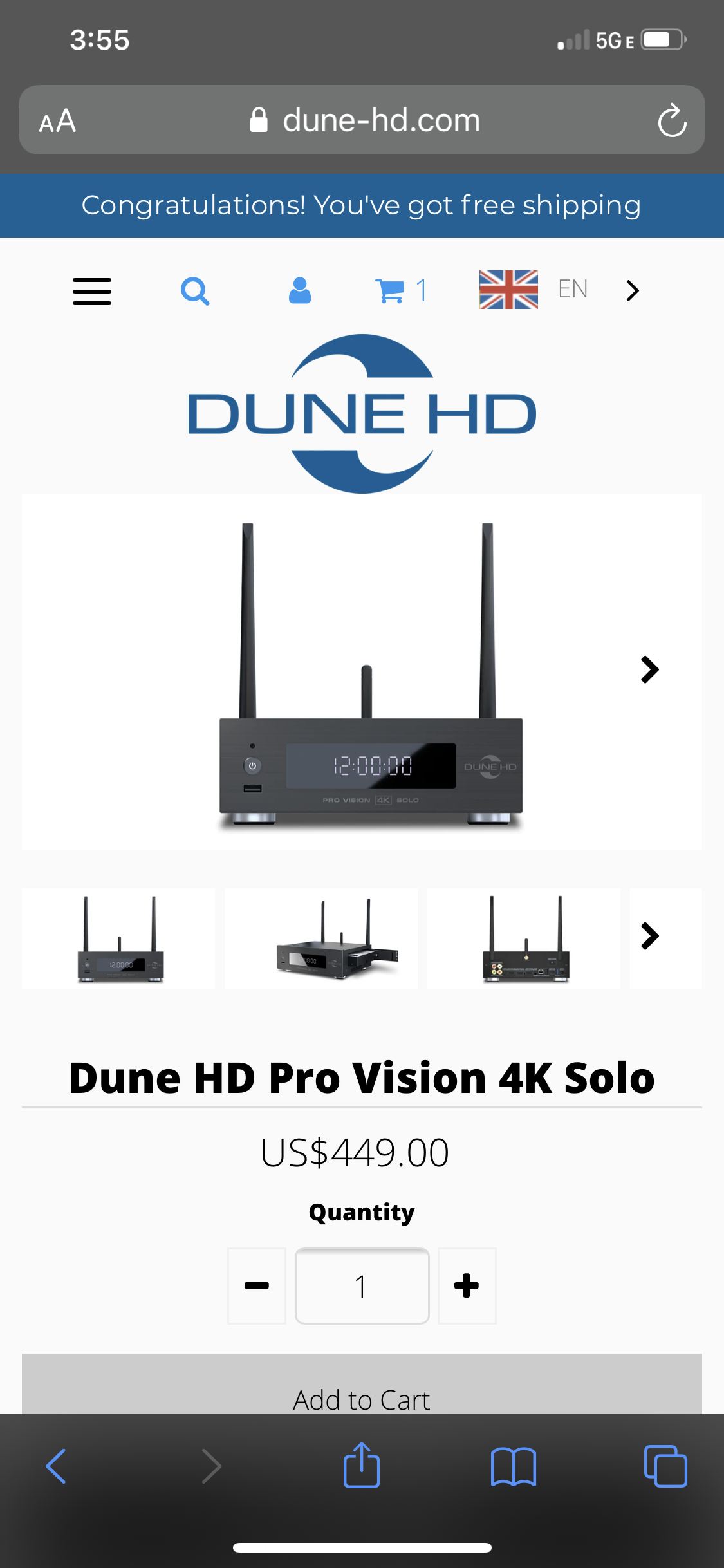

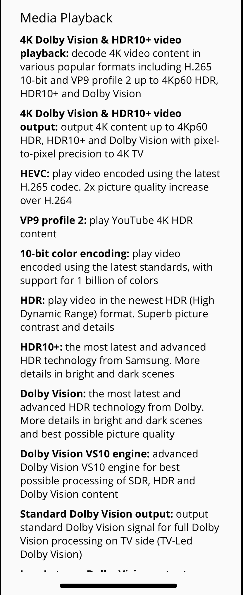

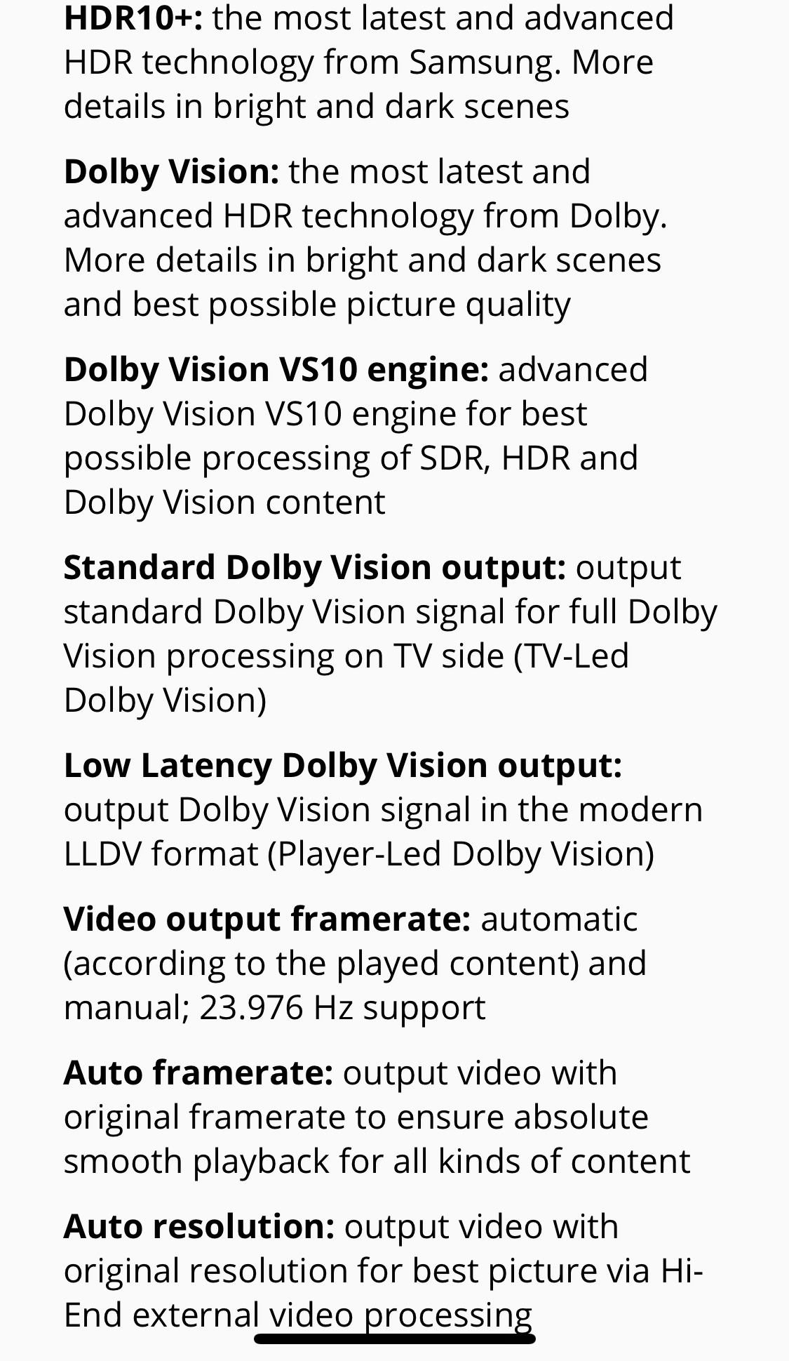

I have the the 4kpro it supports full menu iso folder playback I assume it’s the same as well. The spec’s are there.
- CB240770-6C3C-4229-A274-AC27705A5908.jpeg (781.63 KiB) Viewed 44106 times
- BCCC81B2-5F63-4148-A5D3-60C2DAD5E032.jpeg (647.18 KiB) Viewed 44106 times

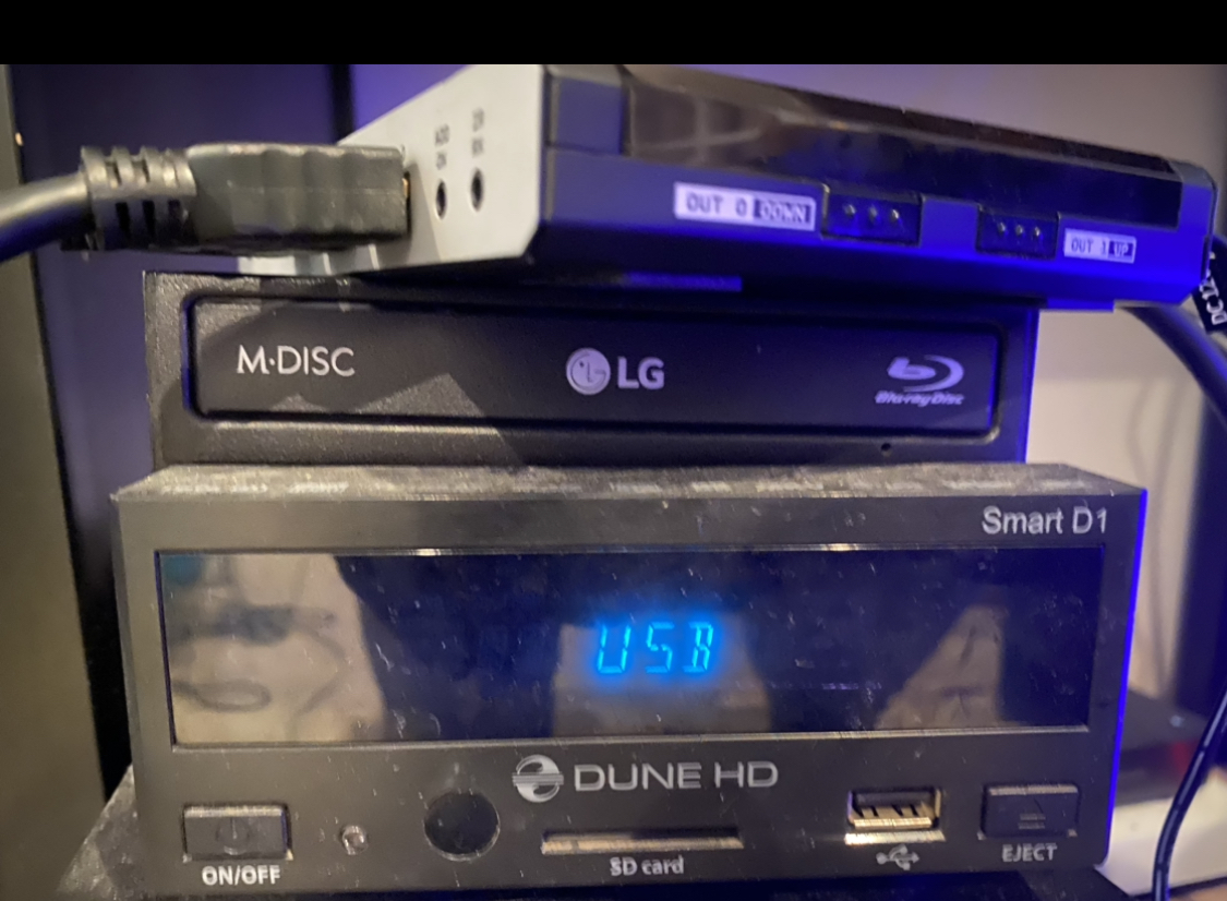

- I still use this one which is like 8 years old
- CBCE6681-A3B2-4AD3-9695-DA81F1865516.jpeg (639.83 KiB) Viewed 44106 times
