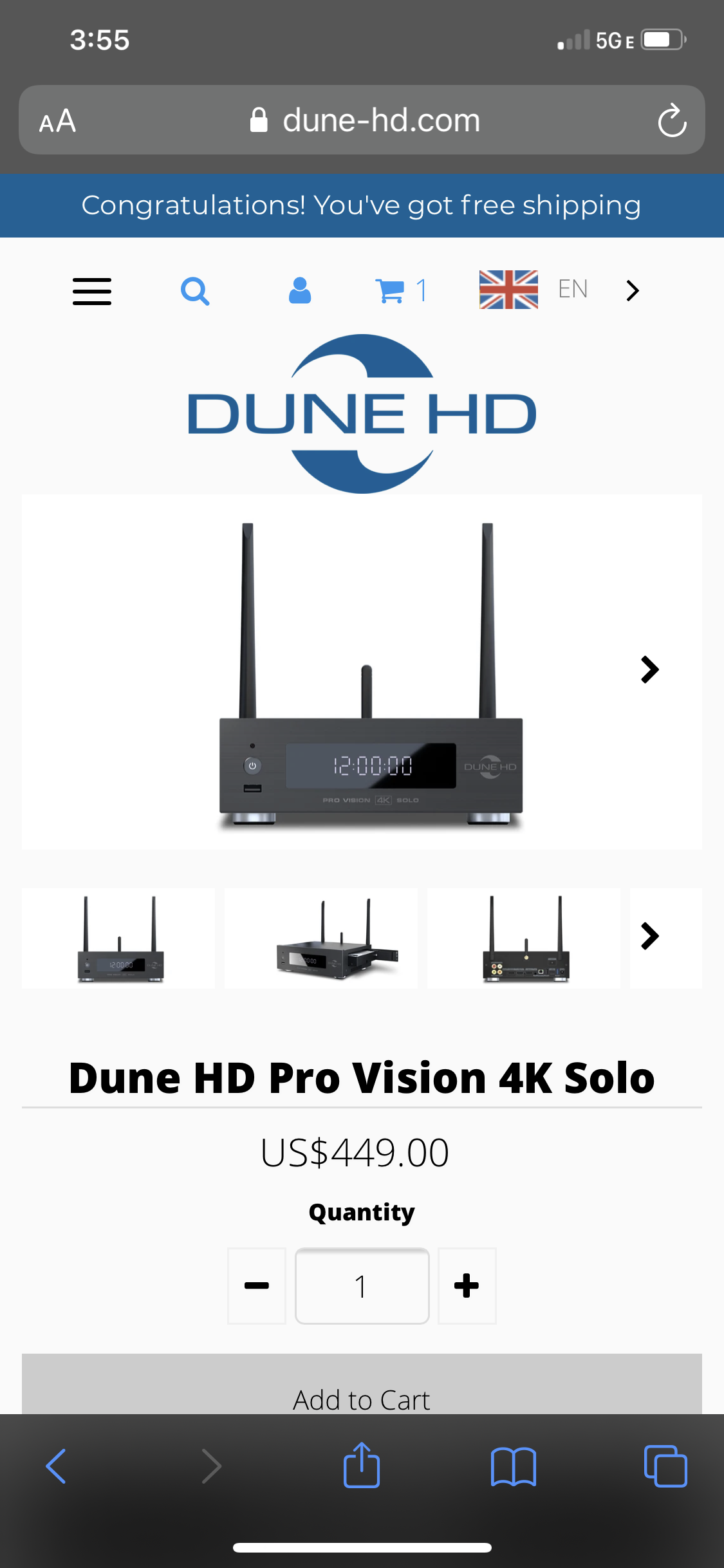

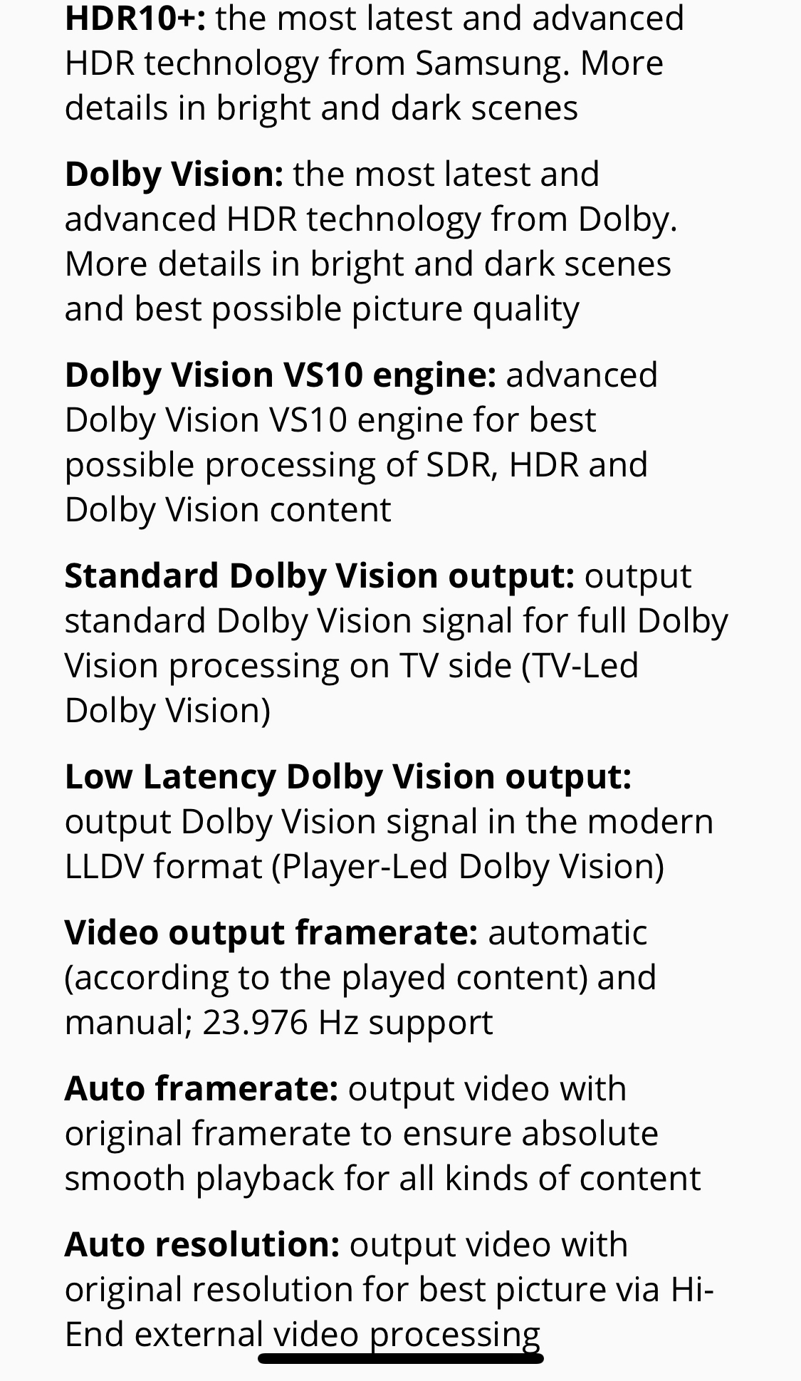

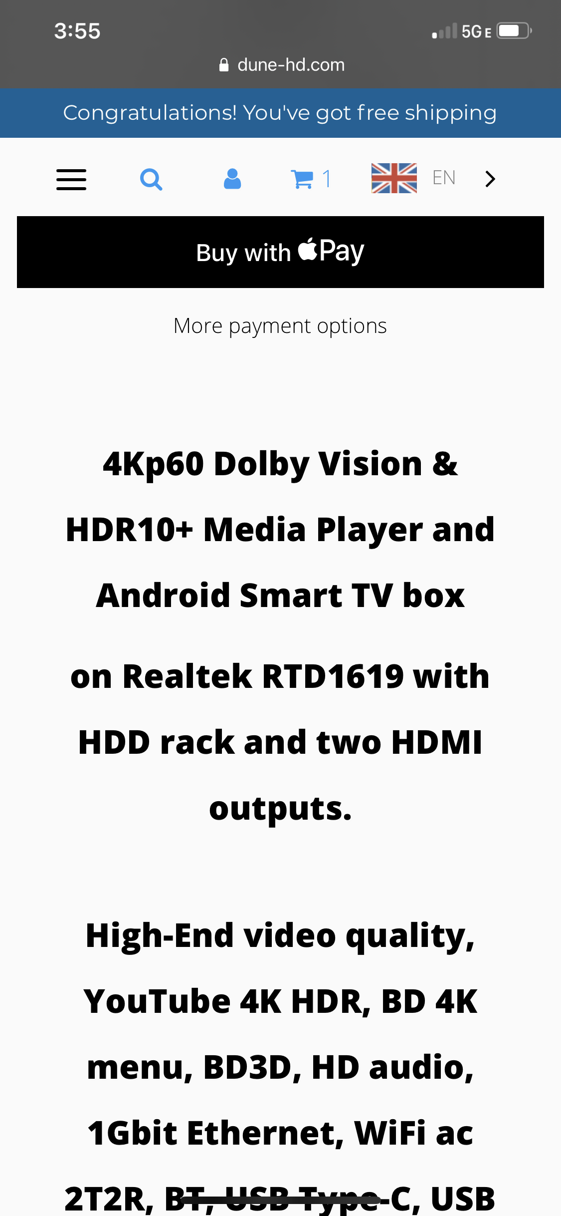

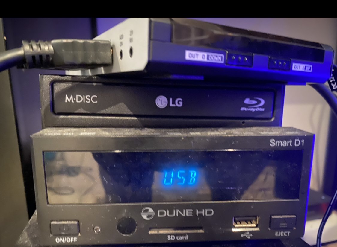

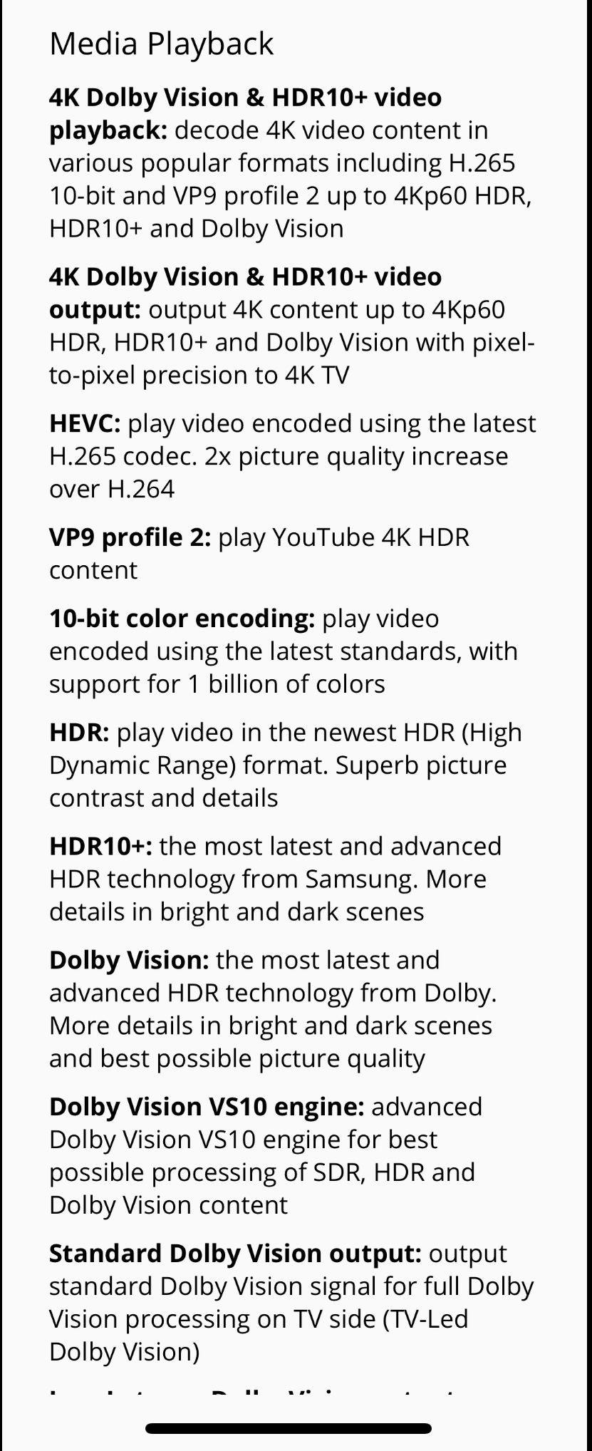

I’ll be testing this next week,
I still have a few of there high end Blu-ray/iso player they were solid network players. TvLed /player led iso/Blu-ray & 4k uhd doblyvision & hdr10 plus.
https://www.dune-hd.com/collections/fro ... ifications
With this device u won’t have to load your bdmv in folders .
Or fiddle with fast forward or fast reverse.
