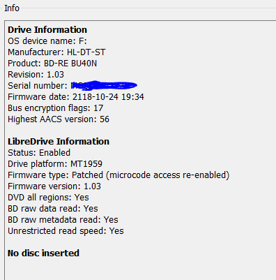

I followed the instruction here to downgrade my BU40N from encrypted firmware 1.04 to 1.03

The process went successfully, however I as put a 4K disk, the drive attempts several read attempts, but then I get a message that there is no disk.
Any suggestions please?
Bob
Did it read 4K discs before the flash the BU40N should.
How is the drive connected?

Thanks for quick response.
I am afraid I did not test prior to flash.
Its a slim drive in a Vantec USB3.0 and connected via USB to laptop.
