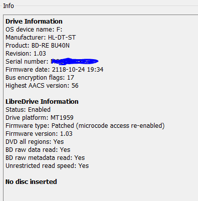

#601 Post by bobby121418 » Wed Jan 27, 2021 11:35 am
I followed the instruction here to downgrade my BU40N from encrypted firmware 1.04 to 1.03
How To Flash Videos and commands:
New Updated guide for all Drives and firmware including encrypted firmware: https://www.youtube.com/watch?v=jyQV1aPlbow
1. Open cmd as admin
2. Navigate to makemkvs install directory by default on 64 bit systems it is here: cd "C:\Program Files (x86)\MakeMKV"
3. If you have a listed encrypted firmware you must use this command: makemkvcon64.exe f --all-yes -d “ your drive letter here Example: D”: rawflash enc -i “path to your firmware Example: C:\Users\Billy\Downloads\Downgrade-Enabled-Firmware\Auto-Flash\LG-Desktop-NS60-sleep-fix\WH16NS60-1.02-MK.bin”
4. If you have unencrypted firmware use this command: makemkvcon64.exe f --all-yes -d “ your drive letter here Example: D”: rawflash -i “path to your firmware Example: C:\Users\Billy\Downloads\Downgrade-Enabled-Firmware\Auto-Flash\LG-Desktop-NS60-sleep-fix\WH16NS60-1.02-MK.bin”
5. Remove my examples and quotes ”” when you run the commands
https://www.youtube.com/watch?v=Yfpf6HoMMis only for unencrypted firmware
https://www.youtube.com/watch?v=eXgybNfHhcg - Obsolete but can be useful for recovery
The process went successfully, however I as put a 4K disk, the drive attempts several read attempts, but then I get a message that there is no disk.
Any suggestions please?
Bob

bobby121418 wrote: Wed Jan 27, 2021 11:35 am
Bob
Did it read 4K discs before the flash the BU40N should.
How is the drive connected?

Billycar11 wrote: Wed Jan 27, 2021 11:45 am
Bob
Thanks for quick response.
I am afraid I did not test prior to flash.
Its a slim drive in a Vantec USB3.0 and connected via USB to laptop.
Posts: 5829
Re: Ultimate UHD Drives Flashing Guide Updated 2021
#604 Post by Billycar11 » Wed Jan 27, 2021 12:32 pm
Use both cables on separate usb circuits
And if still no open it up and make sure the slim sata connection is fully seated

Billycar11 wrote: Wed Jan 27, 2021 12:32 pm Use both cables on separate usb circuits
Just tried that as well as cleaning the disk several times, but still the result is the same. I am assuming the firmware change is not the issue here. Could it be the 4K disk is bad?

bobby121418 wrote: Wed Jan 27, 2021 1:33 pm
Could be try regular Blu-ray and a dvd if possible that has a different laser
No this would not be related to firmware I don't think

Billycar11 wrote: Wed Jan 27, 2021 1:35 pm
Just tried a Blu ray disk and works fine!
Any other suggestions please?
Could it be an issue with the disk or the drive?

bobby121418 wrote: Wed Jan 27, 2021 5:10 pm
Ok, thus is weird, now I tried to open the disk just in Windows with MakeMKV off and now it seems to read the disk. Entering MakeMKV it is also reading the disk although I am seeing some Scsi errors with Medium Error messages.

Post the full log here

Billycar11 wrote: Wed Jan 27, 2021 10:33 pm Post the full log here
How?

bobby121418 wrote: Wed Jan 27, 2021 10:38 pm
How?
Copy paste from the makemkv output is the easiest way
