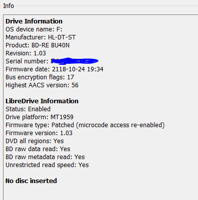

I followed the instruction here to downgrade my BU40N from encrypted firmware 1.04 to 1.03
How To Flash Videos and commands:
New Updated guide for all Drives and firmware including encrypted firmware: https://www.youtube.com/watch?v=jyQV1aPlbow
1. Open cmd as admin
2. Navigate to makemkvs install directory by default on 64 bit systems it is here: cd "C:\Program Files (x86)\MakeMKV"
3. If you have a listed encrypted firmware you must use this command: makemkvcon64.exe f --all-yes -d “ your drive letter here Example: D”: rawflash enc -i “path to your firmware Example: C:\Users\Billy\Downloads\Downgrade-Enabled-Firmware\Auto-Flash\LG-Desktop-NS60-sleep-fix\WH16NS60-1.02-MK.bin”
4. If you have unencrypted firmware use this command: makemkvcon64.exe f --all-yes -d “ your drive letter here Example: D”: rawflash -i “path to your firmware Example: C:\Users\Billy\Downloads\Downgrade-Enabled-Firmware\Auto-Flash\LG-Desktop-NS60-sleep-fix\WH16NS60-1.02-MK.bin”
5. Remove my examples and quotes ”” when you run the commands
https://www.youtube.com/watch?v=Yfpf6HoMMis only for unencrypted firmware
https://www.youtube.com/watch?v=eXgybNfHhcg - Obsolete but can be useful for recovery
The process went successfully, however I as put a 4K disk, the drive attempts several read attempts, but then I get a message that there is no disk.
Any suggestions please?
Bob

Did it read 4K discs before the flash the BU40N should.
How is the drive connected?

Thanks for quick response.
I am afraid I did not test prior to flash.
Its a slim drive in a Vantec USB3.0 and connected via USB to laptop.

Use both cables on separate usb circuits
And if still no open it up and make sure the slim sata connection is fully seated

Just tried that as well as cleaning the disk several times, but still the result is the same. I am assuming the firmware change is not the issue here. Could it be the 4K disk is bad?

Could be try regular Blu-ray and a dvd if possible that has a different laser
No this would not be related to firmware I don't think

Just tried a Blu ray disk and works fine!
Any other suggestions please?
Could it be an issue with the disk or the drive?

Ok, thus is weird, now I tried to open the disk just in Windows with MakeMKV off and now it seems to read the disk. Entering MakeMKV it is also reading the disk although I am seeing some Scsi errors with Medium Error messages.
