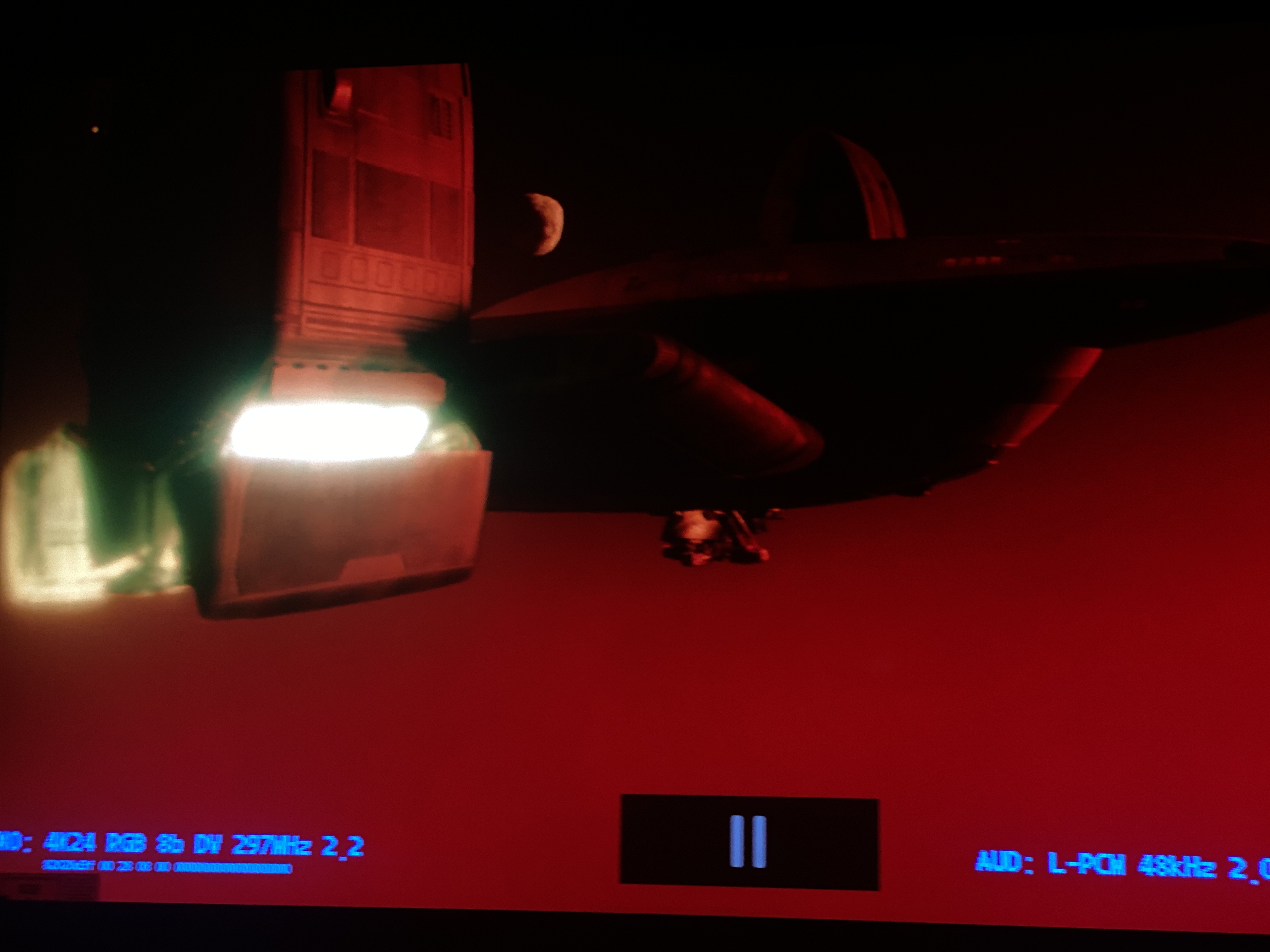

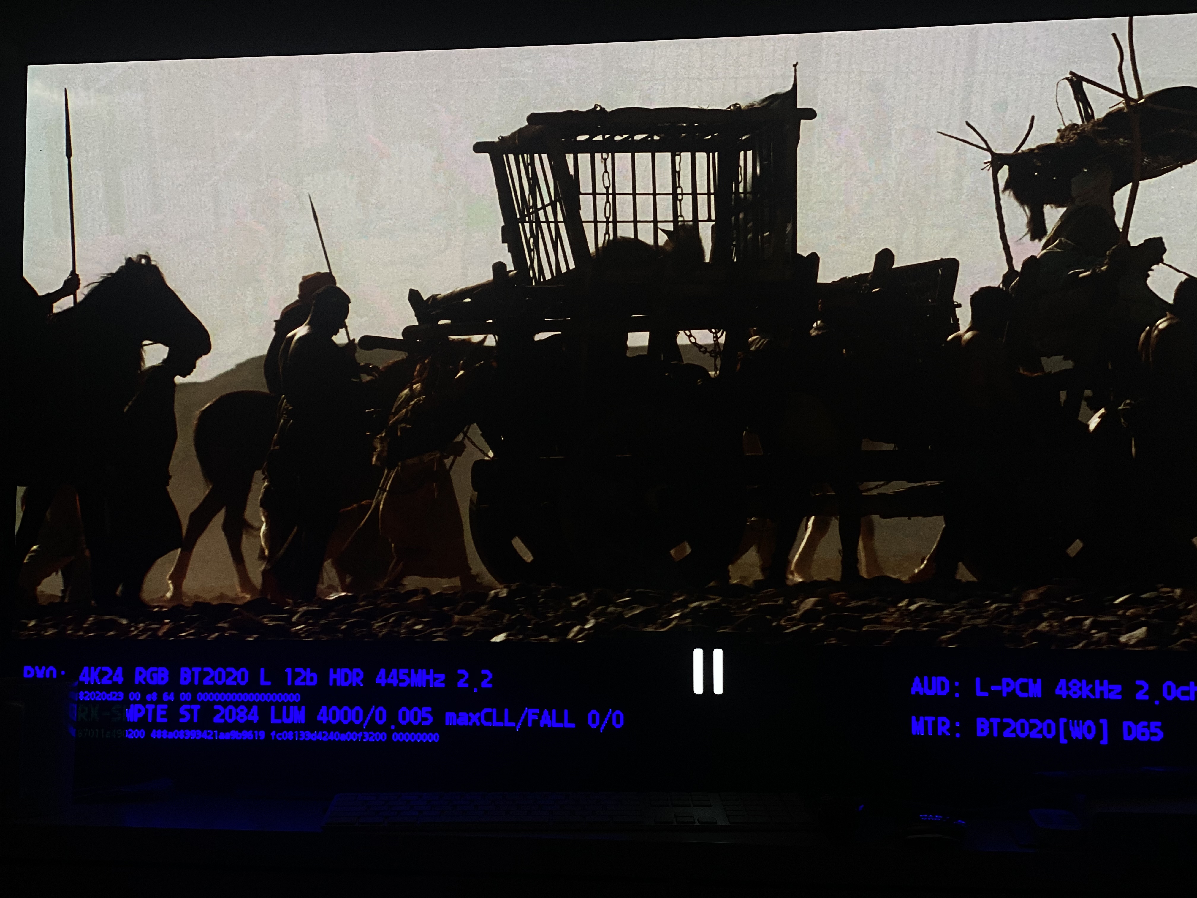

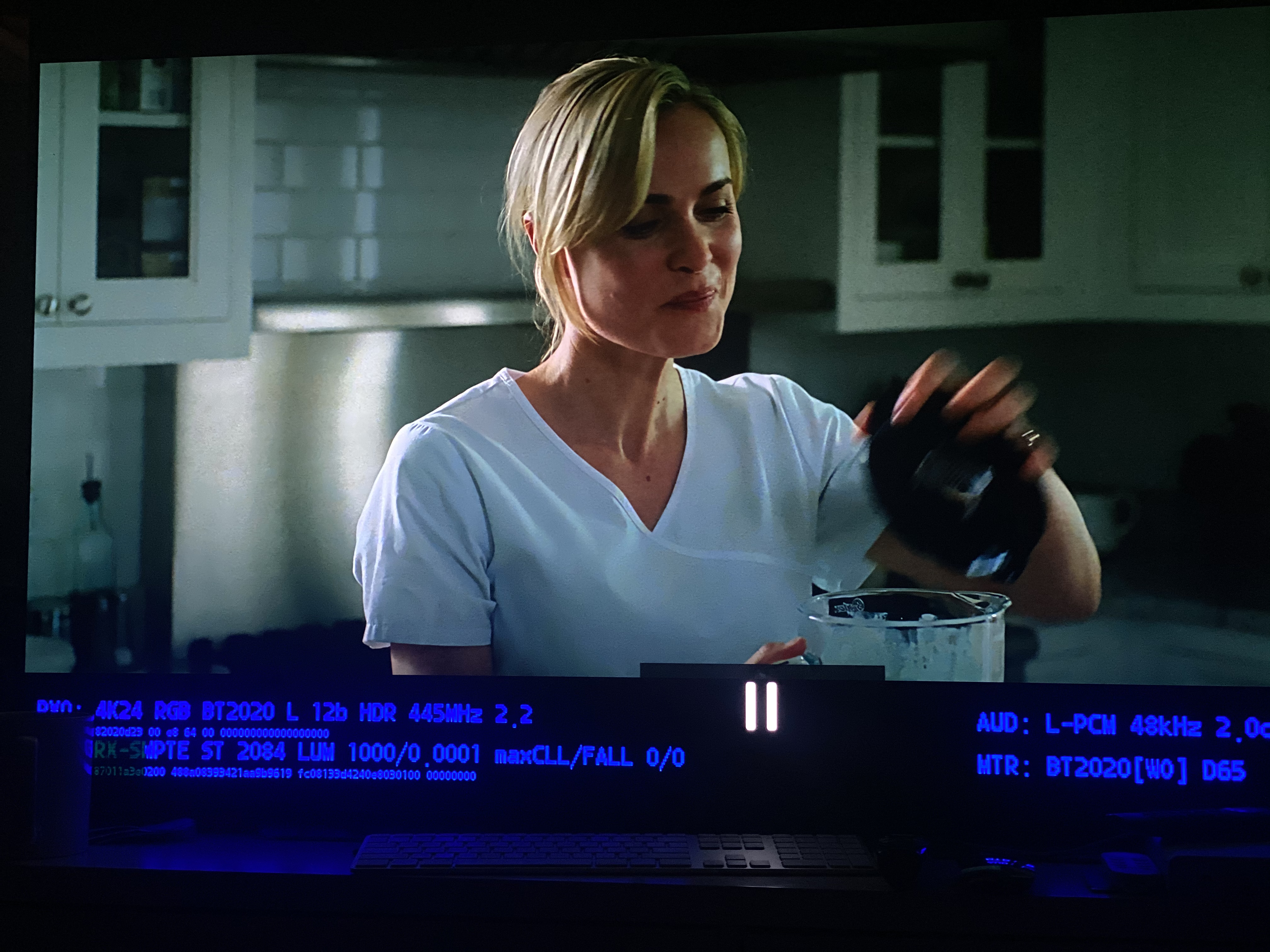

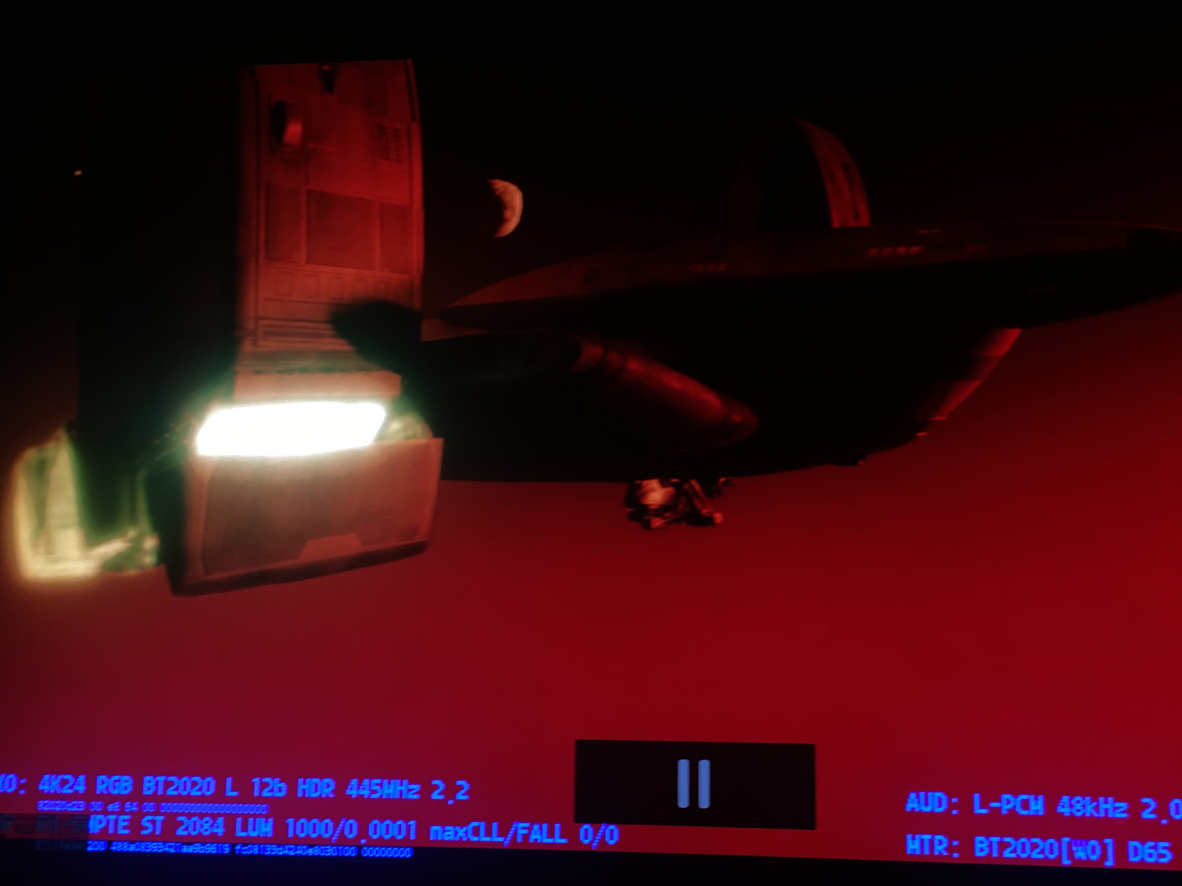

Here is another up date I also have 2 Philips Blu-ray 4K players 1 doblyvision 1 is not.
And with doblyvision on LLDV for a none LLDV player plays the FEL in hdr10 bl over bl layer what the hell. How is that possible?
It’s also utilizing the Rpu as welll.
Sample file/reset9999 & Lexyz gladiator fel sample displays fel & Rpu over base layer in hdr10. On none LLDV doblyvision player.
Will do a capture for comparison.
So u guys can add Philips 4K uhd doblyvision player to the list plays mp4 rips dl & muxed sl dv.
But no LLDV ability
As u can see from the photo fel is being played Along with the hdr10 when in LLDV mode. Player can’t play LLDV
So in that case who’s decoding the fel the tv or the uhd player?
Hdr10 using the fel Phillips 4K uhd dv player
Hdr10 using the fel
Hdr10 using the fel
