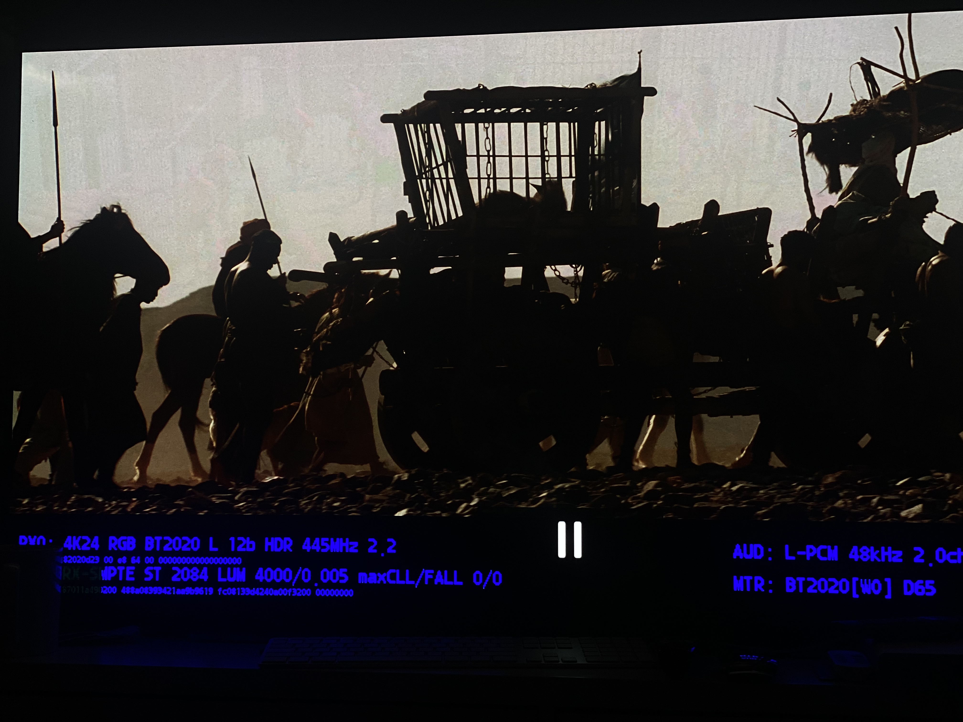

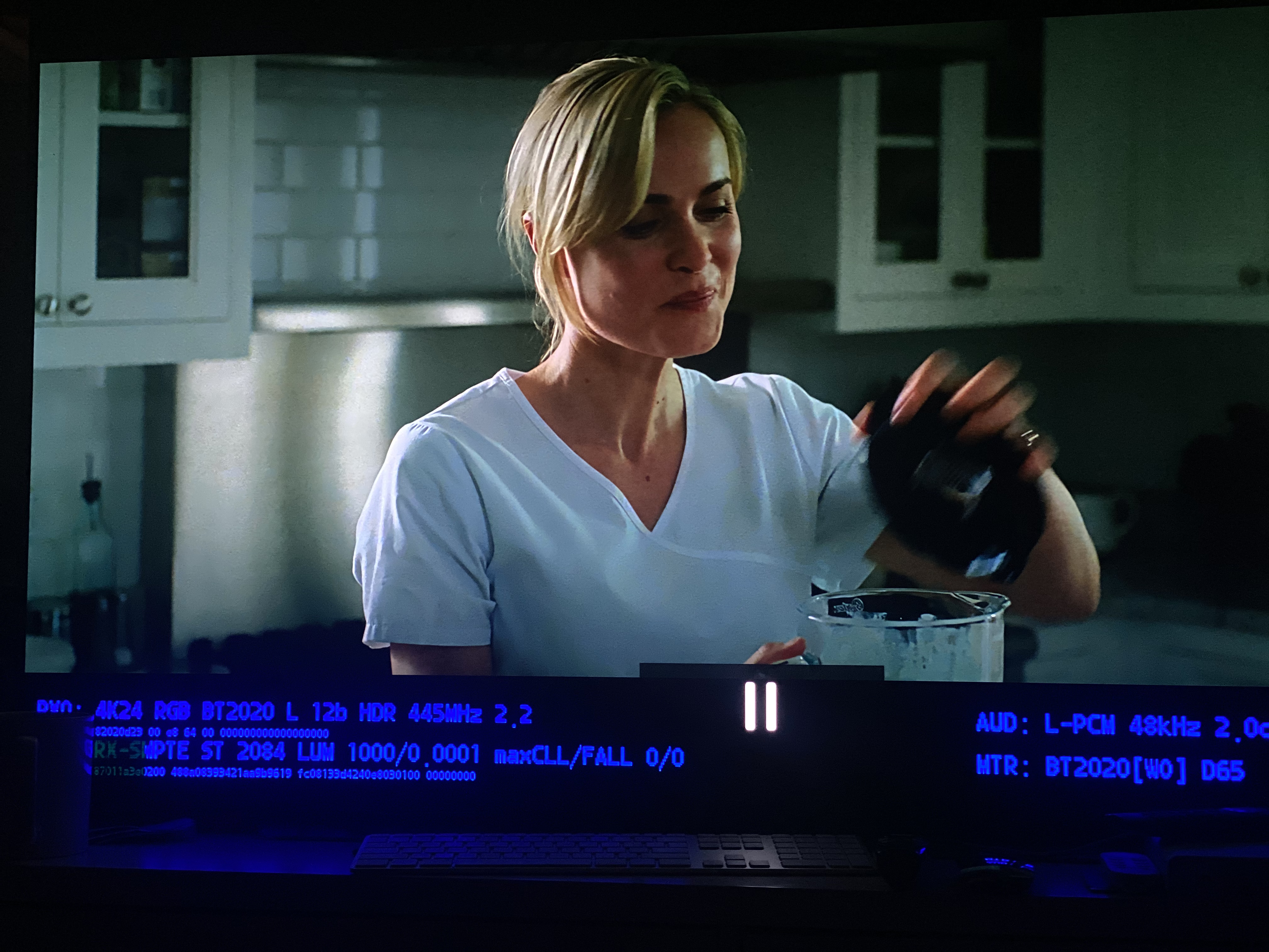

#4200 Post by agneva » Wed Jan 20, 2021 3:30 pm
yes, when switching from HDR10 to DV, my LG gets from YCbCr 12bit to RGB 8bit (LG UBK90 <-> LG OLED CX9LA), first time I´ve seen this I wondered.
the method Dolby Vision (DV) uses to transport the signal over HDMI is referred to as “RGB Tunneling”. The 12-bit ICtCp DV signal + Metadata is encapsulated inside the regular RGB 8-bit video signal. The DV “tunneling” carries 12-bit YCbCr 4:2:2 data in an RGB 4:4:4 8-bit transport. This is possible because both signal formats have the same 8.9 Gbps data rate requirements.
