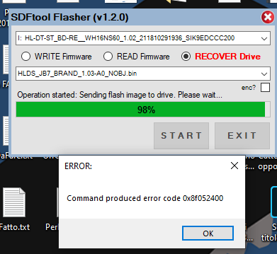

An error returns:
Command produced error code 0x8f052400
- Posts: 6453
Re: LG BH16NS40 bricked?
Flash WH16NS60 1.00 with the lg or Asus tool and try the recovery option one more thing after that you will have to do it the dos flash way
