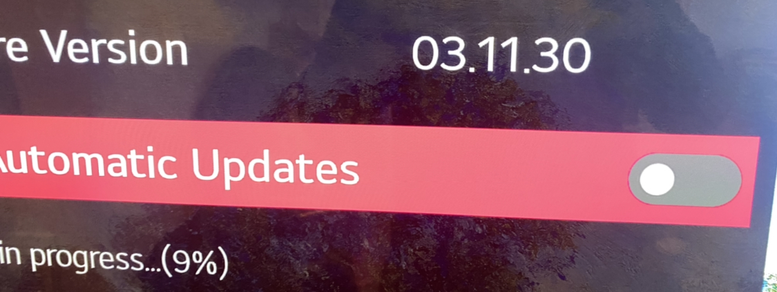

Manixx2020beyound wrote: Sun Jan 17, 2021 6:18 pm 5ED00217-56EF-4440-B746-9591A31684D2.jpeg
CX plays fel fine in usb mp4 dl dv.
Firmware#
Tlc 6 series plays dv fel as well usb.
CX did not play DV (DTDL) mp4 prior to lastest firmware.

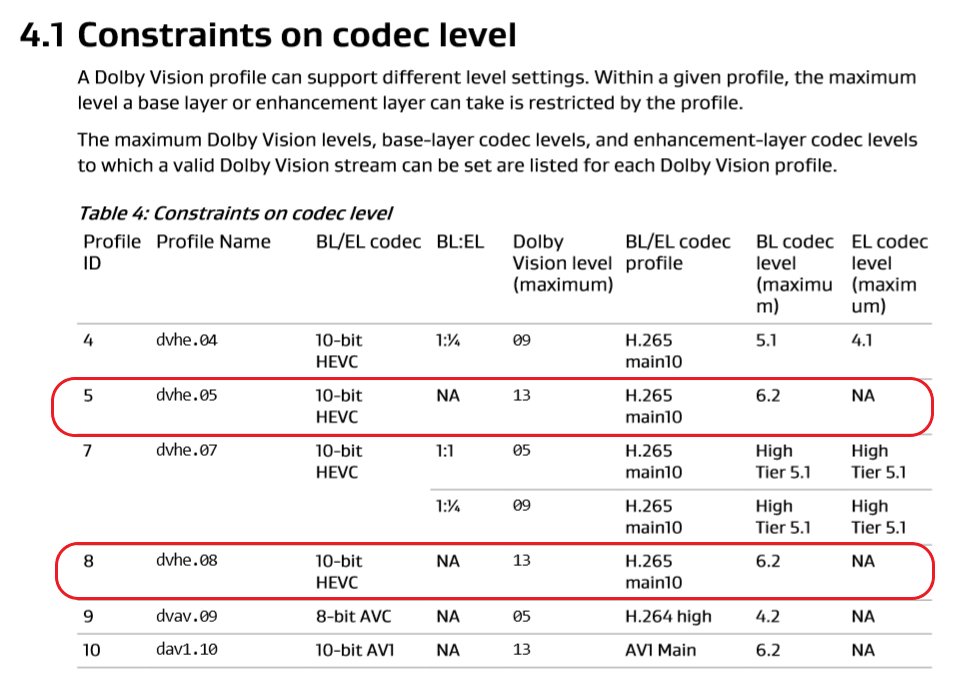

#4172 Post by agneva » Mon Jan 18, 2021 8:38 am
DaMacFunkin wrote: Mon Jan 18, 2021 7:52 am The CX can do TV led Dolby Vision so it has 2 decoders, so no discussion.
What is more likely is the second decoder is crippled in firmware for media file playback.
Have you tried built in Plex app from NAS?
You confuse metadata decoder with 2. full-fledged HEVC decoder :!: (which restores the original from FEL with 12bit)
For Netflix Dolby Vision is only DV Profil 5 / 8 necessary, without 2. HEVC stream / FEL:
DV layers Matrix explained.jpg (89.39 KiB) Viewed 29359 times

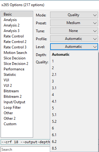

#4177 Post by agneva » Mon Jan 18, 2021 12:30 pm
that's not the point here, but it doesn't matter.
Resolution : [3840×2160]
Video Bitrate : [15,3 MB/s]
FPS: : [23,976]
Audio Language : [German (DTS-HD MA 5.1/EAC3 5.1) / English (EAC3 5.1)]
Subtitle Lang. : [German (Complete/Complete SDH) / English (Complete SDH)]
Encoding : [StaxRip -> HEVC x265 Main10 High@L5.1 CRF16 (UHD Ready)]
Colorgrading : [DaVinci Resolve Studio 16 -> BT2020 HDR10 @1000 Nits]
Source : [Mandalorian.S02E01.Chapter.09.REPACK.2160p.WEB-DL.DDP5.1.HDR.x265-RONIN]
x265 is always reencoded, no professional provider encodes with x265 :!:
