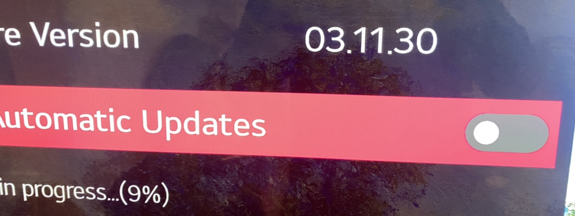

Manixx2020beyound wrote: Sun Jan 17, 2021 6:18 pm 5ED00217-56EF-4440-B746-9591A31684D2.jpeg
CX plays fel fine in usb mp4 dl dv.
Firmware#
Tlc 6 series plays dv fel as well usb.
CX did not play DV (DTDL) mp4 prior to lastest firmware.

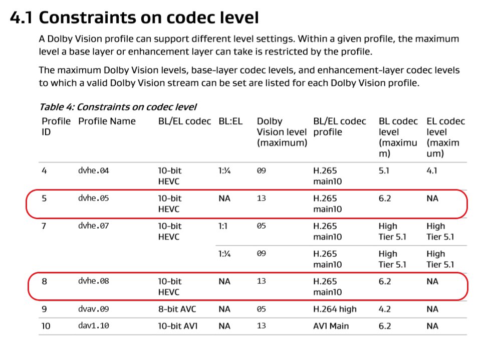

You confuse metadata decoder with 2. full-fledged HEVC decoder :!: (which restores the original from FEL with 12bit)
For Netflix Dolby Vision is only DV Profil 5 / 8 necessary, without 2. HEVC stream / FEL:
DV layers Matrix explained.jpg (89.39 KiB) Viewed 29594 times

Being able to do TV-led DV has nothing to do with whether it has 2 HEVC decoders or not. If that's the case, then every DV capable TV that's not a Sony should be able to play DL FEL mp4s. The decoding step (1 HEVC or 2 HEVC decoders needed to reconstruct the original picture) occurs prior to the tone mapping step (TV-led or player-led).

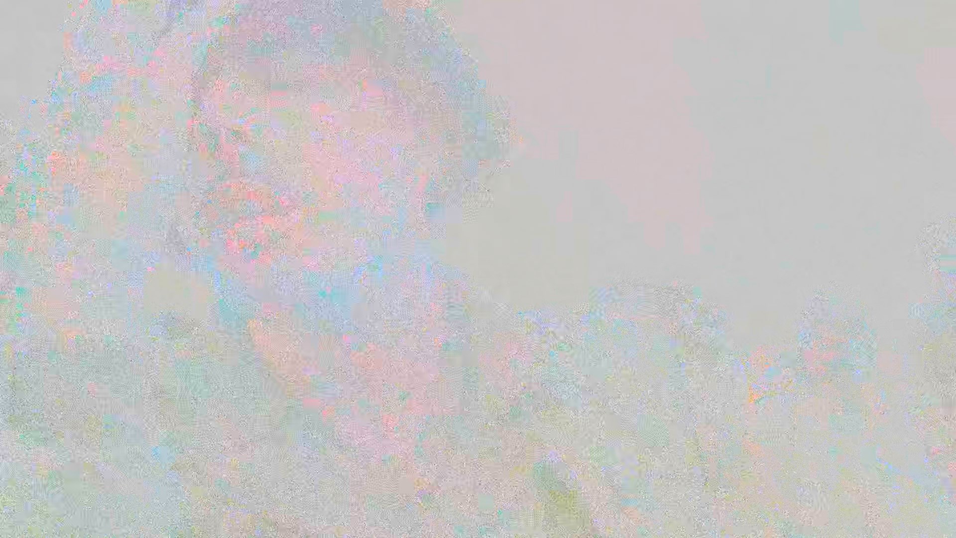

this is the EL of Ryan:
Ryan DV DL 07.06.track_2.hevc_snapshot_00.06.735.jpg (310.03 KiB) Viewed 30884 times

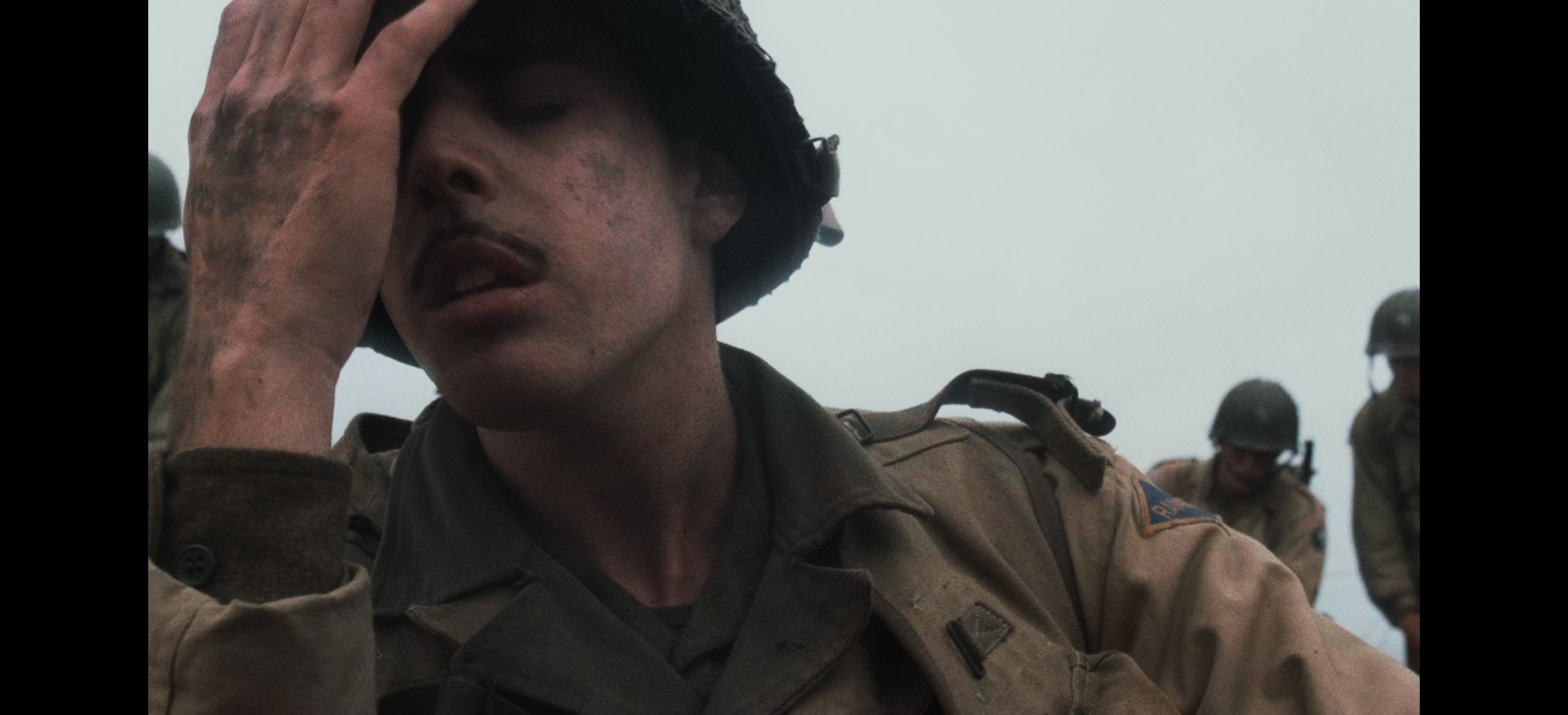

BL:
Ryan DV DL 07.06.track_1.hevc_snapshot_00.06.795.jpg (372 KiB) Viewed 30884 times
You can demux it and playback with MPC-HC :)

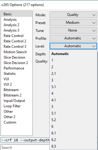

that's not the point here, but it doesn't matter.
Resolution : [3840×2160]
Video Bitrate : [15,3 MB/s]
FPS: : [23,976]
Audio Language : [German (DTS-HD MA 5.1/EAC3 5.1) / English (EAC3 5.1)]
Subtitle Lang. : [German (Complete/Complete SDH) / English (Complete SDH)]
Encoding : [StaxRip -> HEVC x265 Main10 High@L5.1 CRF16 (UHD Ready)]
Colorgrading : [DaVinci Resolve Studio 16 -> BT2020 HDR10 @1000 Nits]
Source : [Mandalorian.S02E01.Chapter.09.REPACK.2160p.WEB-DL.DDP5.1.HDR.x265-RONIN]
x265 is always reencoded, no professional provider encodes with x265 :!:
