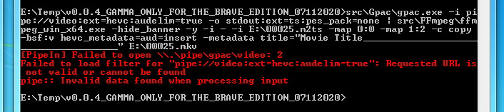

reik_ wrote: Thu Jan 14, 2021 11:40 pm Hi all!
what am I doing wrong?
Did you start the other command window first, and you have that running?

AndreasT wrote: Fri Jan 15, 2021 6:12 am
yeah, first window is ok.
