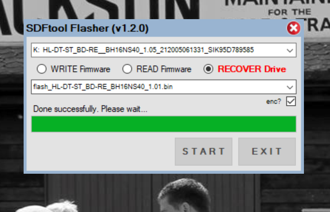

it didnt seem to work though
SDftool did say it was done successfully, but the firmware for the drive is still showing 1.05 instead of 1.01?
Screenshot 2021-01-12 094254.png (121.13 KiB) Viewed 35156 times

stevewrighty2k wrote: Tue Jan 12, 2021 9:45 am thanks!
follow the guide what did i make it for go to WH16NS60 1.02 with the enc box checked
You can't use SDFtool to recover a NS40 drive with NS50 firmware. You'll need to use DOS recovery method as explained here towards the bottom of the post.

stevewrighty2k wrote: Tue Jan 12, 2021 6:16 pm i thought from reading other posts on here that the sdftool was a newer way of being able to flash the drive to the older version without having to use dos?
I thought the only way to recover was to use the DOS method.
Posts: 4995
Re: can i downgrade firmware for LG BH16sn40 using firmware from WH16SN40?
The SDFtool Flasher's recovery option is supposed to be able to recover old NS40 drives incorrectly flashed with newer NS50 firmware but seems to be "hit and miss" at this stage.

Did you update using LG'S official firmware update tool? If so, your drive is screwed.
You could try downgrading to a non-encrypted firmware first before trying the recovery option again.
Flash 1.03MK from the firmware pack (enc checked). Once drive shows firmware has changed, try the recovery option again (no enc).

I have another suggestion for you to try. I still recommend getting off that encrypted firmware first so:
Using SDFtool Flasher,
1. Flash drive to BH16NS40_NS50_1.03_MK (with enc checked) (see attached files)
2. Try and flash drive to ASUS_BC-12D2HT_3.01_MK (see attached files)
If step 2 works and the drive shows as ASUS, please try the next step.
3. Flash the drive with DE_LG_BH16NS40_1.01 (see attached files).
Hopefully this all works and your drive is restored to BH16NS40 1.01.
