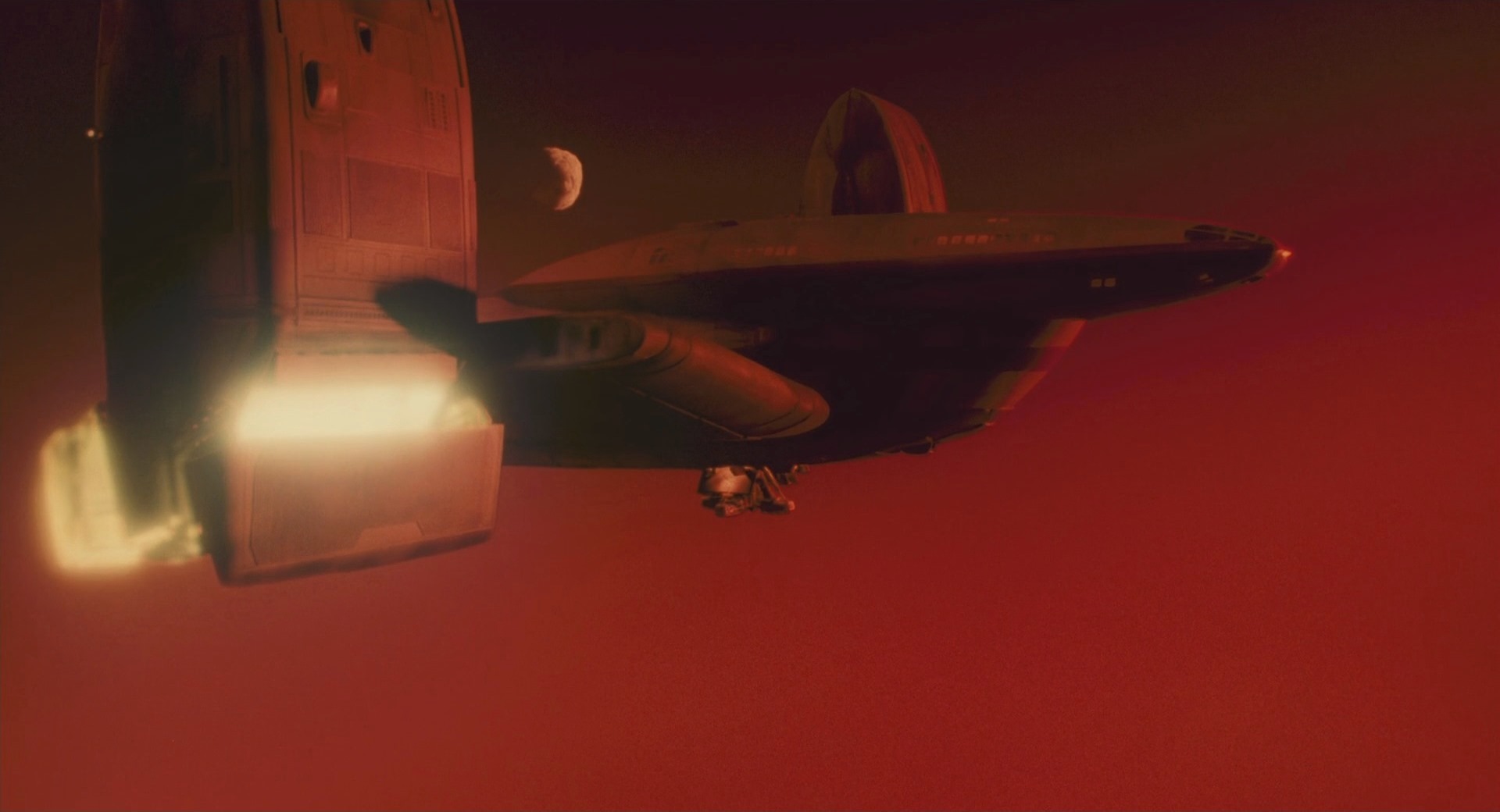

lexyz wrote: Thu Jan 07, 2021 2:33 pm
Manixx2020beyound wrote: Sat Jan 02, 2021 9:18 pm @ lexyz
What’s the time duration on the shuttle scene?
I would like to try a fel comparison in rgb8 & LLDV for total recall using the x700.
Have you had the opportunity to make a comparison yet? :)
I did pretty hard to compare the scenes doe it’s mostly red.
On a diff topic profile 5 funky colors.
Capture purple/green colors which are permanent, to 4:22 pq rencode with Rpu bin
From original & rencode staxrip
Produce a perfect profile 5
Tested playback dv-rgb8
Test file meridian Netflix
Raw funky colors
Raw funky colors
Rencoded doblyvision profile 5

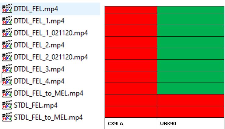

Post by agneva » Sat Jan 09, 2021 1:08 pm
With the new Firmware CX9 plays DV DL mp4. Tested with James Ryan.
I think it's a little dark.
edit:
it is the same as when I create a DV SL from Private Ryan -> it plays only BL+RPU, not the EL. Picture is falsified :x
I think that the TV is not able to decode 2x HEVC at the same time.
So the purchase of the UBK90 was not in vain :D

agneva wrote: Sat Jan 09, 2021 1:08 pm With the new Firmware CX9 plays DV DL mp4. Tested with James Ryan.
edit:
Of course it can physically play dual hevc streams. Are you sure you have the same picture setting for Dolby vision over media player as you do for HDMI input?
agneva
Posts: 61
Post by agneva » Sat Jan 09, 2021 8:41 pm
100% Sure.
In (rare) films with FEL, such as Private Ryan, omitting the EL leads to errors. In this case, the brightness pumps into bright scenes and dark scenes are far too dark. Otherwise I might not have noticed.
where do you get the information from that it can play 2x hevc?
edit:
CX9? Do you mean the LG OLED CX or the LG OLED C9?
Can the UBK90 install apps like Emby or Plex to play DV mp4s over a network?
Wouldn't you be able to test if the CX can decode 2x HEVC at the same time by muxing a DV mp4 with the main HEVC from one film and the EL from a different film? I did this ages ago just to see what would happen, and the colours were all crazy when played on my C8. If you did this and it played with the crazy colours on both the UBK90 and the CX it would indicate the CX is decoding the EL. If it played crazy colours on the UBK90, but looked normal on the CX it would indicate the the CX is only playing the main stream.
Does that make sense, or is my thinking off?
