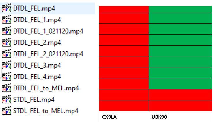

agneva
Posts: 61
#4116 Post by agneva » Sat Jan 09, 2021 1:08 pm
With the new Firmware CX9 plays DV DL mp4. Tested with James Ryan.
I think it's a little dark.
edit:
it is the same as when I create a DV SL from Private Ryan -> it plays only BL+RPU, not the EL. Picture is falsified :x
I think that the TV is not able to decode 2x HEVC at the same time.
So the purchase of the UBK90 was not in vain :D
DaMacFunkin
Posts: 314
#4117 Post by DaMacFunkin » Sat Jan 09, 2021 8:19 pm
agneva wrote: Sat Jan 09, 2021 1:08 pm With the new Firmware CX9 plays DV DL mp4. Tested with James Ryan.
edit:
Of course it can physically play dual hevc streams. Are you sure you have the same picture setting for Dolby vision over media player as you do for HDMI input?
agneva
Posts: 61
#4118 Post by agneva » Sat Jan 09, 2021 8:41 pm
100% Sure.
In (rare) films with FEL, such as Private Ryan, omitting the EL leads to errors. In this case, the brightness pumps into bright scenes and dark scenes are far too dark. Otherwise I might not have noticed.
where do you get the information from that it can play 2x hevc?

#4119 Post by Mouth_of_Sauron » Sat Jan 09, 2021 9:22 pm
agneva wrote: Sat Jan 09, 2021 8:41 pm 100% Sure.
But wouldn't leaving out the EL just make it play exactly as it would on any TV/player that doesn't support DV? So does that mean in rare cases like Private Ryan even the original UHD Blu-Ray will only play properly on DV capable equipment? That sort of thing shouldn't happen should it?
agneva
Posts: 61
#4120 Post by agneva » Sat Jan 09, 2021 9:30 pm
The HDR10 plays without Errors.
If you play the EL alone (Ryan) on MPC you see the brightness flashing.
Don't know how the RPU can make the brightness pumping playing the DV without EL.
Buy private Ryan and test yourself! If U don't believe me.

#4121 Post by Mouth_of_Sauron » Sat Jan 09, 2021 9:46 pm
edit:
CX9? Do you mean the LG OLED CX or the LG OLED C9?
Can the UBK90 install apps like Emby or Plex to play DV mp4s over a network?
Wouldn't you be able to test if the CX can decode 2x HEVC at the same time by muxing a DV mp4 with the main HEVC from one film and the EL from a different film? I did this ages ago just to see what would happen, and the colours were all crazy when played on my C8. If you did this and it played with the crazy colours on both the UBK90 and the CX it would indicate the CX is decoding the EL. If it played crazy colours on the UBK90, but looked normal on the CX it would indicate the the CX is only playing the main stream.
Does that make sense, or is my thinking off?
