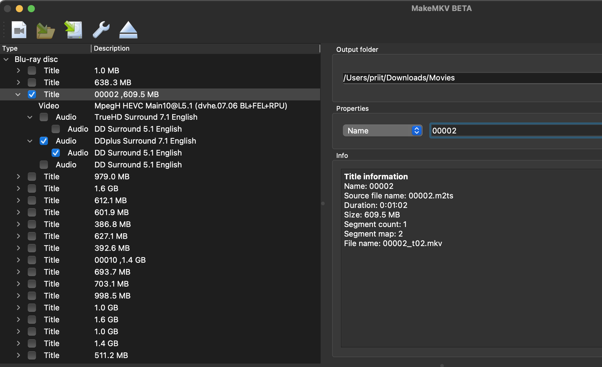

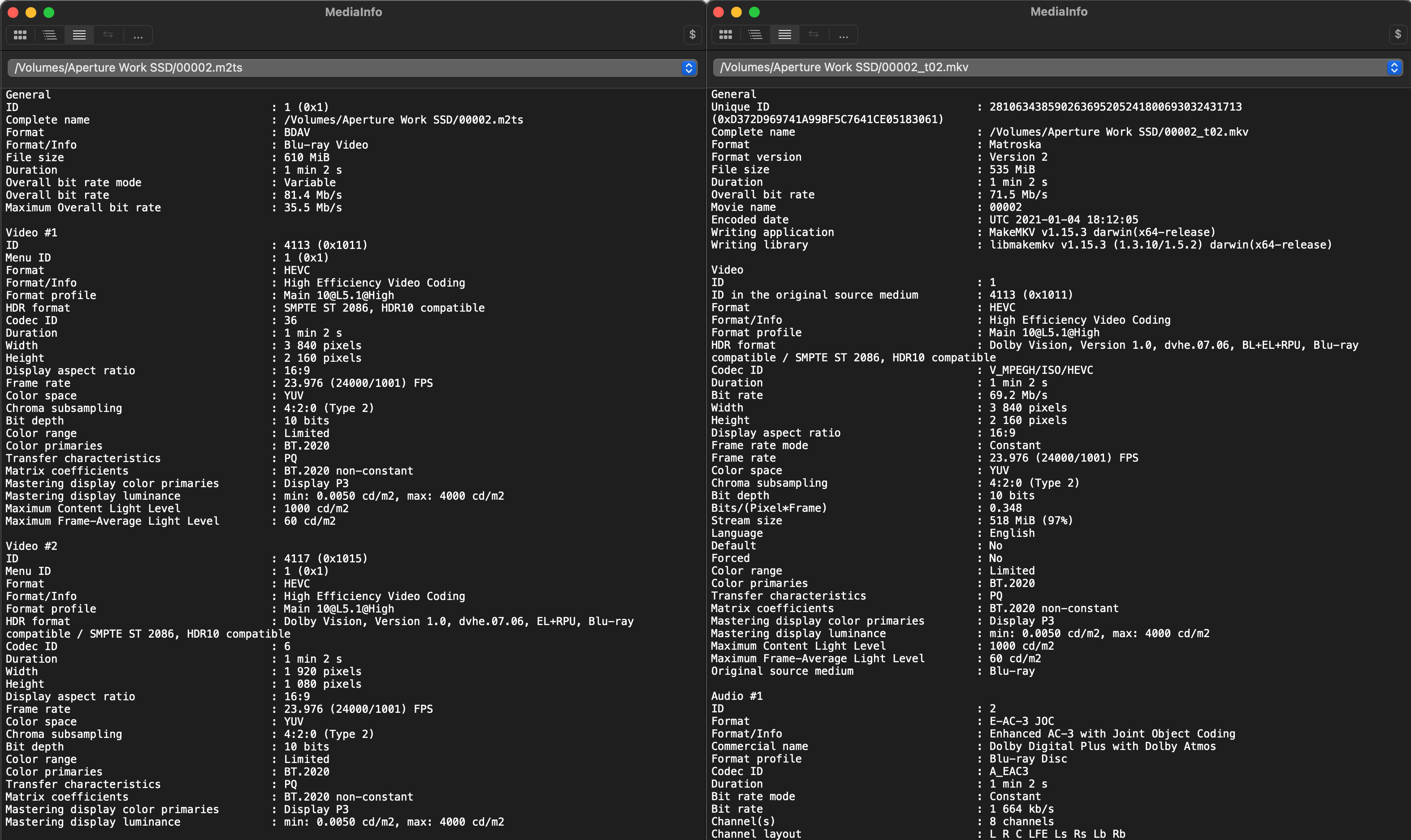

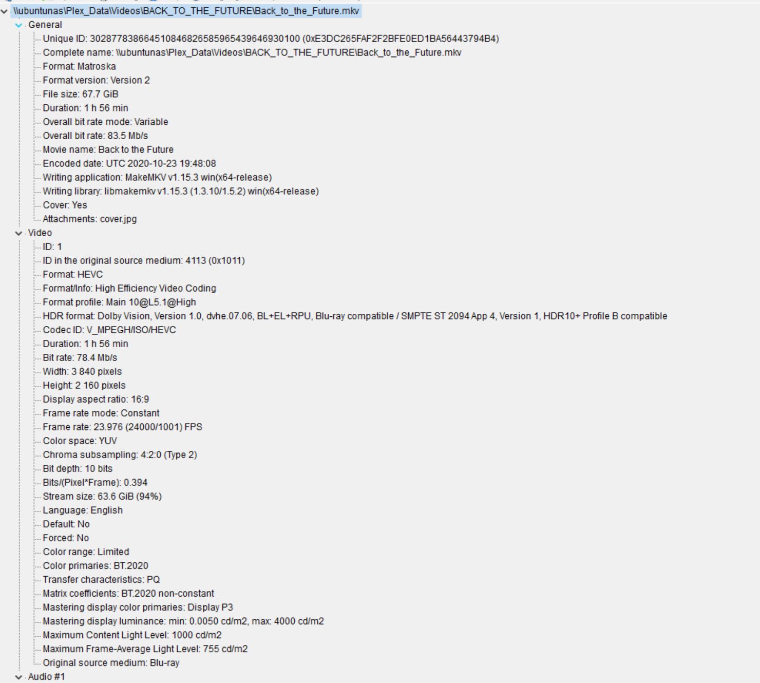

I ripped the MKV out of Dolby UHD demo disc. Original is a classic 2-stream DoVi profile 7.6.
As a result I get from makeMKV a MKV file that has a single-stream video, also tagged as DoVi profile 7.6 stream.
What I do not understand is:
  • what happened to the 2-nd video stream, that is supposed to be the Dolby-specific enhancement layer.
  • is the HDR10 base layer somehow DoVi compatible?
  • when reducing 2-stream DoVi video into 1-stream, did it merge enhancement layer into base layer, as it is supposed to happen inside the player or TV?
If it did not make that step 3) then what is effectively output, reminds me of what DVDFab does. It does not alter the video stream in any way, just tricks the display to switch into DoVi mode, by adding the DoVi metadata.
As I see it, that is not Dolby Vision, just making the logo light up on the screen.
Screenshot 2021-01-04 at 20.16.15.png (271.74 KiB) Viewed 46974 times
Screenshot 2021-01-04 at 20.15.04.png (657.17 KiB) Viewed 46974 times

If you look at your mediainfo screenshot of the resulting mkv file, you'll notice that video track #1 is now labeled as BL+EL+RPU instead of just BL. That's where the enhancement layer (EL) and the metadata has gone (RPU). Makemkv combines both layers (BL, EL) and the metadata onto a single video track. The process does not merge the layers; it merely changes how they're being transported, so all the data in the each respective layer is left in tact. While the EL is still there in the video, no existing device can play them to their full capacity out of an mkv if the EL is a FEL. This certainly is no fault of makemkv, though.

shawnc22 wrote: Mon Jan 04, 2021 10:23 pm If you look at your mediainfo screenshot of the resulting mkv file, you'll notice that video track #1 is now labeled as BL+EL+RPU instead of just BL. That's where the enhancement layer (EL) and the metadata has gone (RPU). Makemkv combines both layers (BL, EL) and the metadata onto a single video track. The process does not merge the layers; it merely changes how they're being transported, so all the data in the each respective layer is left in tact. While the EL is still there in the video, no existing device can play them to their full capacity out of an mkv if the EL is a FEL. This certainly is no fault of makemkv, though.
If that is the case, then how can the stream still be a profile 7 type? That is the single DoVi profile, which explicitly contains separate EL at 1/4 of pixel resolution? Are you saying, that this has now been somehow embedded into UHD stream?
Screenshot 2021-01-05 at 07.54.37.png (166.8 KiB) Viewed 46906 times
Re: Dolby Vision and 1.15.3
Post by shawnc22 » Tue Jan 05, 2021 3:14 pm
priitv8 wrote: Tue Jan 05, 2021 6:05 am
The profile is not determined by how the layers are transported (dual track vs single track, aka dual paid vs single pid), but only whether they are present. Makemkv is merely converting from a dual pid transport stream to a single pid transport stream, without touching any of the data in the individual layers. See pg.14 of this Dolby doc here for more details on pid: https://professional.dolby.com/siteasse ... x-v1.2.pdf

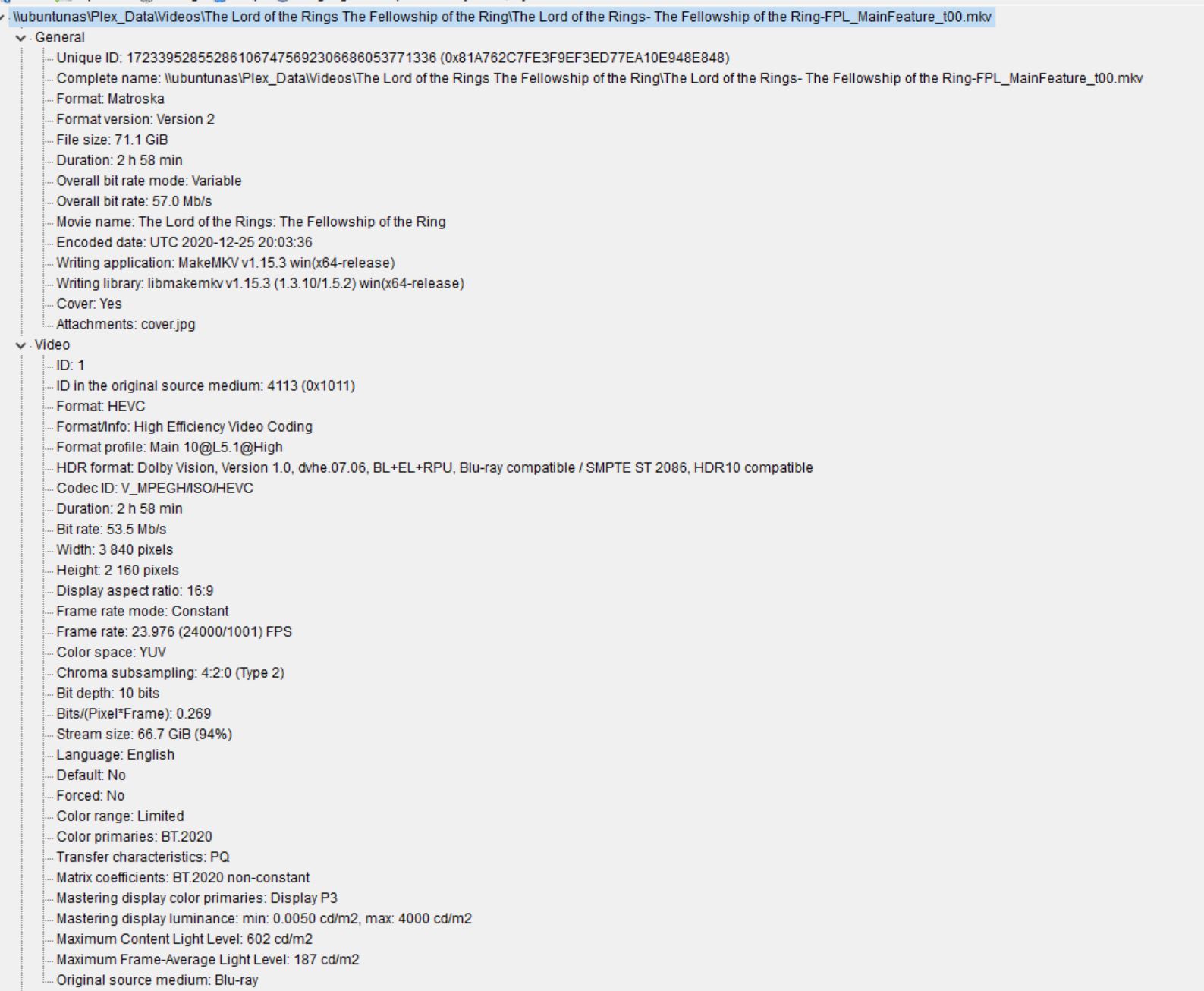

In layman’s terms is there something that "I" didn't do while backing up and making a mkv file of the two Dolby Vision discs below? Lord of the Rings is the only DV disc makemkv file that works for me using the Plex client on the Sony 950h. All other backups / makemkv files fail and I used the same version of 1.15.3 and more recently re-copy using 1.15.4.
I have to be doing something wrong or a setup. TrueHD is changed to normal ac3/5.1 so know it isn't that. Figured I would ask since I'm still chasing this issue. Only DV that works for me is the LoTR sets. Go figure.
LotR - works via Sony 950h client:
Media
Duration 2:58:25
Bitrate 57006 kbps
Width 3840
Height 2160
Aspect Ratio 1.78
Video Resolution 4K
Container MKV
Video Frame Rate 24p
Video Profile main 10
Part
Duration 2:58:25
File The Lord of the Rings- The Fellowship of the Ring-FPL_MainFeature_t00.mkv
Size 71.06 GB
Container MKV
Has Thumbnail 1
Codec HEVC
Bitrate 53483 kbps
Language English
D O V I B L Compat I D 6
D O V I B L Present true
D O V I E L Present true
D O V I Level 6
D O V I Present true
D O V I Profile 7
D O V I R P U Present true
D O V I Version 1.0
Bit Depth 10
Chroma Subsampling 4:2:0
Coded Height 2160
Coded Width 3840
Color Primaries bt2020
Color Range tv
Color Space bt2020nc
Color Trc smpte2084
Frame Rate 23.976 fps
Height 2160
Level 5.1
Profile main 10
Ref Frames 1
Width 3840
Display Title 4K (HEVC Main 10 HDR)
Extended Display Title 4K (HEVC Main 10 HDR)
Does not work:

Back to the Future seems to be a DV FEL release, while LotR seems to be a MEL release according to this thread https://forum.blu-ray.com/showthread.ph ... st16884278.
Most players I've read doesn't play nice with FEL.
Use your Back to the Future disk as the source, and check out my post here https://www.makemkv.com/forum/viewtopic ... 97#p103162 . Maybe you can go through making the test files and see which ones plays on your TV. If you do, please make a post of your result in that thread, I'm sure others with that TV would appreciate.
EDIT: Here is a post with some good DV information. https://forum.blu-ray.com/showthread.ph ... st16884278

Thanks. I think that is what I didn't know. DV FEL vs MEL. I will go read the threads you listed. Appreciate it.

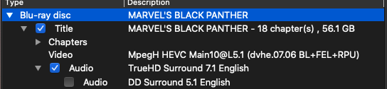

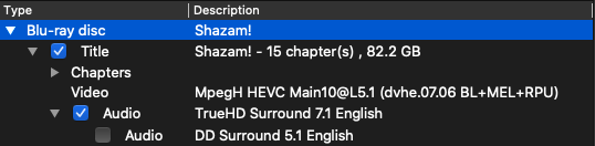

I noticed that when makemkv 1.15.4 opens a BDMV it correctly lists the EL type: FEL or MEL, but when that disc is processed to an .mkv it shows only EL (BL+EL+RPU). Not sure if it has any bearing on anything. Sadly that .mkv plays as HDR (not DV) on Oppo UDP-203, not sure if the latter support DV through .mkv or not.
Screen Shot 2021-01-06 at 8.56.51 AM.png (36.73 KiB) Viewed 46734 times
Screen Shot 2021-01-06 at 8.57.14 AM.png (33.48 KiB) Viewed 46734 times
