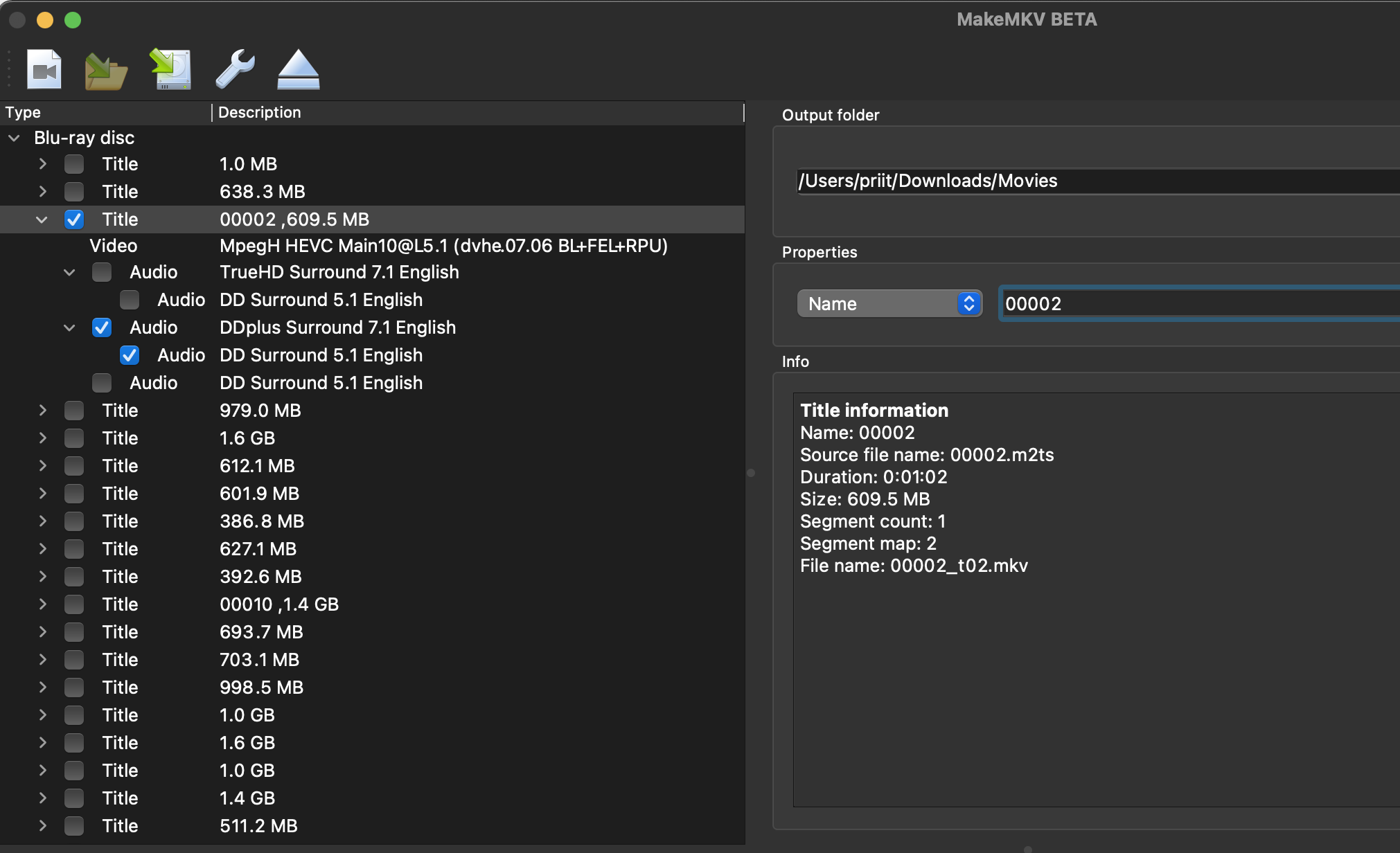

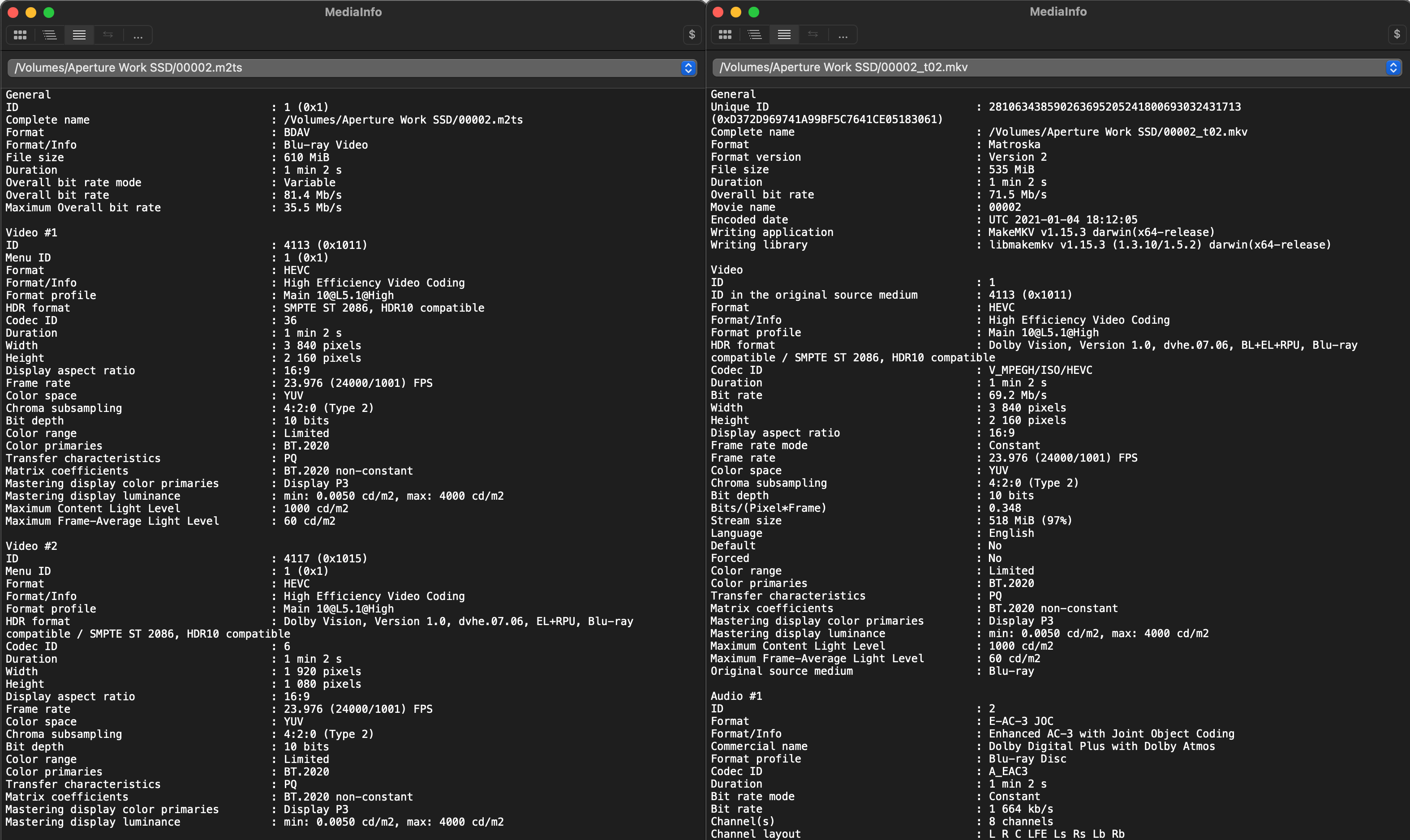

I ripped the MKV out of Dolby UHD demo disc. Original is a classic 2-stream DoVi profile 7.6.
As a result I get from makeMKV a MKV file that has a single-stream video, also tagged as DoVi profile 7.6 stream.
What I do not understand is:
  • what happened to the 2-nd video stream, that is supposed to be the Dolby-specific enhancement layer.
  • is the HDR10 base layer somehow DoVi compatible?
  • when reducing 2-stream DoVi video into 1-stream, did it merge enhancement layer into base layer, as it is supposed to happen inside the player or TV?
If it did not make that step 3) then what is effectively output, reminds me of what DVDFab does. It does not alter the video stream in any way, just tricks the display to switch into DoVi mode, by adding the DoVi metadata.
As I see it, that is not Dolby Vision, just making the logo light up on the screen.

As I understand it, there is no tool in the hands of public, that is capable of transforming (merging) 2 DoVi streams (profile 7) into a single-stream (profile 5) video. Hence, even if you make Dolby logo light up on screen, you are still watching HDR10 video. PS I also own DVDFab UHD ripper, but now that tsMuxeR can handle all the same tasks, I do not use it that much. Using MP4 container, I also lose the TrueHD Atmos. Just like with Dolby Vision, there are no tools in the hands of public, that could transcode TrueHD Atmos into DD+ Atmos, which can be muxed into MP4 container.
I would love to be taught otherwise.
Meanwhile - I enjoy verbatim blu-ray Dolby Vision with Atmos from makeMKV produced decrypted backups that I remux with tsMuxeR using the latest nightly build. That sets the codec in 2nd video stream to dvhe.07.06 (as seen on the upper left mediainfo screen). My Sony bluray player renders this happily as Dolby vision. If I manage to feed it a profile 5 stream, it handles that as well. These are just so much harder to come by.

priitv8 wrote: Mon Jan 04, 2021 7:27 pm I ripped the MKV out of Dolby UHD demo disc. Original is a classic 2-stream DoVi profile 7.6.

If you look at your mediainfo screenshot of the resulting mkv file, you'll notice that video track #1 is now labeled as BL+EL+RPU instead of just BL. That's where the enhancement layer (EL) and the metadata has gone (RPU). Makemkv combines both layers (BL, EL) and the metadata onto a single video track. The process does not merge the layers; it merely changes how they're being transported, so all the data in the each respective layer is left in tact. While the EL is still there in the video, no existing device can play them to their full capacity out of an mkv if the EL is a FEL. This certainly is no fault of makemkv, though.

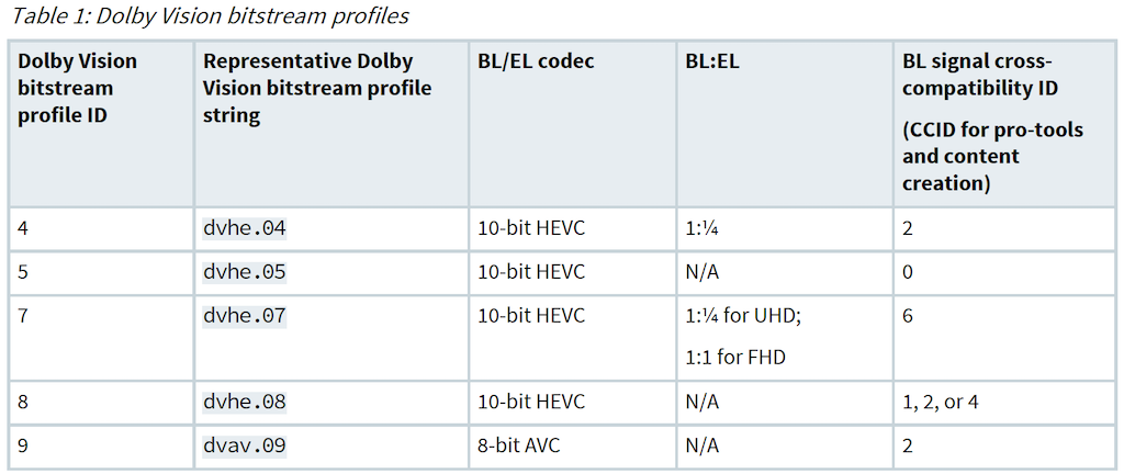

shawnc22 wrote: Mon Jan 04, 2021 10:23 pm If you look at your mediainfo screenshot of the resulting mkv file, you'll notice that video track #1 is now labeled as BL+EL+RPU instead of just BL. That's where the enhancement layer (EL) and the metadata has gone (RPU). Makemkv combines both layers (BL, EL) and the metadata onto a single video track. The process does not merge the layers; it merely changes how they're being transported, so all the data in the each respective layer is left in tact. While the EL is still there in the video, no existing device can play them to their full capacity out of an mkv if the EL is a FEL. This certainly is no fault of makemkv, though.
If that is the case, then how can the stream still be a profile 7 type? That is the single DoVi profile, which explicitly contains separate EL at 1/4 of pixel resolution? Are you saying, that this has now been somehow embedded into UHD stream?

The profile is not determined by how the layers are transported (dual track vs single track, aka dual paid vs single pid), but only whether they are present. Makemkv is merely converting from a dual pid transport stream to a single pid transport stream, without touching any of the data in the individual layers. See pg.14 of this Dolby doc here for more details on pid: https://professional.dolby.com/siteasse ... x-v1.2.pdf

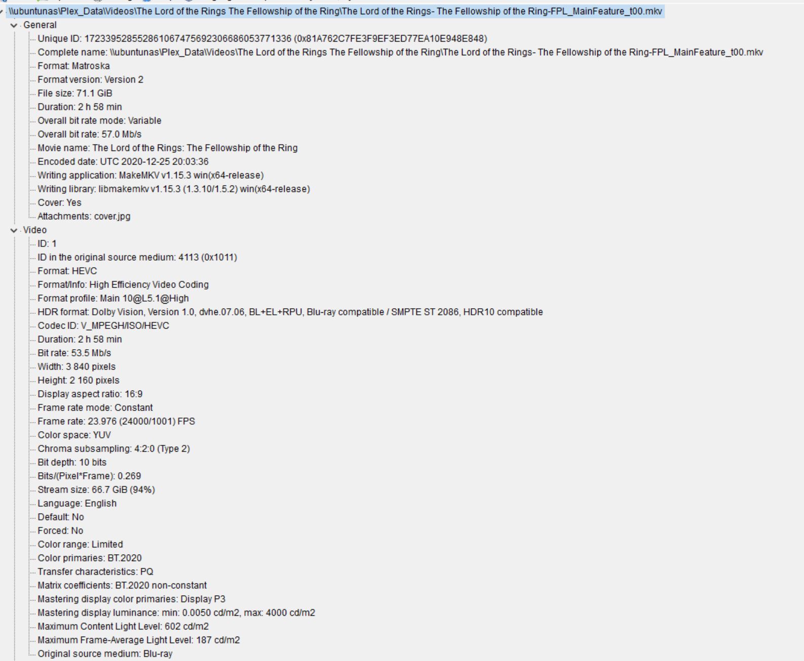

In layman’s terms is there something that "I" didn't do while backing up and making a mkv file of the two Dolby Vision discs below? Lord of the Rings is the only DV disc makemkv file that works for me using the Plex client on the Sony 950h. All other backups / makemkv files fail and I used the same version of 1.15.3 and more recently re-copy using 1.15.4.
I have to be doing something wrong or a setup. TrueHD is changed to normal ac3/5.1 so know it isn't that. Figured I would ask since I'm still chasing this issue. Only DV that works for me is the LoTR sets. Go figure.
LotR - works via Sony 950h client:
Media
Duration 2:58:25
Bitrate 57006 kbps
Width 3840
Height 2160
Aspect Ratio 1.78
Video Resolution 4K
Container MKV
Video Frame Rate 24p
Video Profile main 10
Part
Duration 2:58:25
File The Lord of the Rings- The Fellowship of the Ring-FPL_MainFeature_t00.mkv
Size 71.06 GB
Container MKV
Has Thumbnail 1
Codec HEVC
Bitrate 53483 kbps
Language English
D O V I B L Compat I D 6
D O V I B L Present true
D O V I E L Present true
D O V I Level 6
D O V I Present true
D O V I Profile 7
D O V I R P U Present true
D O V I Version 1.0
Bit Depth 10
Chroma Subsampling 4:2:0
Coded Height 2160
Coded Width 3840
Color Primaries bt2020
Color Range tv
Color Space bt2020nc
Color Trc smpte2084
Frame Rate 23.976 fps
Height 2160
Level 5.1
Profile main 10
Ref Frames 1
Width 3840
Display Title 4K (HEVC Main 10 HDR)
Extended Display Title 4K (HEVC Main 10 HDR)

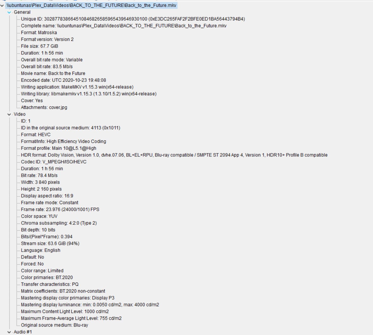

Does not work:
Media
Duration 1:56:02
Bitrate 83549 kbps
Width 3840
Height 2160
Aspect Ratio 1.78
Video Resolution 4K
Container MKV
Part
Duration 1:56:02
File Back_to_the_Future.mkv
Size 67.72 GB
Container MKV
Has Thumbnail 1
Codec HEVC
Bitrate 82717 kbps
Language English
D O V I Level 6
D O V I Profile 7
D O V I Version 1.0
Bit Depth 10
Coded Height 2160
Coded Width 3840
Color Range tv
Color Trc smpte2084
Height 2160
Level 5.1
Profile main 10
Ref Frames 1
Width 3840

Back to the Future seems to be a DV FEL release, while LotR seems to be a MEL release according to this thread https://forum.blu-ray.com/showthread.ph ... st16884278.
Most players I've read doesn't play nice with FEL.
Use your Back to the Future disk as the source, and check out my post here https://www.makemkv.com/forum/viewtopic ... 97#p103162 . Maybe you can go through making the test files and see which ones plays on your TV. If you do, please make a post of your result in that thread, I'm sure others with that TV would appreciate.
EDIT: Here is a post with some good DV information. https://forum.blu-ray.com/showthread.ph ... st16884278

Thanks. I think that is what I didn't know. DV FEL vs MEL. I will go read the threads you listed. Appreciate it.
So far the Sony 950H plex app will play the LoTR movies after I change audio from True HD. The picture quality is amazing and I'm glad I spent the time redoing all of my DV titles. However as I posted none of my other disc copies work. Back to the Future, Jaws, etc. With your suggestion I will see if it is a MEL vs FEL thing. If so I am expecting those that not work be FEL tagged. Should be easy to see if so.
Thanks again and will update threads accordingly. Have a great day!

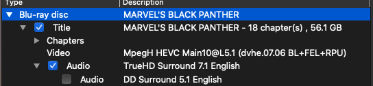

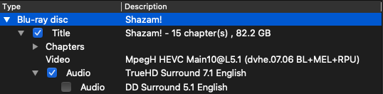

I noticed that when makemkv 1.15.4 opens a BDMV it correctly lists the EL type: FEL or MEL, but when that disc is processed to an .mkv it shows only EL (BL+EL+RPU). Not sure if it has any bearing on anything. Sadly that .mkv plays as HDR (not DV) on Oppo UDP-203, not sure if the latter support DV through .mkv or not.
Screen Shot 2021-01-06 at 8.56.51 AM.png (36.73 KiB) Viewed 45345 times
Screen Shot 2021-01-06 at 8.57.14 AM.png (33.48 KiB) Viewed 45345 times

aboulfad wrote: Wed Jan 06, 2021 2:03 pmI noticed that when makemkv 1.15.4 opens a BDMV it correctly lists the EL type: FEL or MEL, but when that disc is processed to an .mkv it shows only EL (BL+EL+RPU). Not sure if it has any bearing on anything. Sadly that .mkv plays as HDR (not DV) on Oppo UDP-203, not sure if the latter support DV through .mkv or not.
MediaInfo doesn't differentiate the different EL types.
