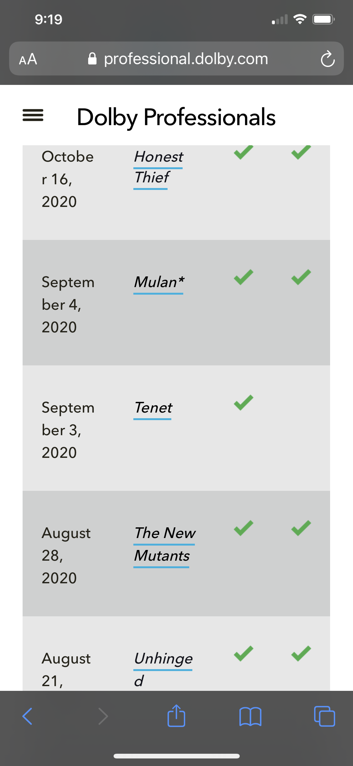

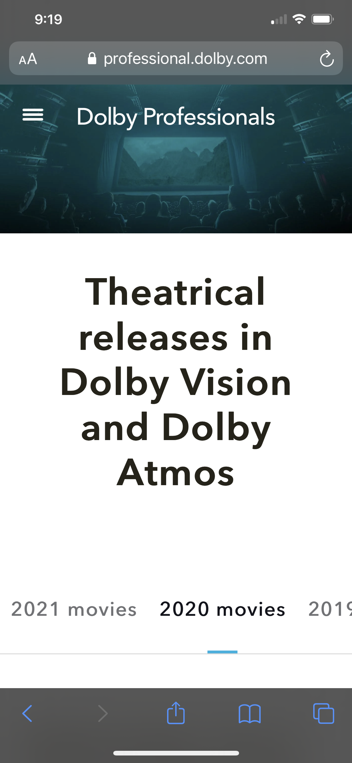

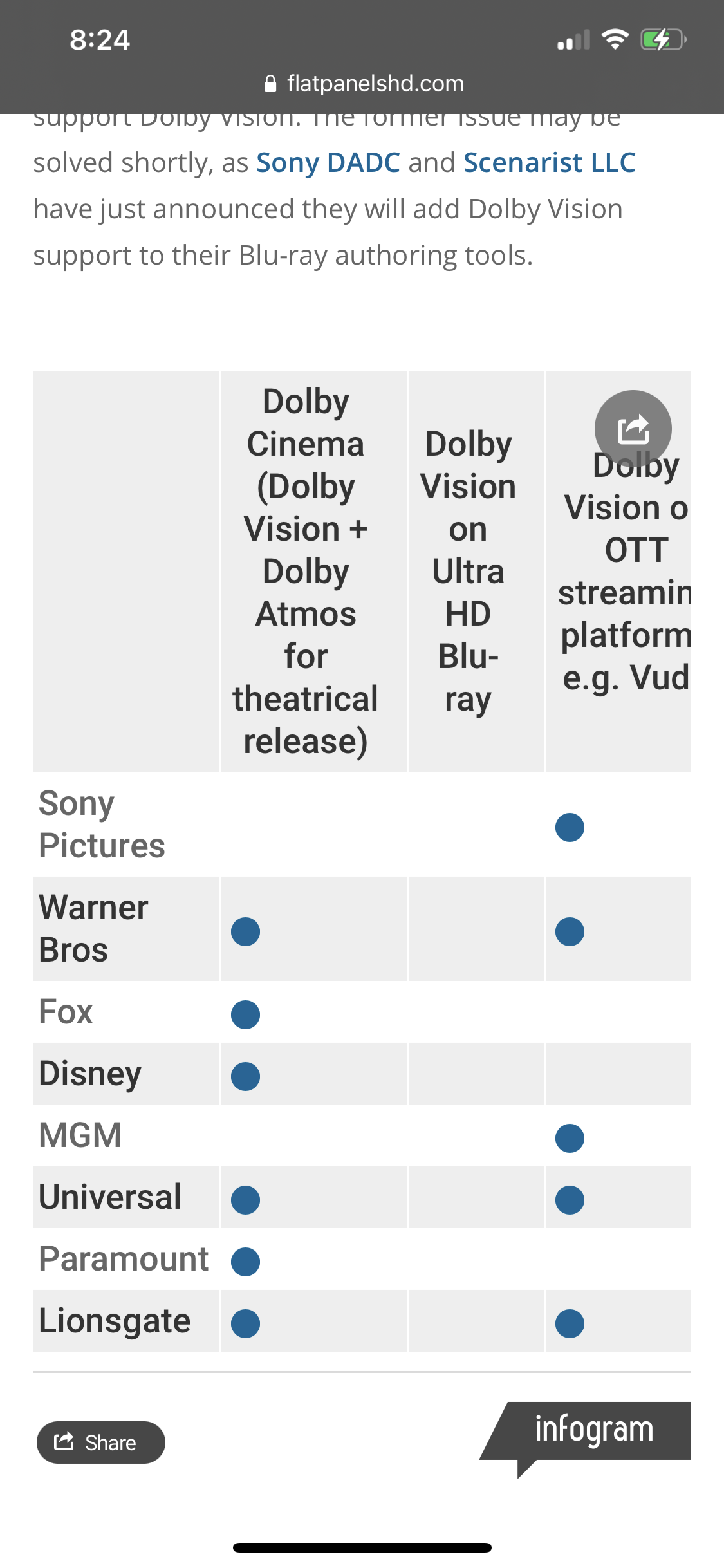

#4086 Post by Manixx2020beyound » Mon Jan 04, 2021 1:48 am
Manixx2020beyound wrote: Sun Jan 03, 2021 12:06 am
glc650 wrote: Sat Jan 02, 2021 11:30 pm
Manixx2020beyound wrote: Sat Jan 02, 2021 9:09 pm Hey I’m not going to dispute the legitimacy of the streaming providers doblyvision
That’s why I do comparisons & use uhd as source standard quality wise,
There are some movies that only appeared
In doblyvision on streaming platform eg
This has bin out in doblyvision for years
Official uhd realese in a few weeks
Which I will be able to compare as well.
2012 is another uhd that has bin in doblyvision stream for some time.( soon to be realesed)
Again, If the studio never released a film in DV then the streaming providers don't actually have a DV version. They are just converting it, so what's the point of comparing something that was never released by the movie studio anyway? And a UHD stream is no comparison to a UHD BR disc/rip.
That’s like saying maldorian,soul web rip dl,
Is a conversion.
5 to 6gigs at that & plays like a uhd some web rips are not far off from the uhd Visually,
bitrate yea, I understand that,
& yes I would like to see the difference in 2012 vs the stream,
Streaming wise there is some great movies on Netflix not on uhd disc, I understand this is about uhd disc, movie shot in 6k 8k 12k cameras then streamed @16mb,14mb,24mb
Looks just as good. Not better yet.
More to your point I have no idea if it’s a conversion vs graded even so I’m still curious about the variety of 1 tittle produce from the masters & eventually it will be all streaming sorry.
A conversion using doblyvision algorithm
Still curious.
There are devices they use in post to view raw hdr in doblyvision using the same algorithm visual as reference.
This is why doblyvision streams came before ultra uhd disc back in 2016 streaming providers don’t encode.
Also it’s not fake if we search further .
https://professional.dolby.com/cinema/t ... releases/2
https://www.flatpanelshd.com/focus.php? ... 1472208035
