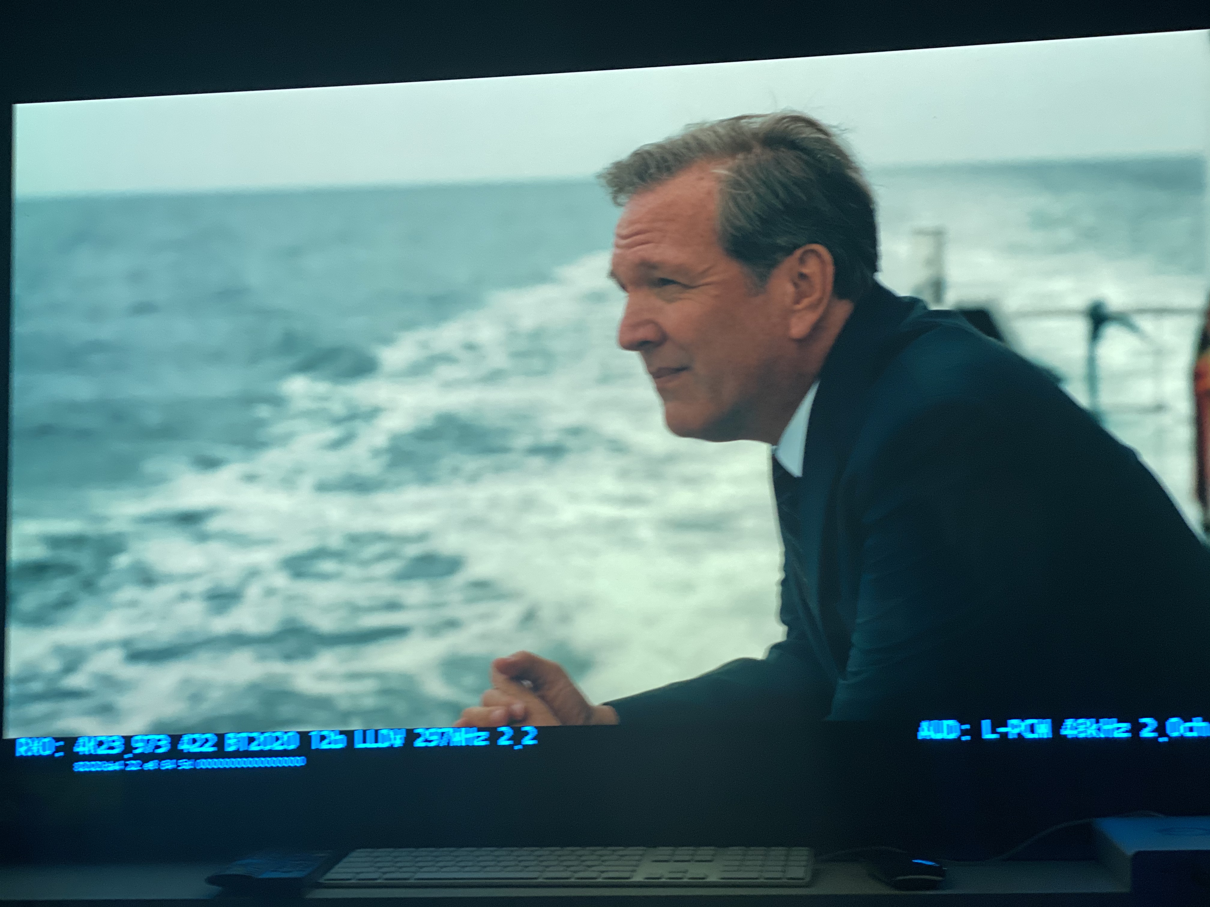

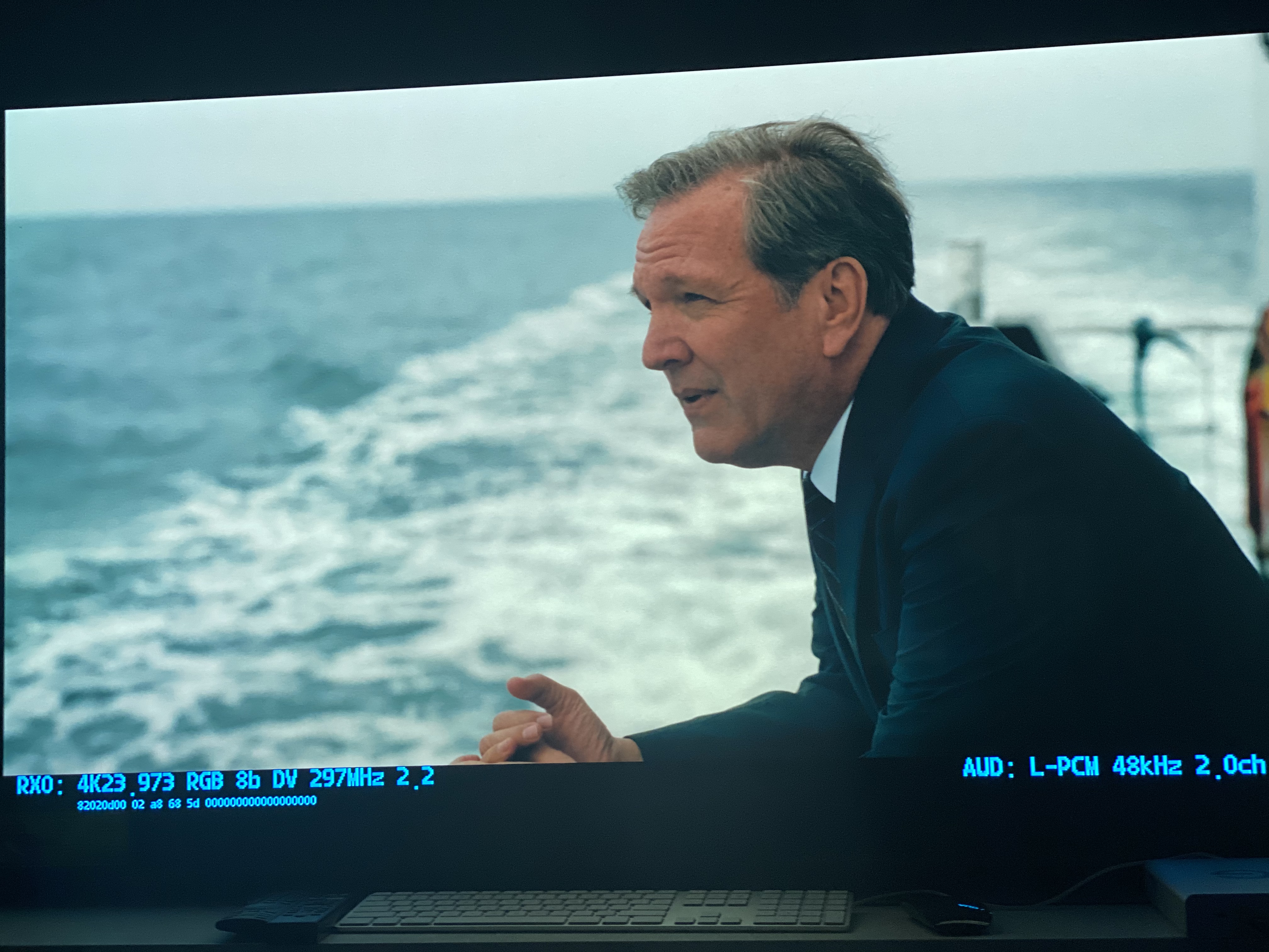

tNet doblyvision shieldManixx2020beyound wrote: Wed Dec 30, 2020 2:35 amU would have to do x700 fel LLDV vs x700 fel rgb dv8 to see if that’s true.RESET_9999 wrote: Wed Dec 30, 2020 1:22 amOk,pete19 wrote: Wed Dec 30, 2020 1:02 am you need to use p7 with FEL in order to see differences - because the "problem" occurs when the EL is merged with the BL, and in LLDV this is done by the player/source and it won't be as accurate as tv-led
p5 does not have EL
but the Shield is not capable of displaying p7 properly (or any other format than p5), so that comparison between the Shield and the x700 cannot be done (well it wouldn't mean anything).
Also, are you saying that MEL would look identical in player-led and tv-led ?
LLDV vs rgb8 Dolby
- LLDV/hdr10
- 1E63162E-ACFF-4503-8F50-474473E8B7E4.jpeg (3.46 MiB) Viewed 29706 times
- LLDV shield
- F2230DD4-1000-4840-B860-616A7987E7BF.jpeg (3.4 MiB) Viewed 29706 times

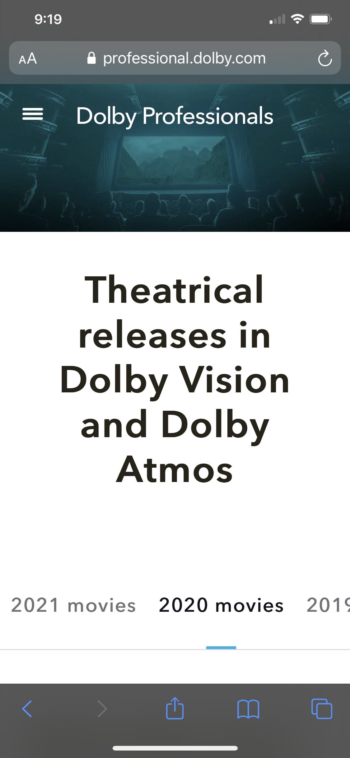

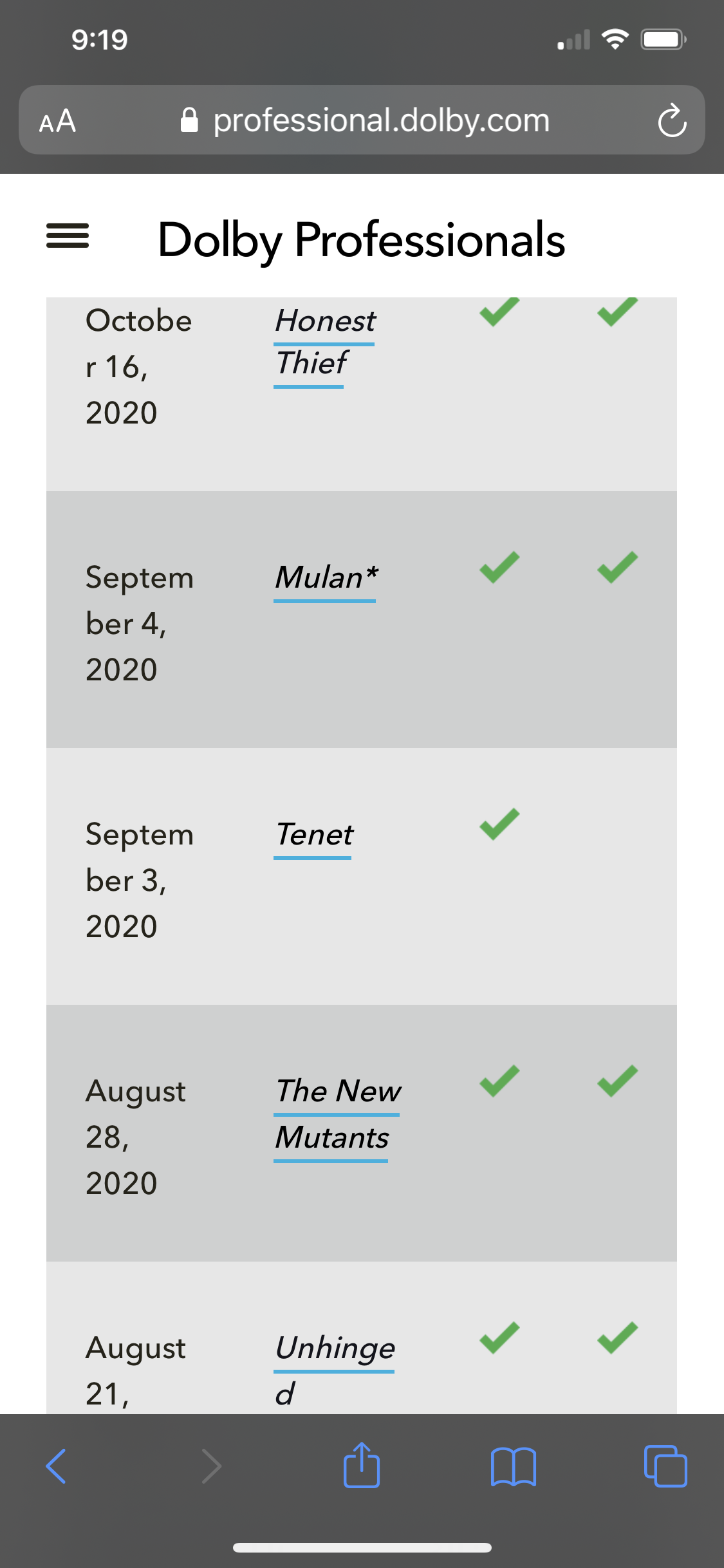

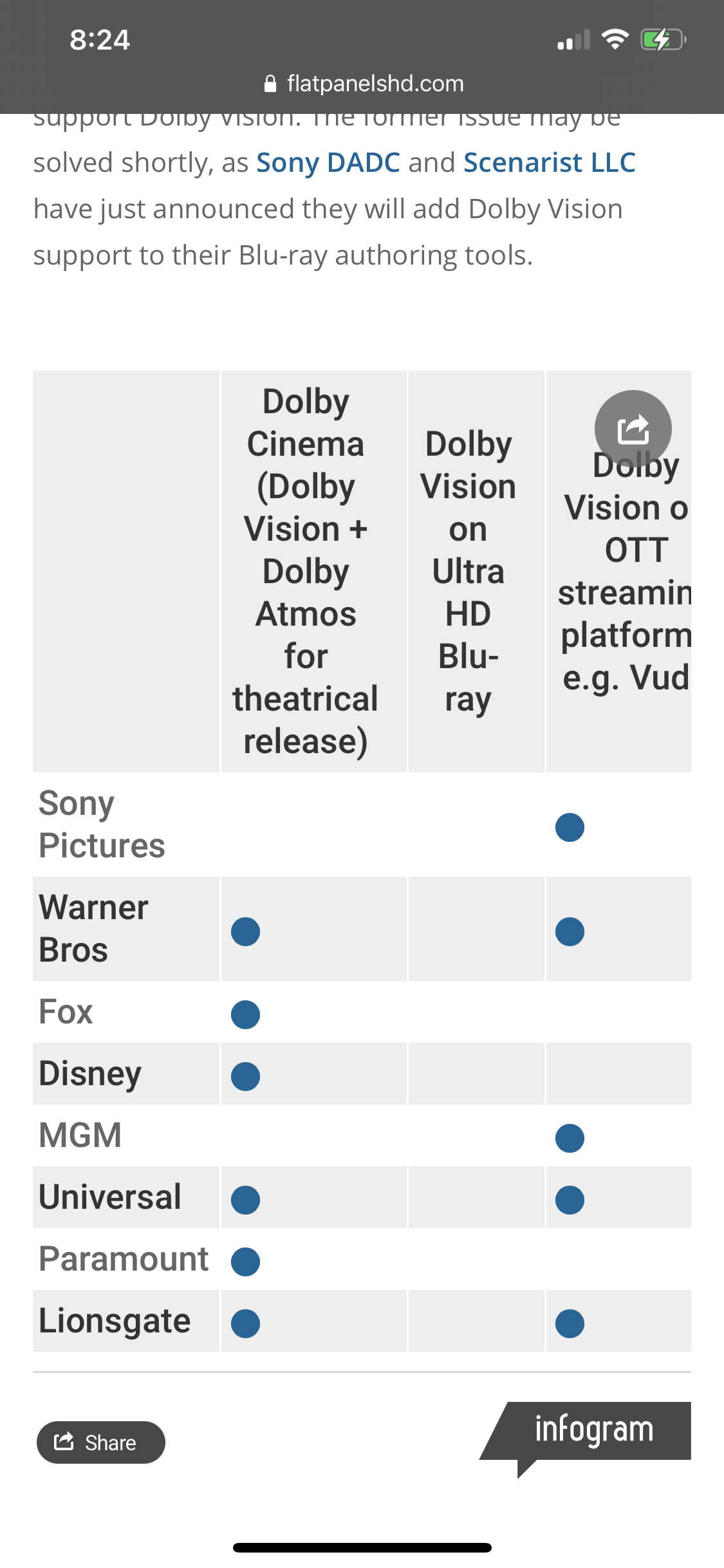

The maker's of this film never did a DV grade (only HDR10). That means these streaming providers are doing some sort of conversion. That alone makes this comparison suspect to me (never mind that the comparison is being done on the streamed version rather than full BR disc version).Manixx2020beyound wrote: Sat Jan 02, 2021 3:12 pm Movies Everywhere streaming platform.

Hey I’m not going to dispute the legitimacy of the streaming providers doblyvisionglc650 wrote: Sat Jan 02, 2021 5:45 pmThe maker's of this film never did a DV grade (only HDR10). That means these streaming providers are doing some sort of conversion. That alone makes this comparison suspect to me (never mind that the comparison is being done on the streamed version rather than full BR disc version).Manixx2020beyound wrote: Sat Jan 02, 2021 3:12 pm Movies Everywhere streaming platform.
Vudu,appletv4k once u own the disc u have a digital 4K copy as well.
That’s why I do comparisons & use uhd as source standard quality wise,

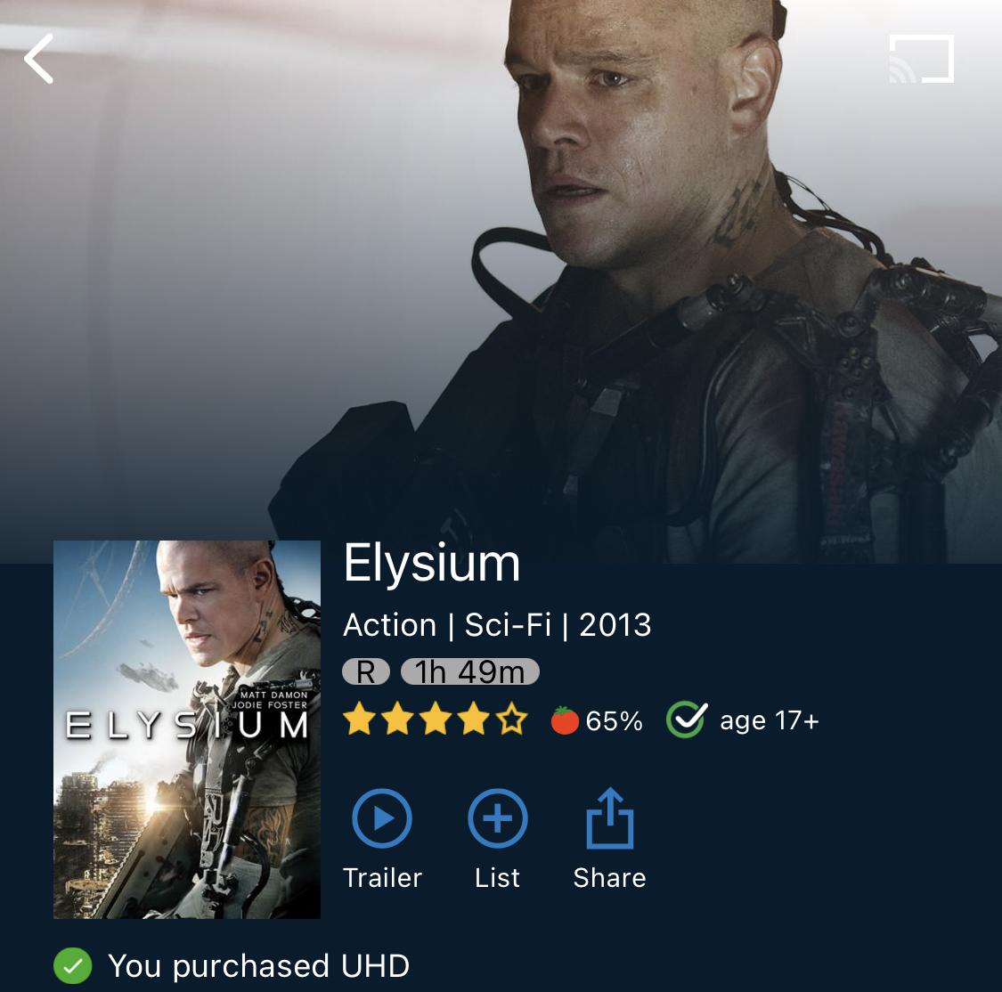

There are some movies that only appeared
In doblyvision on streaming platform eg
This has bin out in doblyvision for years
Official uhd realese in a few weeks
Which I will be able to compare as well.
2012 is another uhd that has bin in doblyvision stream for some time.( soon to be realesed)
- B0EB7BFA-C4FE-45A9-AC62-17A897960F84.jpeg (616.44 KiB) Viewed 28675 times

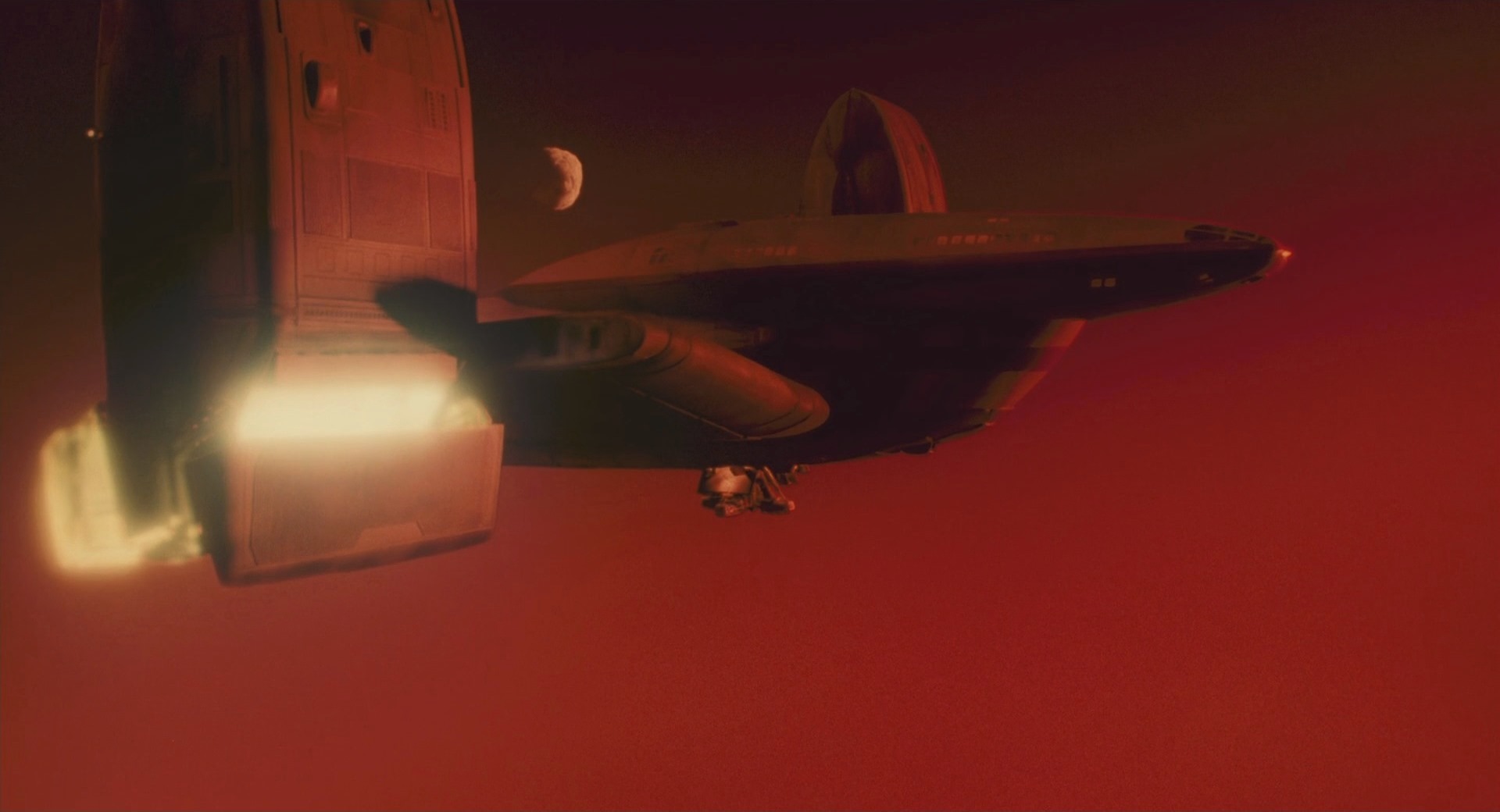

But after numerous viewings of "Shuttle scene" in Total Recall I tend to belive Shield just skip FEL and plays BL+RPU only. At least in LLDV mode.
This scene has extremely poorly encoded HDR10 layer and all film grain remains in FEL. So difference BL vs BL+FEL is noticeable.

Around 43:20 markManixx2020beyound wrote: Sat Jan 02, 2021 9:18 pm @ lexyz
What’s the time duration on the shuttle scene?
I would like to try a fel comparison in rgb8 & LLDV for total recall using the x700.
Screenshot is not from UHD disk
- 02 Shuttle landing on Mars Total Recall 1990 movie image.jpg (159.8 KiB) Viewed 28630 times
