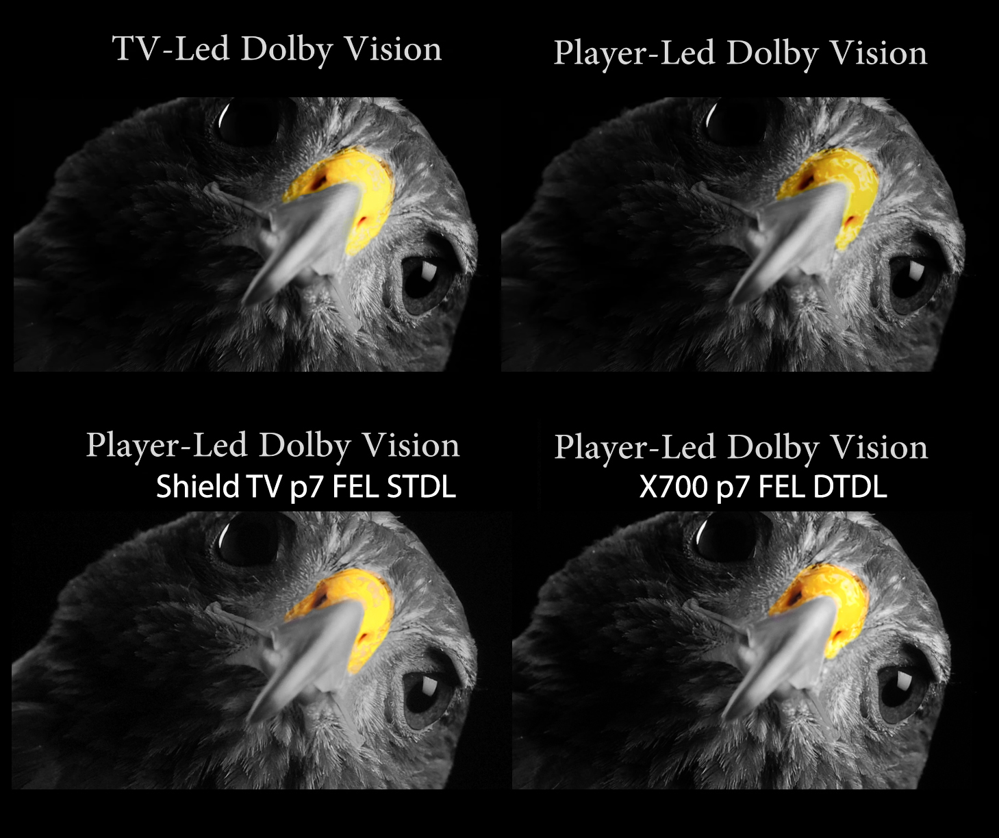

lexyz wrote: Sat Dec 26, 2020 1:28 pm I share this picture to discuss possible reasons why Shield TV Player-led STDL very close to Oppo TV-led DTDL
Any ideas? :roll:
Pay attention on yellow beak
shield image has incorrect hue/saturation on the beak (compared to tv-led), besides the color artifacts/clipping
lexyz
Posts: 120
Post by lexyz » Sun Dec 27, 2020 6:12 am
Guys, don't compare hue sharpness, brightness or clipping
I can't set my camera and TV to match Vincent's
Do not make conclusion about this parameters
:D
Only thing to look at is the shape of yellow spot
Zoom in if you're on mobile.
Can't you see the similarities and differences?

lexyz wrote: Sun Dec 27, 2020 6:12 am Guys, don't compare hue sharpness, brightness or clipping
:D
Ive always found the output from the Oppo to be very Natural and not over saturated,is that not what we are looking for? That’s certainly what I see in your pic.

Post by lexyz » Sun Dec 27, 2020 2:21 pm
Ok
I desaturated whole picture but point of interest
For my eye Shield's STDL more close to Oppo TV-led than Oppo or X700 Player-led
Why?
Post by RESET_9999 » Sun Dec 27, 2020 2:36 pm
SMH...
sorry to repeat myself but you can't draw ANY conclusion by comparing some videos on youtube with your own TV photo... it's just meaningless and useless (not scientific)...
the only valid comparison here is the shield vs x700 assuming you used exactly the same camera settings which we CAN'T confirm when you put the images like that...
