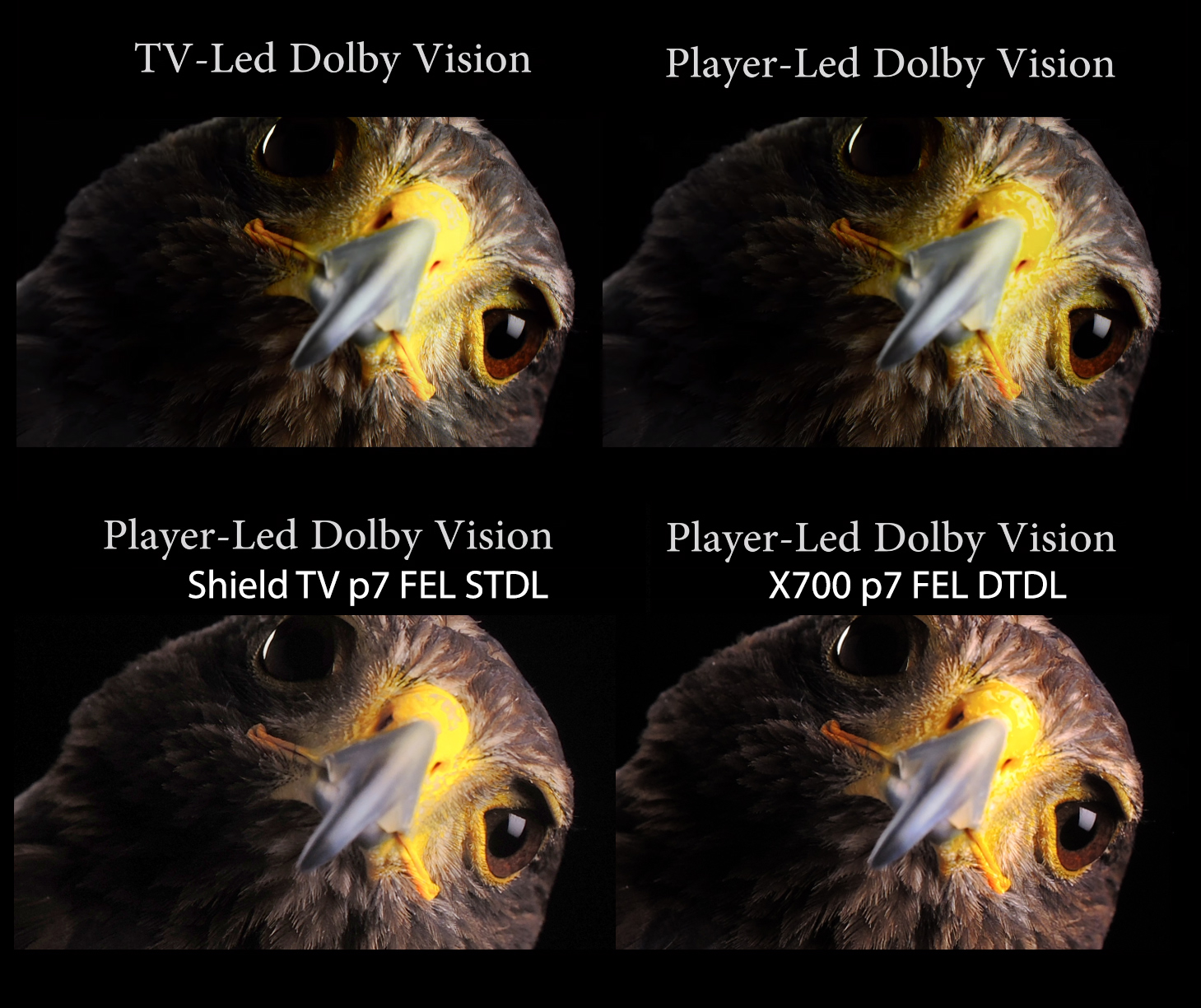

I share this picture to discuss possible reasons why Shield TV Player-led STDL very close to Oppo TV-led DTDL
Any ideas? :roll:
Pay attention on yellow beak
Post by Manixx2020beyound » Sat Dec 26, 2020 3:09 pm
lexyz wrote: Sat Dec 26, 2020 1:28 pm I share this picture to discuss possible reasons why Shield TV Player-led STDL very close to Oppo TV-led DTDL
Any ideas? :roll:
What type of uhd Tv is the tv-led dv ?
Sorry but oppo don’t look that good to me.
X700 takes it all lol.
Post by RESET_9999 » Sat Dec 26, 2020 3:21 pm
Any ideas? :roll:
top picture is from the Vincent video ??
As I told you in PM, you can't compare the images from his video/TV with the images from your camera/TV. it means nothing
Not the same room, not the same tv, not the same camera / settings etc...
On my calibrated monitor, all 4 pictures look completely different and the shield picture doesnt look at all close to the oppo tv-led but as i said, its meaningless.
