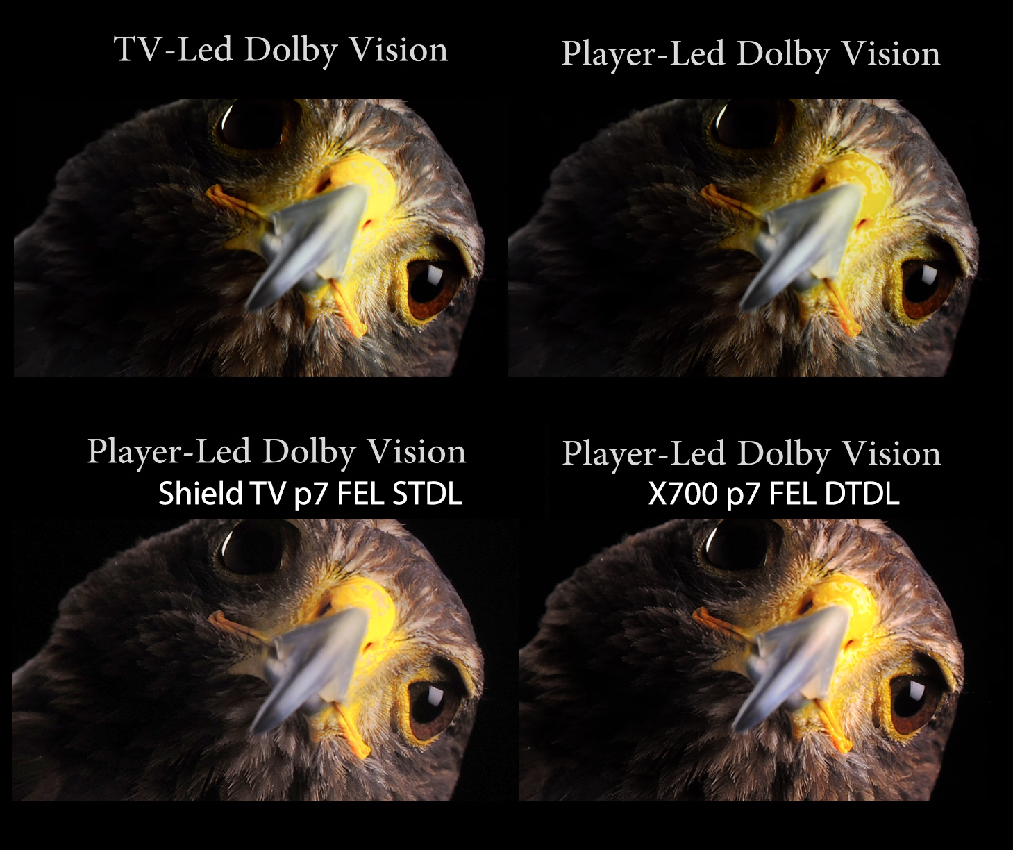

#3999 Post by lexyz » Sat Dec 26, 2020 1:28 pm
I share this picture to discuss possible reasons why Shield TV Player-led STDL very close to Oppo TV-led DTDL
Any ideas? :roll:
Pay attention on yellow beak
#4000 Post by Manixx2020beyound » Sat Dec 26, 2020 3:09 pm
lexyz wrote: Sat Dec 26, 2020 1:28 pm I share this picture to discuss possible reasons why Shield TV Player-led STDL very close to Oppo TV-led DTDL
Any ideas? :roll:
What type of uhd Tv is the tv-led dv ?
Sorry but oppo don’t look that good to me.
X700 takes it all lol.
#4001 Post by RESET_9999 » Sat Dec 26, 2020 3:21 pm
Any ideas? :roll:
top picture is from the Vincent video ??
As I told you in PM, you can't compare the images from his video/TV with the images from your camera/TV. it means nothing
Not the same room, not the same tv, not the same camera / settings etc...
On my calibrated monitor, all 4 pictures look completely different and the shield picture doesnt look at all close to the oppo tv-led but as i said, its meaningless.
I don't think so... Vincent said he tested the Panasonic bluray player as well.
Also,  Stacey Spears (creator of Spears and Munsil) confirmed that all the bluray players will have this issue when doing player-led DV.
EDIT: Also it sounds like @pete was right about FEL being 422, or Don't I understand whats Stacey is saying ?
