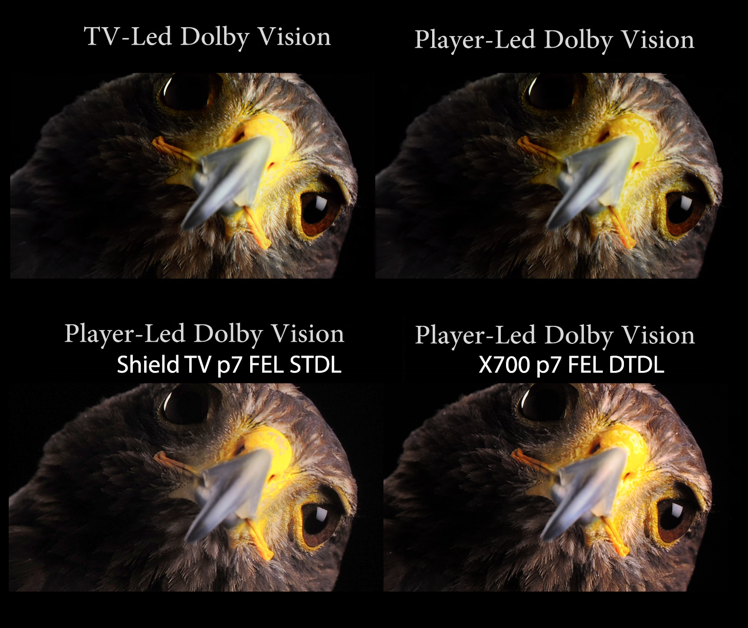

I share this picture to discuss possible reasons why Shield TV Player-led STDL very close to Oppo TV-led DTDL
Any ideas? :roll:
Pay attention on yellow beak
Post by Manixx2020beyound »
lexyz wrote:
Sat Dec 26, 2020 1:28 pm
Any ideas? :roll:
What type of uhd Tv is the tv-led dv ?
Sorry but oppo don’t look that good to me.
X700 takes it all lol.
