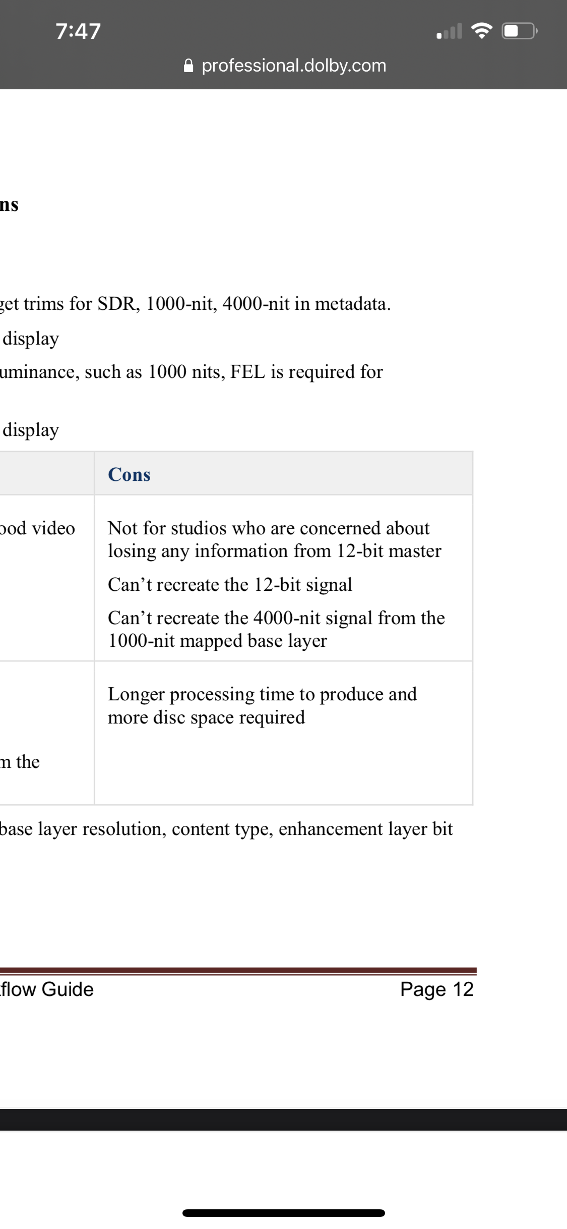

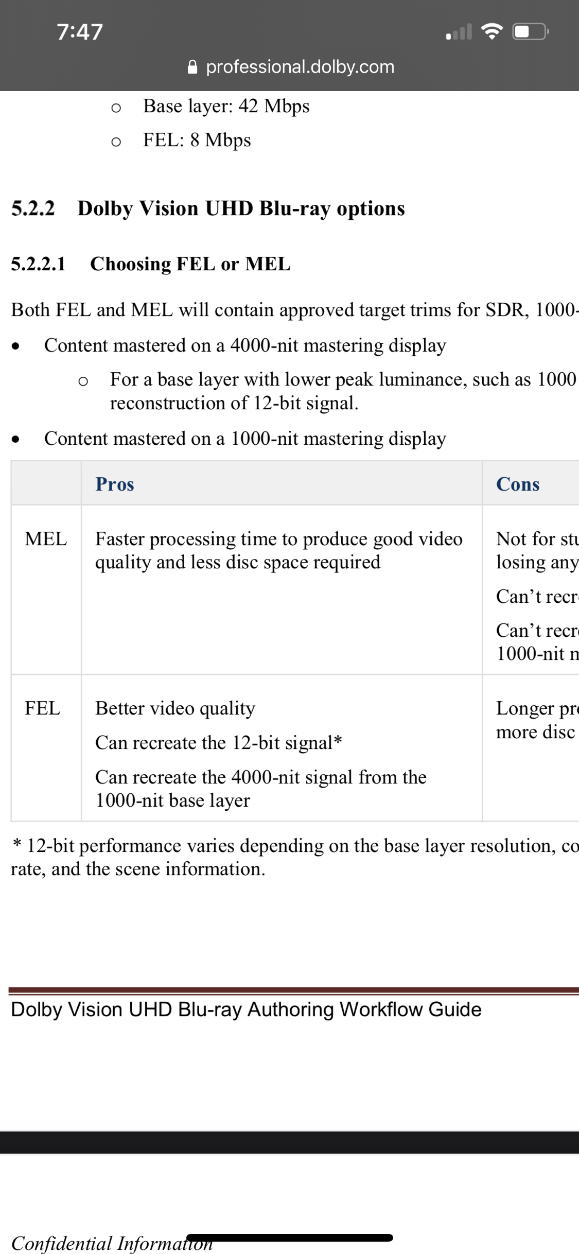

you want more ? here is an encore... :D
most folks here are forgetting that 12bit 422 ONLY ever comes into play for profile 7 FEL - not even profile 7 MEL (10bit 420).
All the gazillion other DV profiles are all 420 drained sauce for streaming. THIS is easily 90+% of DV content.
Then, for disc releases (--> profile 7), (unfortunately) the majority of releases are MEL... so 12bit 422 (--> p7 FEL) only rarely ever comes into play.
This may be another reason why in the many Dolby docs this is not explicitly stated, to not confuse content creators who in 9/10 cases will use single DV layer BL (for garbage compressed streaming), and even if authoring disc deliverables, then often use MEL.
Even some of the largest disc releases do not get DV or DV FEL (--> SW, only EVIII from Ryan Johnson is DV, but MEL). There are authoring issues with FEL when one gets into the 2nd and 3rd layers on the UHD disc, so that seems to be another huge obstacle.
again: p7 FEL tv-led is as good as it gets right now.

I see it now, thanks for pointing that out!
