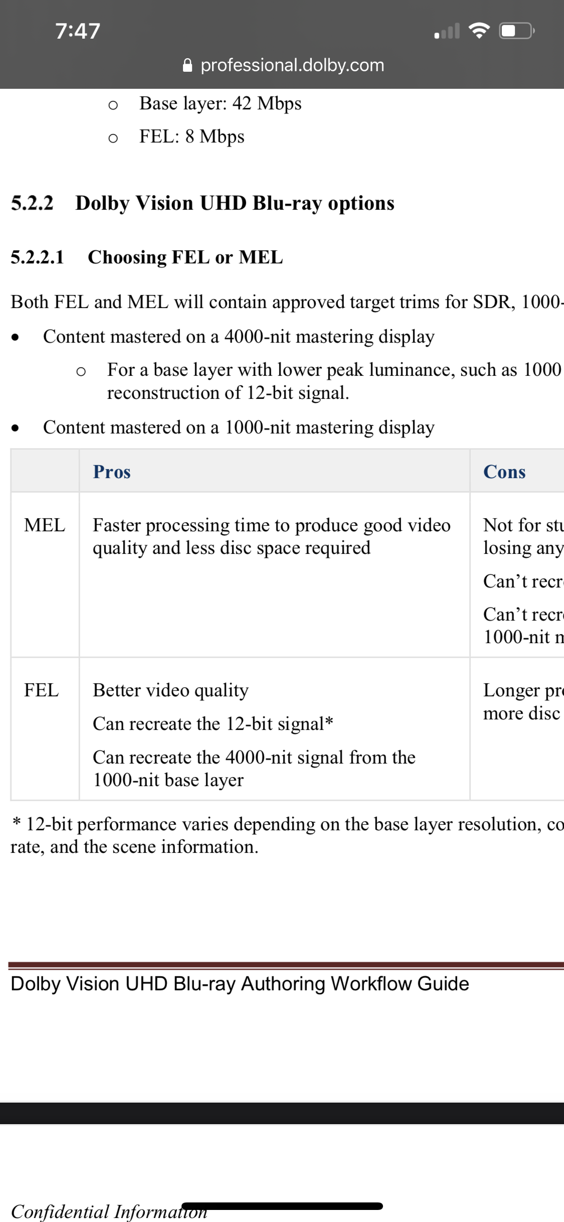

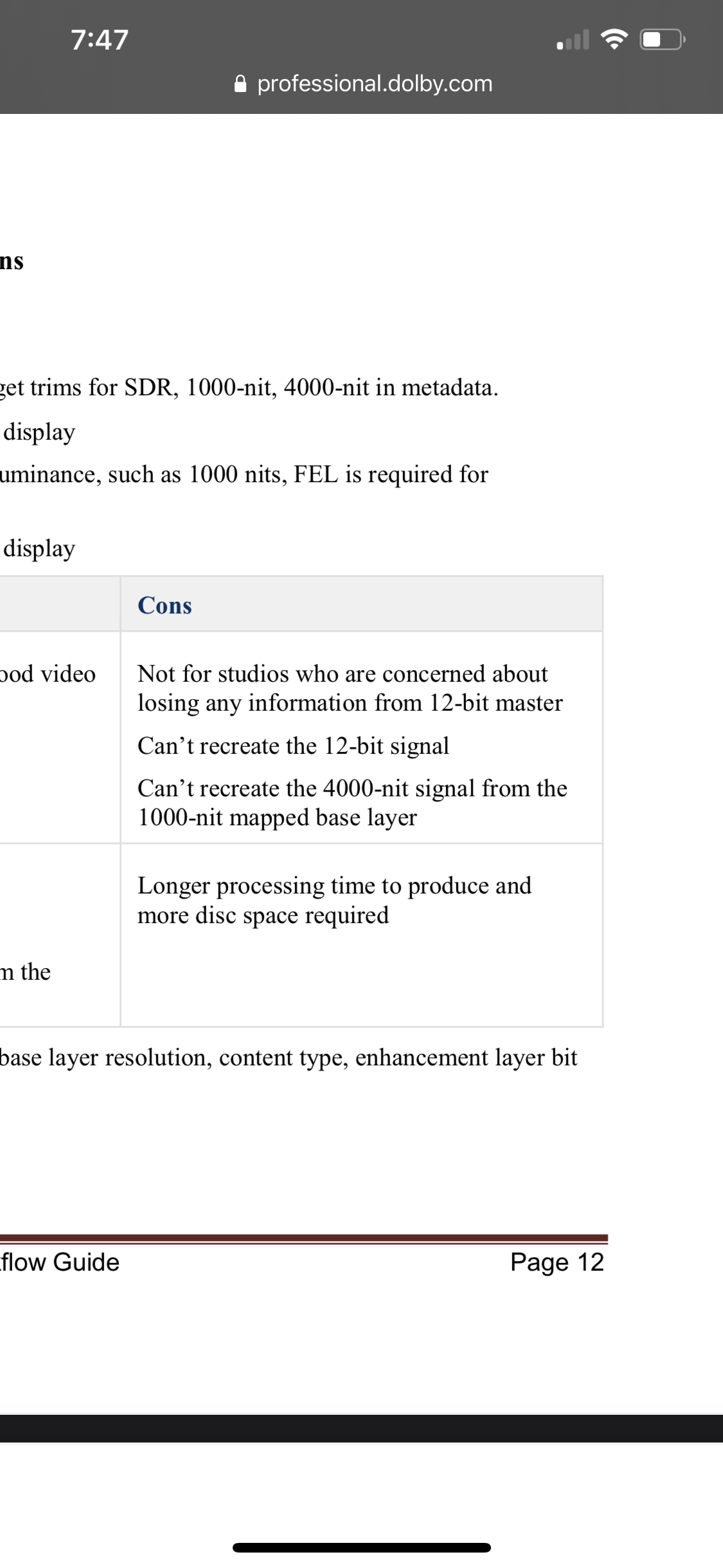

you want more ? here is an encore...DaMacFunkin wrote: ↑Wed Dec 23, 2020 6:58 amI’m off to get some popcorn for round 2, this is freakin’ awesome
most folks here are forgetting that 12bit 422 ONLY ever comes into play for profile 7 FEL - not even profile 7 MEL (10bit 420).
All the gazillion other DV profiles are all 420 drained sauce for streaming. THIS is easily 90+% of DV content.
Then, for disc releases (--> profile 7), (unfortunately) the majority of releases are MEL... so 12bit 422 (--> p7 FEL) only rarely ever comes into play.
This may be another reason why in the many Dolby docs this is not explicitly stated, to not confuse content creators who in 9/10 cases will use single DV layer BL (for garbage compressed streaming), and even if authoring disc deliverables, then often use MEL.
Even some of the largest disc releases do not get DV or DV FEL (--> SW, only EVIII from Ryan Johnson is DV, but MEL). There are authoring issues with FEL when one gets into the 2nd and 3rd layers on the UHD disc, so that seems to be another huge obstacle.
again: p7 FEL tv-led is as good as it gets right now.
and here's more...
there are only two (2) DV streams:
1) 8bit RGB via tunneling (for STD tv-led, as it contains both BL+EL data)
2) 12bit 422 for everything else (LLDV player-led, MEL, or single layer profiles)
IF (!) the actual max chroma subsampling was 420, then the 2nd stream variant above would only need to be 12bit 420 - there would be no need to use 12bit 422 (+ HDCP, hence you'd never use more bandwidth than needed).
MEL is just 10bit 420 anyways, all single layer profiles as well.
IF (!) profile 7 LLDV was 12bit 420 for FEL releases you could just use a 12bit 420 stream as LLDV carries no metadata (DV was already encoded by player).
But they specc'ed a 12bit 422 stream as LLDV for p7 FEL is a 12bit 422 signal.

Yes butpete19 wrote: ↑Wed Dec 23, 2020 6:03 amfirst off, nobody said 420 is "wrong" - that is your wording. 420 simply has less color resolution, hence 422 is more desirable.
Second, both STD and LLDV output a 12bit 422 signal yet only STD contains in addition the dynamic metadata because it's tv-led. so the player-led stream (already DV decoded) which also contains 12bit 422 signal requires less bandwidth, hence it provides low latency...
again, BOTH DV stream types contain 12bit 422 signal (because that's the Dolby spec), yet LLDV has less data than the other... only STD carries metadata in the stream, not LLDV.... hence your 2nd statement is also wrong.
to recap:
all DV streams are 12 bit 422.
only tv-led contains the full dynamic metadata, so full stream requirements, hence RGB tunneling in 8bit float container is used.
player-led requires less bandwidth because it contains less data (still 12 bit 422 signal).
MEL is also 12 bit 422 but only contains a 10bit 420 signal, padded.
and to stress this part:
you make it sound like that "explains" a 12bit 420 final output. no, the metadata allows to reconstruct the full 12bit 422 master, which is why it is a 12bit 422 signal.
if final output was 12bit 420 (so EL only contains luminance, Y difference) for FEL STD, they wouldn't need a 12 bit 422 stream, they'd use a 12bit 420 stream. Metadata is the mere difference, it doesn't need "extra" space on top of the difference, especially since it's encoded as well.
LLDV device processing,
Would still use the Fel data within the 12bit stream/device to produce the extra bits intended in final 12bit output.
LLDV still uses all the dv meta
(Intended to cut the signal meta transfer time between device & uhdtv ) atualize visual monitor processing time cause latency.
I say this because we can play a fel real uhd disc in LLDV is that producing a less imperfect image than the dv rgb8 FEL ?sending the meta I’m not sure 100% on that part of the equation.
Some do believe computation processing is best left to devices than the uhdtv.
So the real question is, is device processing better than uhd tv which each UhDtv tone maps differently producing different doblyvision picture baced on tv limitations
But is does make sense why Xbox won’t offer regular dv no good for gaming & we could see why sending dv dynamic meta rgb8 while playing a high intensity doblyvision game u could just visualize the laggg lol
When you’re doing conversions from a UHD disc to single layer, you’re going to lose data (neglible in MEL). There is currently not a lossless way from converting from double to single layer where the info in the EL is reencoded into the BL; any info in the EL is just being discarded. The issue complicates when you further force the single-layer product to profile 5. Original profile 5 videos are encoded in a different colorspace than UHD discs, and the current available conversion process is not doing any colorspace conversions. When a player encounters a converted profile 5 video, it will play it in the p5 (IPTPQc2) colorspace, but the file is still encoded in the original UHD profile 7 colorspace— leading to potential chromatic abberations. Streaming services don’t have this issue simply because their content is encoded in profile 5 to begin with. The BL in these content is completely different than the one found on UHD discs. For more reading on BLs, ELs, RPUs, and anything DV/HDR related, I would start here: https://forum.blu-ray.com/showpost.php? ... ostcount=4.aboulfad wrote: ↑Thu Dec 24, 2020 11:29 amHi,
