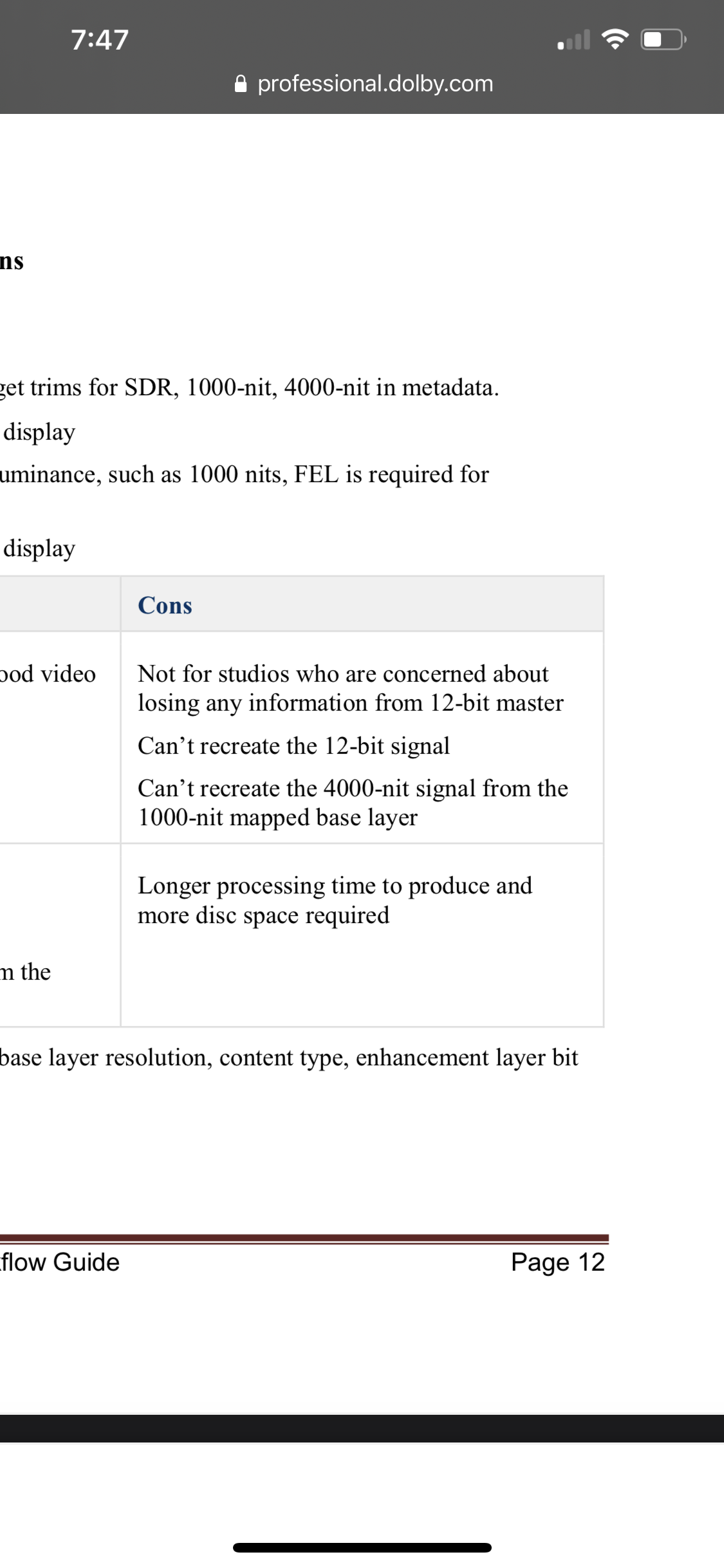

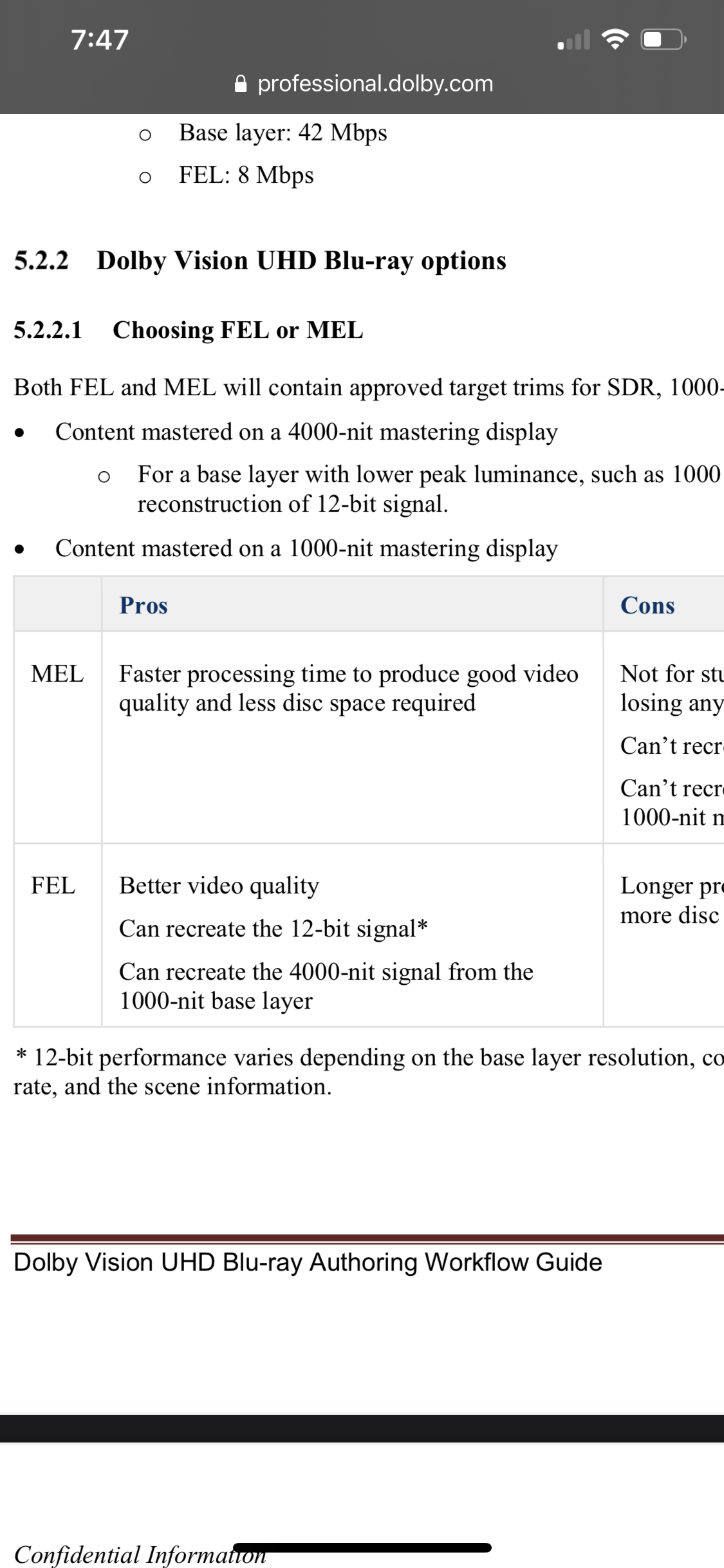

two main things about DV that are the reasons it is the premiere HDR format:
(1) ability to fully re-create the 12bit 422 master at home in FEL dual layer releases
(2) dynamic metadata

MEL is also 12 bit 422 but only contains a 10bit 420 signal, padded.
and to stress this part:
quietvoid wrote:
Tue Dec 22, 2020 10:49 pm
because the metadata is also transported into the least significant bits.
you make it sound like that "explains" a 12bit 420 final output. no, the metadata allows to reconstruct the full 12bit 422 master, which is why it is a 12bit 422 signal.
if final output was 12bit 420 (so EL only contains luminance, Y difference) for FEL STD, they wouldn't need a 12 bit 422 stream, they'd use a 12bit 420 stream. Metadata is the mere difference, it doesn't need "extra" space on top of the difference, especially since it's encoded as well.

most folks here are forgetting that 12bit 422 ONLY ever comes into play for profile 7 FEL - not even profile 7 MEL (10bit 420).
All the gazillion other DV profiles are all 420 drained sauce for streaming. THIS is easily 90+% of DV content.
Then, for disc releases (--> profile 7), (unfortunately) the majority of releases are MEL... so 12bit 422 (--> p7 FEL) only rarely ever comes into play.
This may be another reason why in the many Dolby docs this is not explicitly stated, to not confuse content creators who in 9/10 cases will use single DV layer BL (for garbage compressed streaming), and even if authoring disc deliverables, then often use MEL.
Even some of the largest disc releases do not get DV or DV FEL (--> SW, only EVIII from Ryan Johnson is DV, but MEL). There are authoring issues with FEL when one gets into the 2nd and 3rd layers on the UHD disc, so that seems to be another huge obstacle.
again: p7 FEL tv-led is as good as it gets right now.
