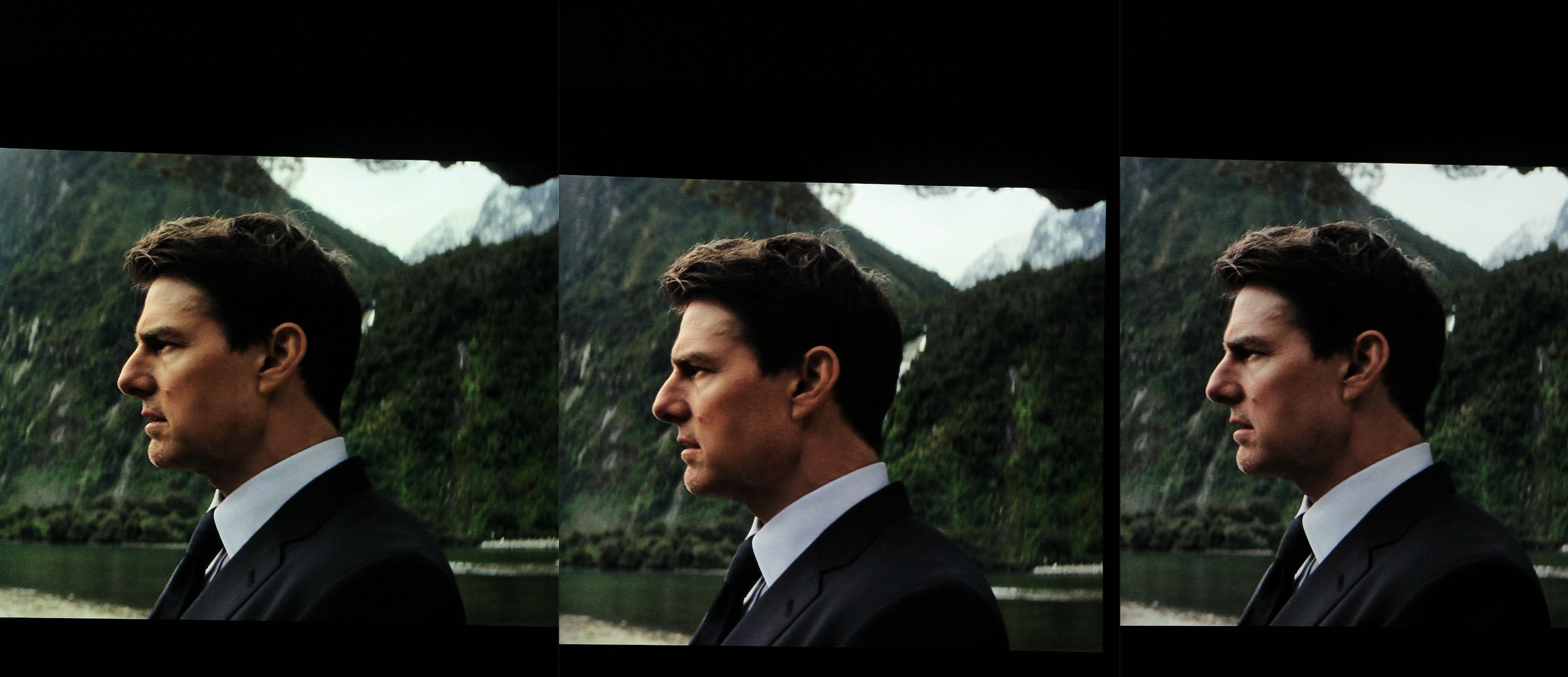

Hello everyone,
first I wanted to say a big THANK YOU to everyone so dedicated to get the DV playback riddle solved, first of all to yusesope, whose tool I've tried to use.
I've just had one UDH Bluray Disc (MI: Fallout), which I tried to get to run in DV after ripping it. With the help of yusesope's tool I was able to create an mp4 file which my LG OLED65GX9LA liked to play. I used the software and procedure described on p199 in this forum:
- ffmpeg to demux from BD m2ts file
- MUX_AND_CONVERT_TO_PROFILE_81.bat
- mp4muxer to get an .mp4 file
The file triggered DV on my LG TV, but I am not sure if it displayed the content correctly. That's why I would like to ask you more experienced people to take a look at my photo comparison (DSLR in manual mode). From left to right you see:
- MKV ripped with 1.15.3 from BD disc, played on my HiMedia Q10 Pro (which plays the file only in HDR10)
- same file, but played from my LG OLED65GX9LA with internal player via DLNA (which also plays it in HDR10)
- mp4-File created with the above procedure, played from my LG's internal player with active DV
Bildschirmfoto 2020-12-12 um 19.55.51.jpg (251.13 KiB) Viewed 25690 times
To me, the colors look quite different compared to the HDR10 variants of the movie. I do not have a hardware BD-UHD player to see how the movie would look like when played from there :-/
What are your thoughts on this?
In my expectation the colors should not differ between HDR10 and DV, right?

Pacer wrote:
Mon Dec 21, 2020 5:28 pm
Hello everyone,
The EL is a 10-bit video bitstream that carries the residual between the source and the BL and the “dynamic” metadata for DV. An enhancement layer that carries a residual signal is = 0 (zero), that is, the decoder does not need to process the residual signal, is called minimum enhancement layer (MEL). If the residual signal is > 0, it is called full enhancement layer (FEL)
MI Fallout is a FEL Dolby Vision movie. (BL + EL (>0) + RPU)
Making DV files in single layer profile works only with MEL (EL=0).
The only correct method to have dual layers files (or dual tracks of single layer) is with mp4muxer with Dolby Vision in profile 7.
