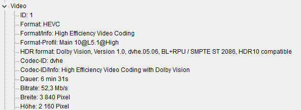

#3905 Post by agneva » Tue Dec 15, 2020 4:41 pm
shawnc22 wrote: Tue Dec 15, 2020 3:15 pm
Unless something changed, I believe DVDFAB strips away the EL in their DV MP4 conversion. You can verify this with mediainfo if you see only one video track that's labeled BL+RPU.
you can set it in dvdfap:
if you choose EL+RPU than you get it:
i just tested it with Saving Private Ryan, it has an FEL.
If I choose DV Single Layer for playback on my LG CX9 i get brightness pumping.
If I choose DV Dual Layer, the CX9 doesn´t play, but the LG UBK90 plays it correct.
I think all movies with empty EL (MEL) can be ripped in DV SL.
https://forum.blu-ray.com/showthread.ph ... st12116287
#3906 Post by RESET_9999 » Tue Dec 15, 2020 5:12 pm
agneva wrote: Tue Dec 15, 2020 4:41 pm
I think so, I don't see any difference between BL+RPU(profile 8 ) vs dual-track dual-layer MEL(profile 7) on my Sony x700
plus the MEL movies can also be re-encoded. Thank's to @quietvoid rpu extractor.
did you try with profile 8 ? i think DVDFAB still produces profile 5 file which is incorrect for HDR10 BL.
agneva
Posts: 61
#3907 Post by agneva » Tue Dec 15, 2020 5:45 pm
this makes DVDFab with DV SL, can´t be set.
How can I create Profile 8 with reencoded FEL ?
Of course you can´t see any difference between a empty (M)EL and no EL.
Private Ryan´s FEL is pumping when you look only the FEL on Media Player Classic, looks very strange :lol:
The quality is bad + brightness pumping if you watch it without FEL. The FEL is necassary.
I tried to watch, but after 20min i switched to HDR10.
Today I could convince myself from the real DV Version of Ryan :arrow: its very nice.

#3909 Post by RESET_9999 » Tue Dec 15, 2020 6:05 pm
agneva wrote: Tue Dec 15, 2020 5:45 pm 1.png
you have to use yusesope tools or demux your dvdfab mp4 file and then remux with the mp4muxer to profile 8.
https://www.makemkv.com/forum/viewtopic ... 970#p96282
you can't ''properly'' re-encode and preserve FEL.
You could re-encode to mel with @quietvoid rpu extractor + x265.exe
https://github.com/quietvoid/dovi_tool/ ... /0.1.0-fix
