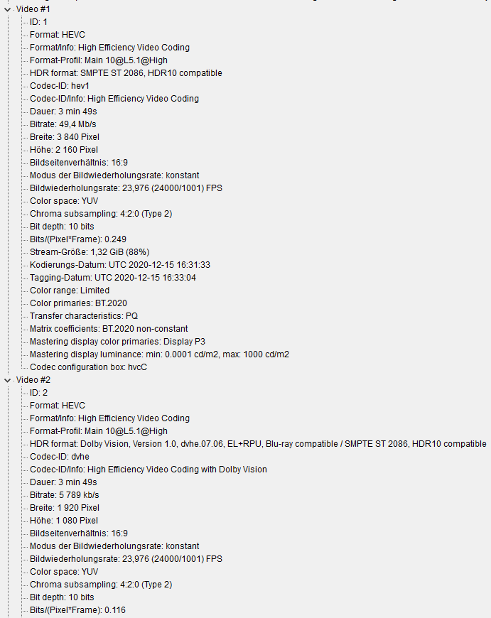

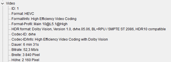

Unless something changed, I believe DVDFAB strips away the EL in their DV MP4 conversion. You can verify this with mediainfo if you see only one video track that's labeled BL+RPU.
you can set it in dvdfap:
if you choose EL+RPU than you get it:
i just tested it with Saving Private Ryan, it has an FEL.
If I choose DV Single Layer for playback on my LG CX9 i get brightness pumping.
If I choose DV Dual Layer, the CX9 doesn´t play, but the LG UBK90 plays it correct.
I think all movies with empty EL (MEL) can be ripped in DV SL.

I think so, I don't see any difference between BL+RPU(profile 8 ) vs dual-track dual-layer MEL(profile 7) on my Sony x700

did you try with profile 8 ? i think DVDFAB still produces profile 5 file which is incorrect for HDR10 BL.

this makes DVDFab with DV SL, can´t be set.

you have to use yusesope tools or demux your dvdfab mp4 file and then remux with the mp4muxer to profile 8.
