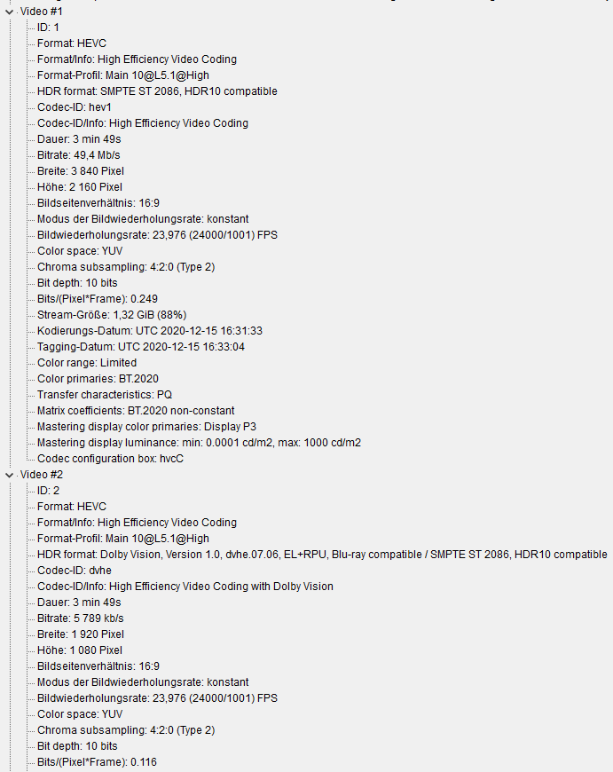

Unless something changed, I believe DVDFAB strips away the EL in their DV MP4 conversion. You can verify this with mediainfo if you see only one video track that's labeled BL+RPU.

you can set it in dvdfap:
if you choose EL+RPU than you get it:
i just tested it with Saving Private Ryan, it has an FEL.
If I choose DV Single Layer for playback on my LG CX9 i get brightness pumping.
If I choose DV Dual Layer, the CX9 doesn´t play, but the LG UBK90 plays it correct.
I think all movies with empty EL (MEL) can be ripped in DV SL.
https://forum.blu-ray.com/showthread.ph ... st12116287

agneva
Posts: 61
#3910 Post by agneva » Tue Dec 15, 2020 5:45 pm
this makes DVDFab with DV SL, can´t be set.
the MEL movies can also be re-encoded. Thank's to @quietvoid rpu extractor.
did you try with profile 8 ?
How can I create Profile 8 with reencoded FEL ?
Of course you can´t see any difference between a empty (M)EL and no EL.
Private Ryan´s FEL is pumping when you look only the FEL on Media Player Classic, looks very strange :lol:
The quality is bad + brightness pumping if you watch it without FEL. The FEL is necassary.
I tried to watch, but after 20min i switched to HDR10.

agneva wrote: Tue Dec 15, 2020 5:45 pm 1.png
you have to use yusesope tools or demux your dvdfab mp4 file and then remux with the mp4muxer to profile 8.
https://www.makemkv.com/forum/viewtopic ... 970#p96282

#3913 Post by shawnc22 » Tue Dec 15, 2020 7:07 pm
agneva wrote: Tue Dec 15, 2020 4:41 pm
shawnc22 wrote: Tue Dec 15, 2020 3:15 pm
Ah that's interesting. I didn't know that dvdfab can now produce the same results as mp4muxer and that the ubk90 can actually play these dual track files. Wonder if it can do the same with TS files
