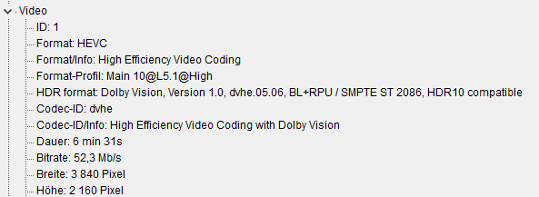

Post by shawnc22 »
Psnjerry wrote: Tue Dec 15, 2020 8:26 am
shawnc22 wrote: Tue Dec 15, 2020 6:34 am
Psnjerry wrote: Tue Dec 15, 2020 6:00 am
i seem to get the same results with yusesope tools and dvdfab when i make mp4 into a 2 stream to play on c9 default app, making a one stream gives you crushed blacks.
don't use yusecope's tools or dvdfab when making mp4s for c9 playback, use mp4muxer.
i meant mp4muxer. it looks the same to me but why you say i shouldn't use dvdfab?
Unless something changed, I believe DVDFAB strips away the EL in their DV MP4 conversion. You can verify this with mediainfo if you see only one video track that's labeled BL+RPU.

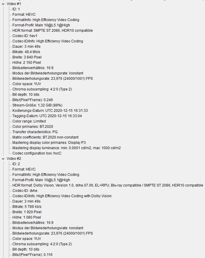

you can set it in dvdfap:
if you choose EL+RPU than you get it:
i just tested it with Saving Private Ryan, it has an FEL.
If I choose DV Single Layer for playback on my LG CX9 i get brightness pumping.
If I choose DV Dual Layer, the CX9 doesn´t play, but the LG UBK90 plays it correct.
I think all movies with empty EL (MEL) can be ripped in DV SL.
https://forum.blu-ray.com/showthread.ph ... st12116287

agneva wrote: Tue Dec 15, 2020 4:41 pm
did you try with profile 8 ? i think DVDFAB still produces profile 5 file which is incorrect for HDR10 BL.
agneva
Posts: 61
Post by agneva »
this makes DVDFab with DV SL, can´t be set.
the MEL movies can also be re-encoded. Thank's to @quietvoid rpu extractor.
How can I create Profile 8 with reencoded FEL ?
Of course you can´t see any difference between a empty (M)EL and no EL.
Private Ryan´s FEL is pumping when you look only the FEL on Media Player Classic, looks very strange :lol:
The quality is bad + brightness pumping if you watch it without FEL. The FEL is necassary.
I tried to watch, but after 20min i switched to HDR10.
Today I could convince myself from the real DV Version of Ryan :arrow: its very nice.
