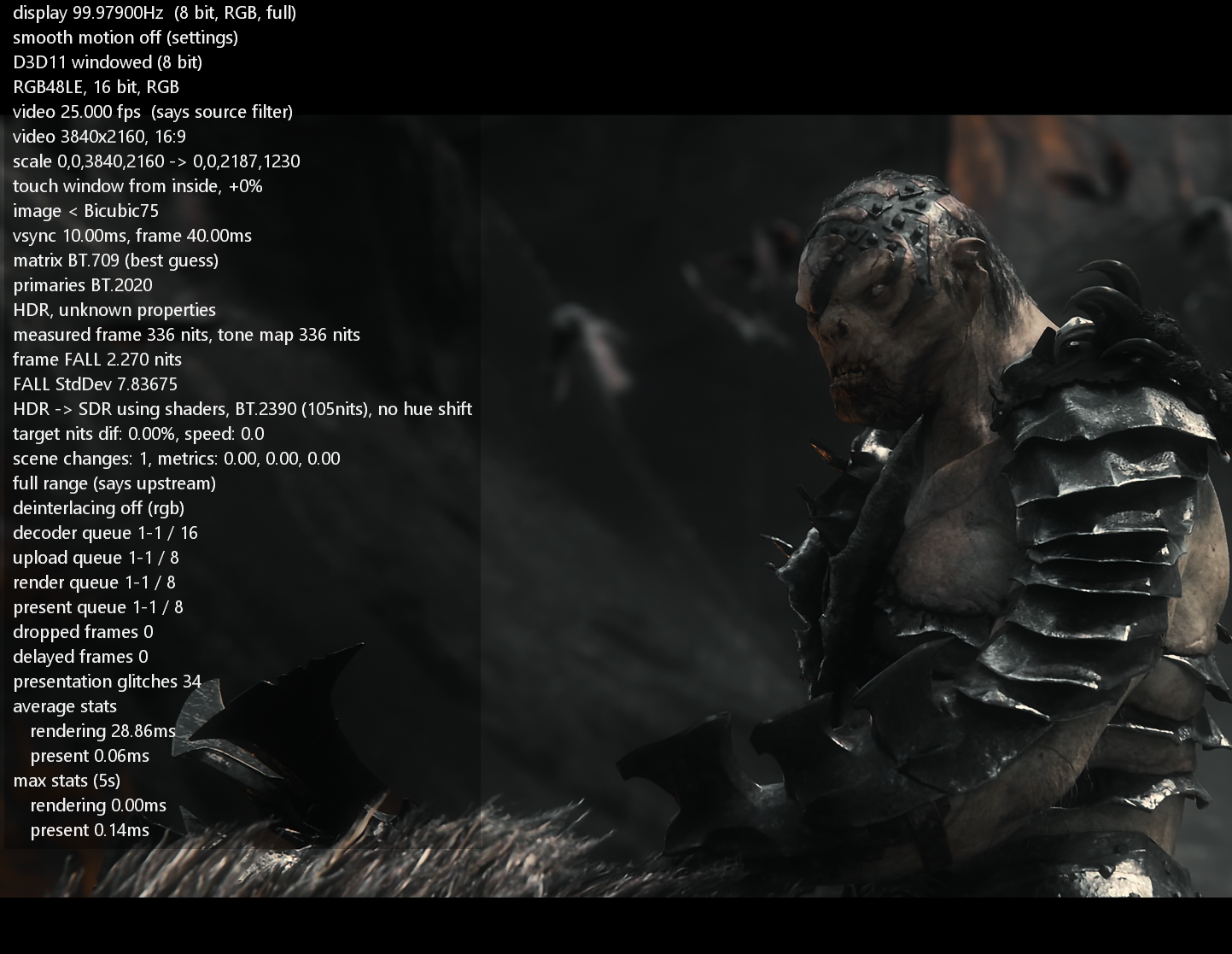

It’s also possible to produce a HDR/rgb4816bit.png for comparison as well from a LLDV not converted to SDR. Comparison results are the same for sdr/hdr where the shield is concerned. (Ffmpeg to take screenshots)
Without the vertex 2 altering video playback
Once u have the HDR10/rgb48.png
U can view in your hdr/sdr software eg Madvr. In which u can now take another sdr.png if u so desire.
LLDV-Hdr.rgb.png example in mad vr

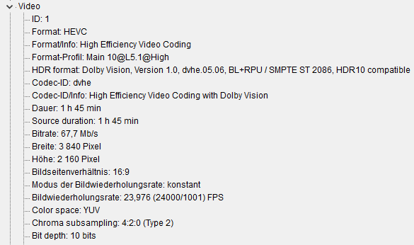

On my OLED77CX9LA i took dvdfap mp4 with DV SL -> perfect, because EL is empty.
I understood that you can every movie make a mp4 which has an empty EL (called MEL).
"Saving Private Ryan" doesn´t work correct with DV SL,the brightness pumps :oops:
I´ll try it this week on the UBK90 with DV DL :roll:
It has a FEL.
I don´t know a player how can play mkv with DV DL.

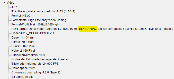

pete19 wrote: Thu Dec 03, 2020 1:29 pm @jcdr428:
I used latest tsmuxer w64-nightly-2020-11-17--01-21-46 and muxed the first 3 mins of a UHD DV disc folder rip to a BMV folder and a m2ts file. Selected the BL + EL, Dolby Atmos audio and then muxed.
When playing back on LG CX via Oppo, DV and Dolby Atmos are triggered correctly on both muxed versions, but the muxed versions are always a little bit darker than the original disc.
Is this a known limitation or is there a setting that I'm missing ?
I took screenshot comparisons and also switched the order of the versions when played back to ensure it's not the LG dimming. Every time the muxed versions are a little bit darker.
Looking at mediainfo, the only difference I can see is in the HDR FORMAT tag of the EL of the m2ts mux:
original disc:
HDR format : SMPTE ST 2086, HDR10 compatible
muxed BDM folder
muxed m2ts
HDR format : Dolby Vision, Version 1.0, dvhe.07.06, EL+RPU, Blu-ray compatible / SMPTE ST 2086, HDR10 compatible
see screenshot comparison here: https://screenshotcomparison.com/comparison/8739
(ignore blown out highlights, this is a camera setting issue)
Thx
I just tested a full movie remux (not just a 3 mins trim) via tsmuxer of LOTR UHD HDR Disc 1, and there is no brightness change in full tv-led DV of these remuxes - so it seems the trim introduced the brightness loss.
