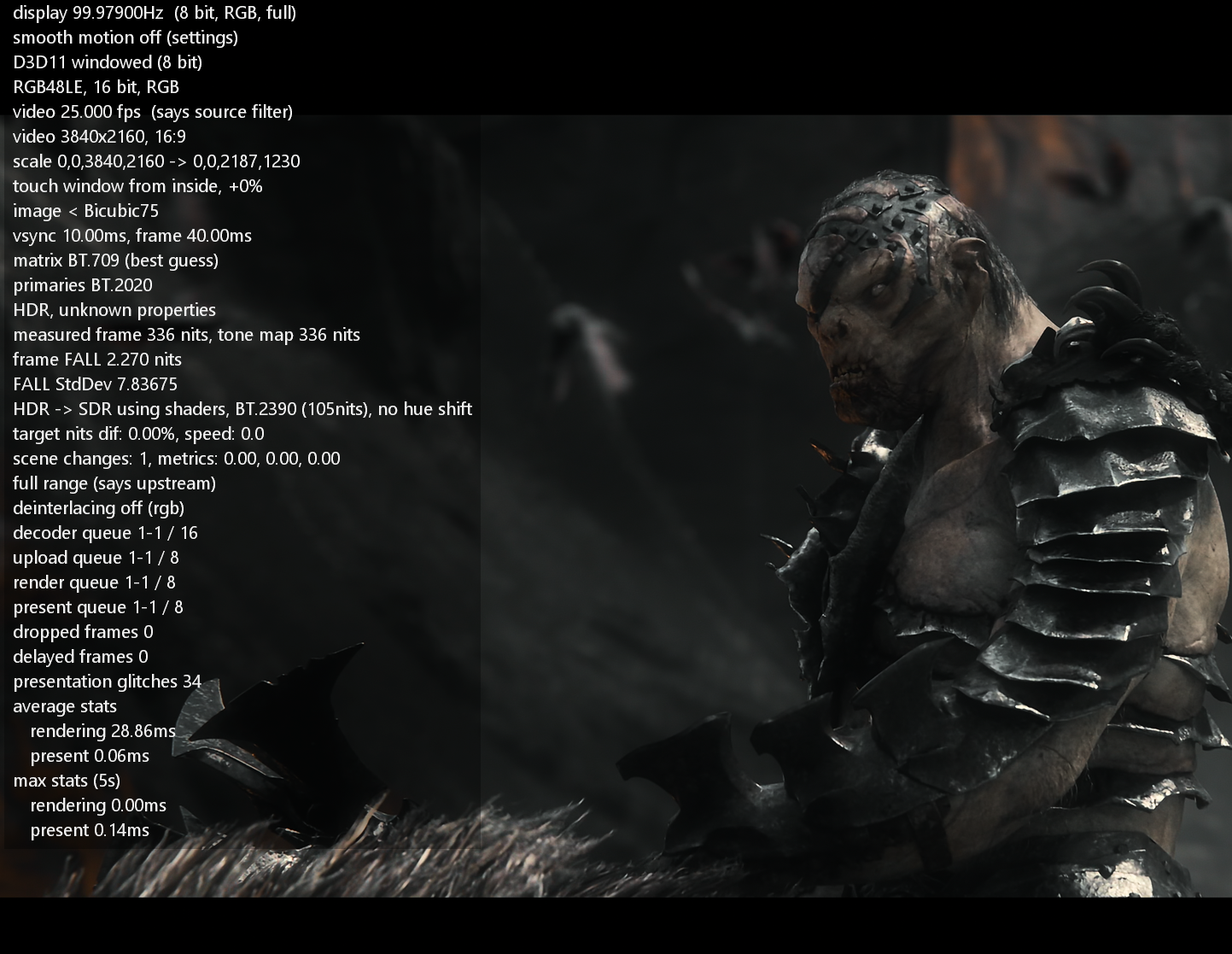

RESET_9999 wrote: Thu Oct 08, 2020 2:57 am a friend of mine(thank's manix) provided me two samples tone mapped to SDR from Dolby Vision made using a capture card (pro-res HQ) and the vertex 2 which allow the DV tone mapping.
could you explain your process in detail how the vertex 2 and capture card are being used to do get the screenshots ?
I'm assuming you're employing LLDV/player-led DV which the vertex then converts to SDR for the capture card to then grab a frame ?
which capture card are you using ?
Thx
Post by Manixx2020beyound » Sun Dec 13, 2020 1:27 pm
It’s also possible to produce a HDR/rgb4816bit.png for comparison as well from a LLDV not converted to SDR. Comparison results are the same for sdr/hdr where the shield is concerned. (Ffmpeg to take screenshots)
Without the vertex 2 altering video playback
Once u have the HDR10/rgb48.png
U can view in your hdr/sdr software eg Madvr. In which u can now take another sdr.png if u so desire.
LLDV-Hdr.rgb.png example in mad vr

Post by RESET_9999 » Sun Dec 13, 2020 3:15 pm
pete19 wrote: Sun Dec 13, 2020 4:17 am
Thx
@Manixx2020beyound did the capture.
He's using the Atomos Shogun with the pro-res HQ 422 PQ codec. The Hdfury Vertex 2 was used to force LLDV from the player because you need a decoded DV 422 signal to be able to capture it in PQ.
If your TV was receiving LLDV by default, then it could be done without the Vertex. Also, any capture card that supports pro-res HQ or any PQ codec can capture a LLDV signal in PQ.
So in fact, those comparisons had double tone mapping: Tone mapped / Captured to HDR10 PQ, then tone mapped to SDR with madVR using exactly the same setting. 1 or 2 tone mapping doesn't change the result, the red push is still here on the Shield no matter how many times we tone map it. We did the comparison in SDR because we can see more of the red push this way.
Plus even if we can't capture the default RGB DV signal, we all know the red push issue affects both DV modes. I can clearly see the issue on my RGB DV setup.
I hope you understand what I'm trying to say, my English is not so great.
FYI here's the PQ comparison:
RGB 16 bit PQ (straight lossless PQ png from the capture card):
https://screenshotcomparison.com/comparison/8996
https://slow.pics/c/iMHMpi2T
lossless RGB 16 bit PQ png:
https://mega.nz/file/HOI23ToA#VzdEzYByu ... CEAsDO2-b4
https://mega.nz/file/rCZQlZza#Kvbp0XTsk ... fqMFFvzDyc
***these png can be viewed in HDR10 passthrough if you open them in MPC-HC / MPC-BE + madVR
if you want to take a look at the pro-res MOV (14gb for 3min), I can give you a private link by PM.

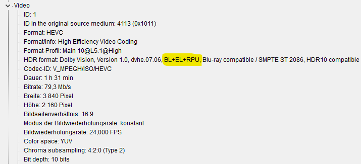

Post by pete19 » Mon Dec 14, 2020 11:33 am
pete19 wrote: Thu Dec 03, 2020 1:29 pm @jcdr428:
I used latest tsmuxer w64-nightly-2020-11-17--01-21-46 and muxed the first 3 mins of a UHD DV disc folder rip to a BMV folder and a m2ts file. Selected the BL + EL, Dolby Atmos audio and then muxed.
When playing back on LG CX via Oppo, DV and Dolby Atmos are triggered correctly on both muxed versions, but the muxed versions are always a little bit darker than the original disc.
Is this a known limitation or is there a setting that I'm missing ?
I took screenshot comparisons and also switched the order of the versions when played back to ensure it's not the LG dimming. Every time the muxed versions are a little bit darker.
Looking at mediainfo, the only difference I can see is in the HDR FORMAT tag of the EL of the m2ts mux:
original disc:
HDR format : SMPTE ST 2086, HDR10 compatible
muxed BDM folder
muxed m2ts
HDR format : Dolby Vision, Version 1.0, dvhe.07.06, EL+RPU, Blu-ray compatible / SMPTE ST 2086, HDR10 compatible
see screenshot comparison here: https://screenshotcomparison.com/comparison/8739
(ignore blown out highlights, this is a camera setting issue)
Thx
I just tested a full movie remux (not just a 3 mins trim) via tsmuxer of LOTR UHD HDR Disc 1, and there is no brightness change in full tv-led DV of these remuxes - so it seems the trim introduced the brightness loss.
