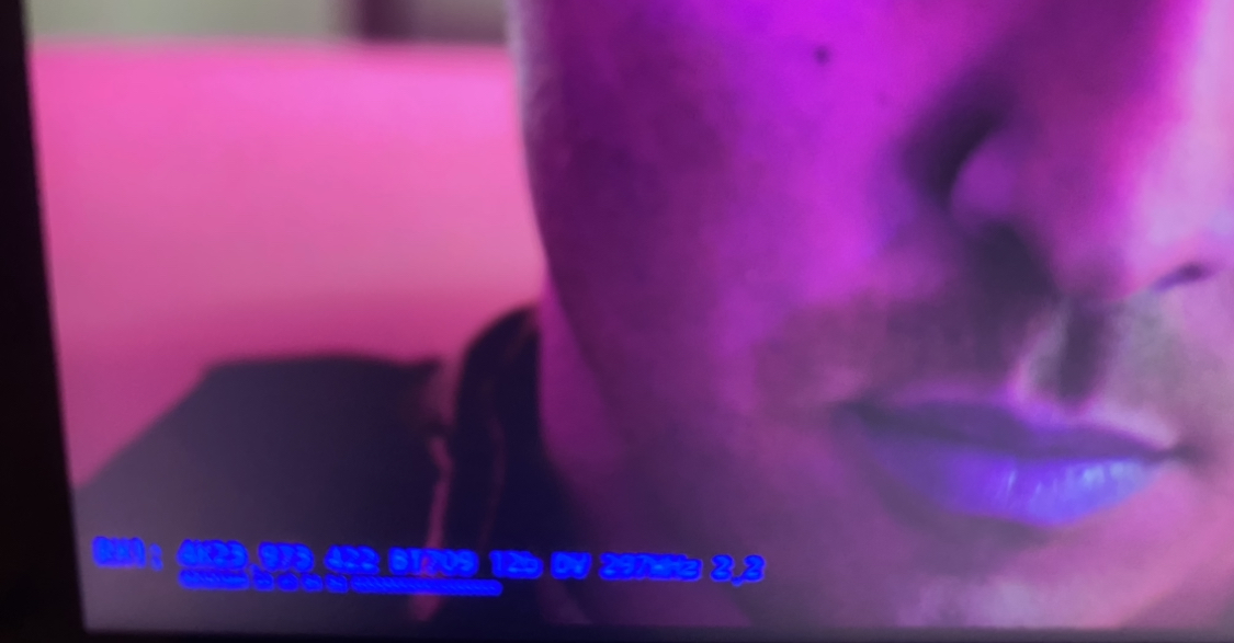

I have a LG CX and Oppo 203 and want to know if the DV signal displayed by the LG CX is tv-led or player-led.
How can I get that info ?
Thx.

The Oppo can be set to player led or tv led for Dolby vision in the hdr settings.

DaMacFunkin wrote: Sat Dec 05, 2020 6:55 am The Oppo can be set to player led or tv led for Dolby vision in the hdr settings.
yes, I know that. But I want to leave on AUTO and see what DV type (tv-led or player-led) it sends depending on the media it plays back
is there any way to get that info ?

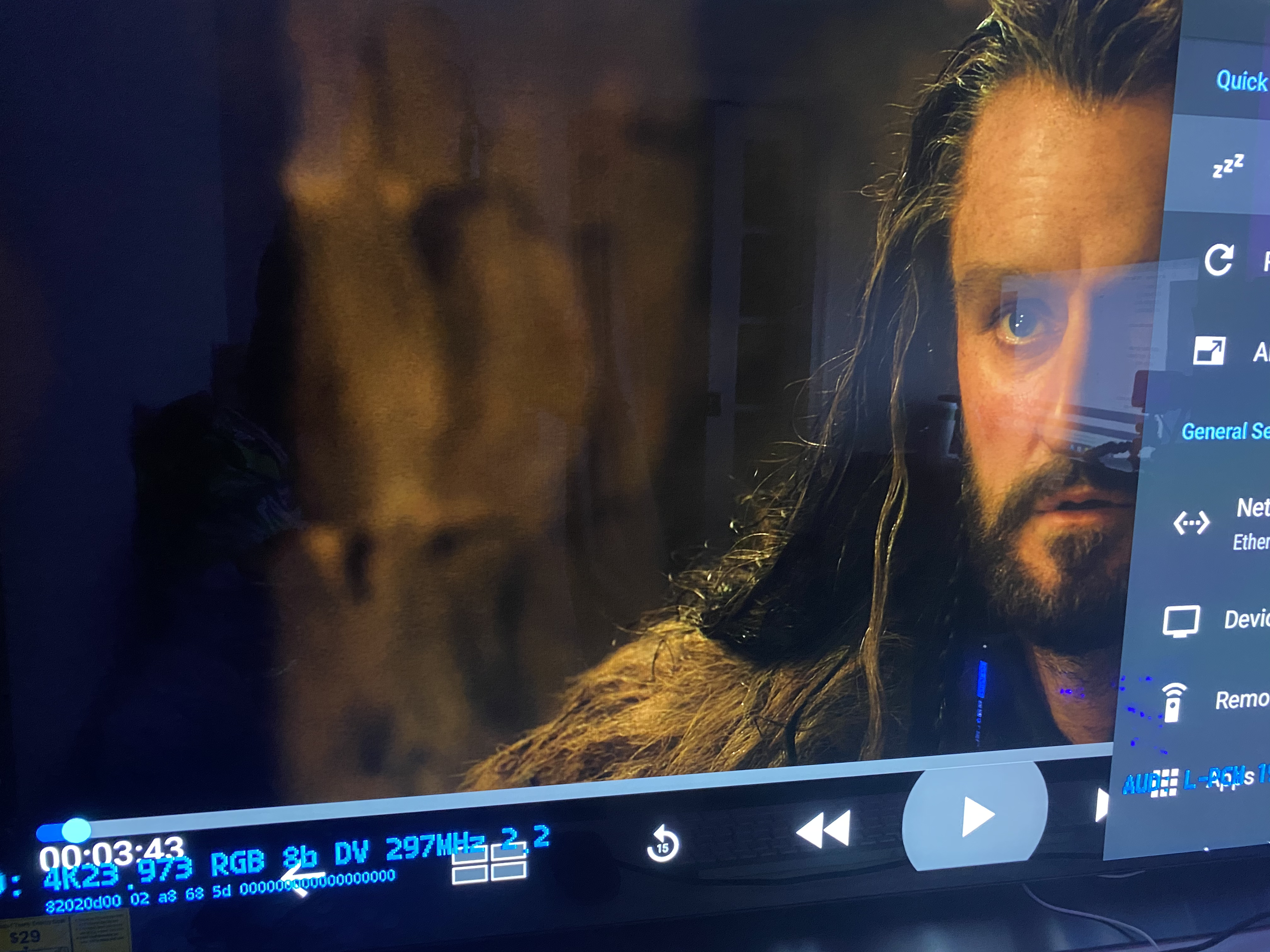

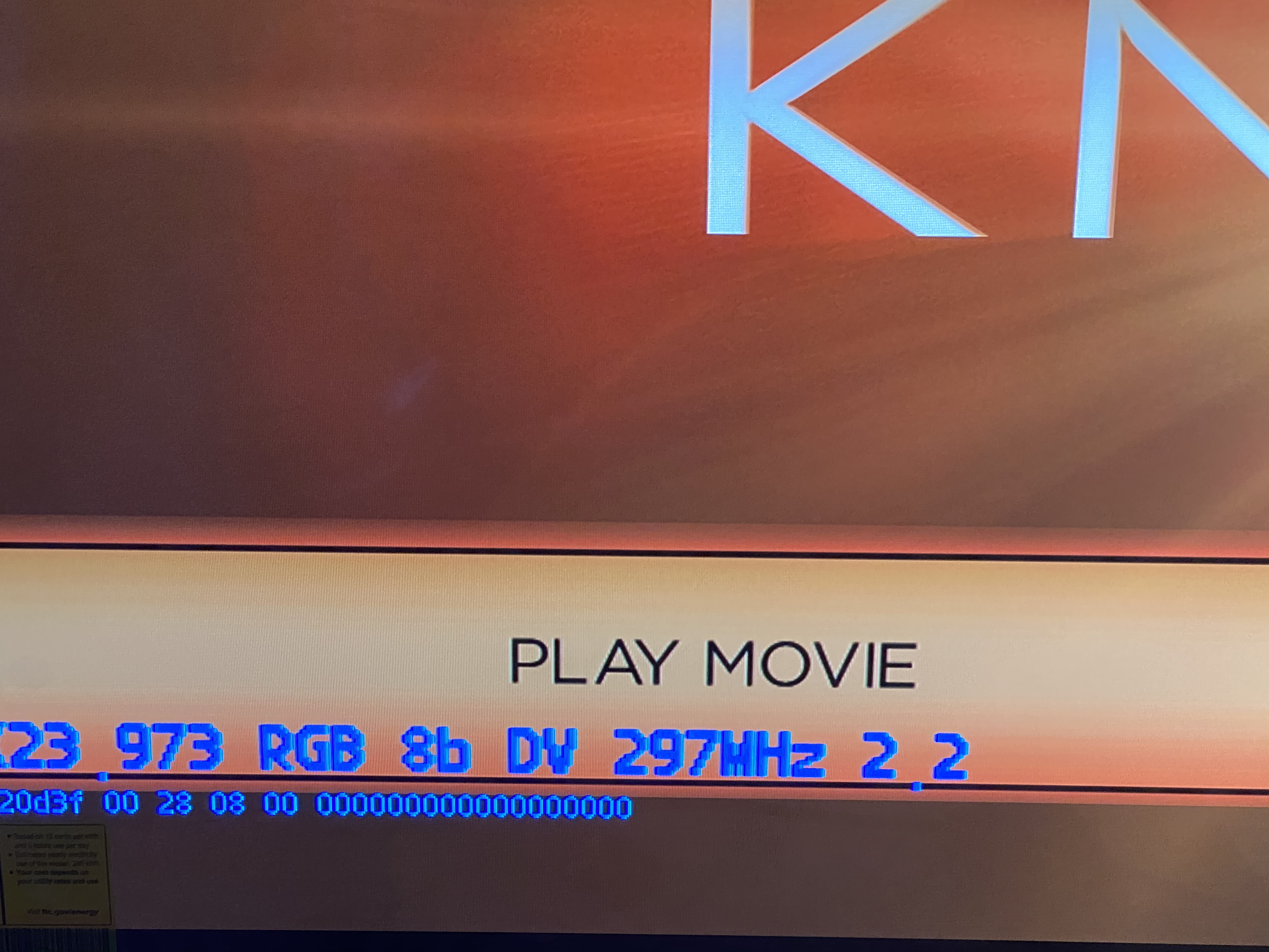

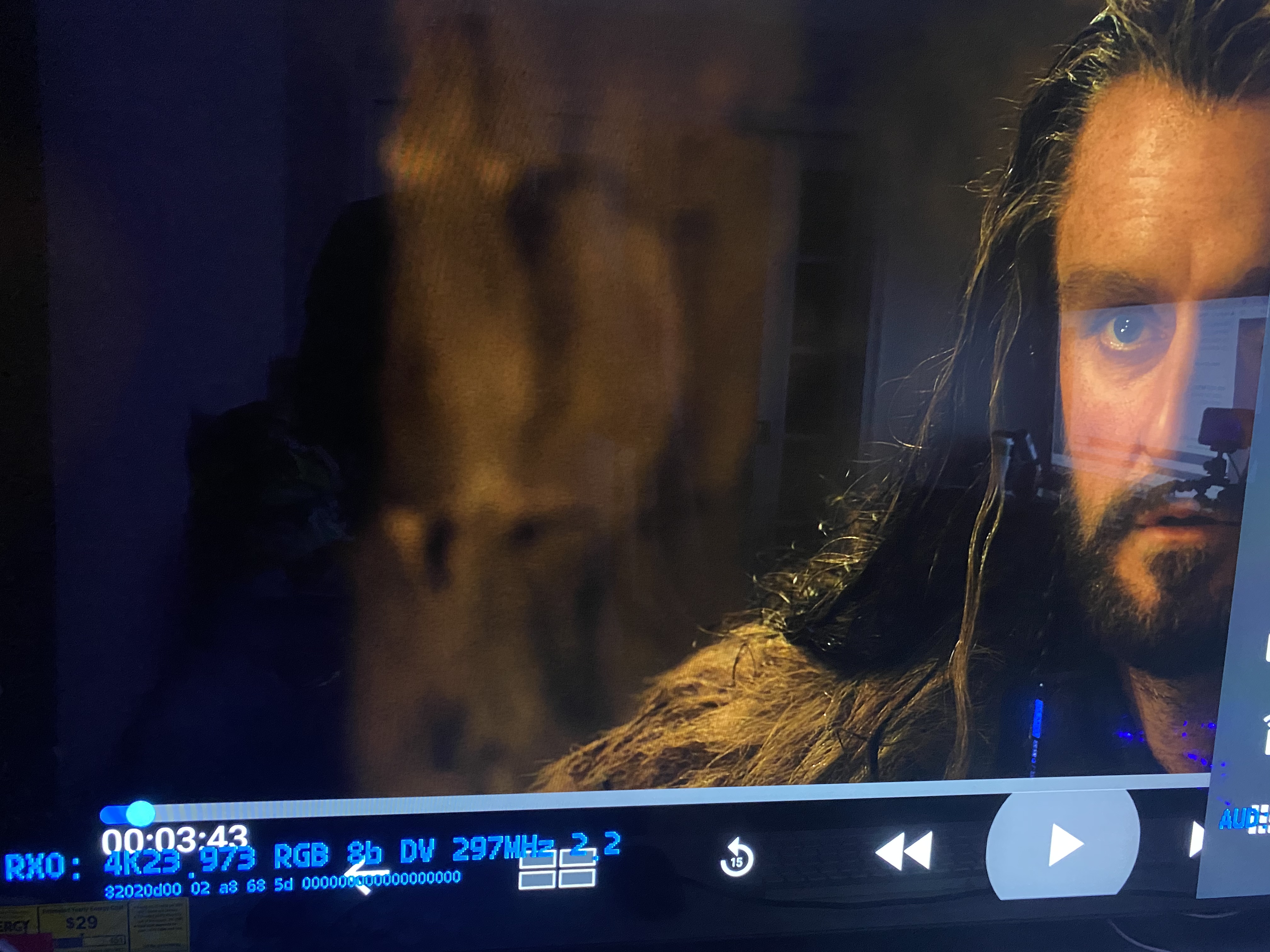

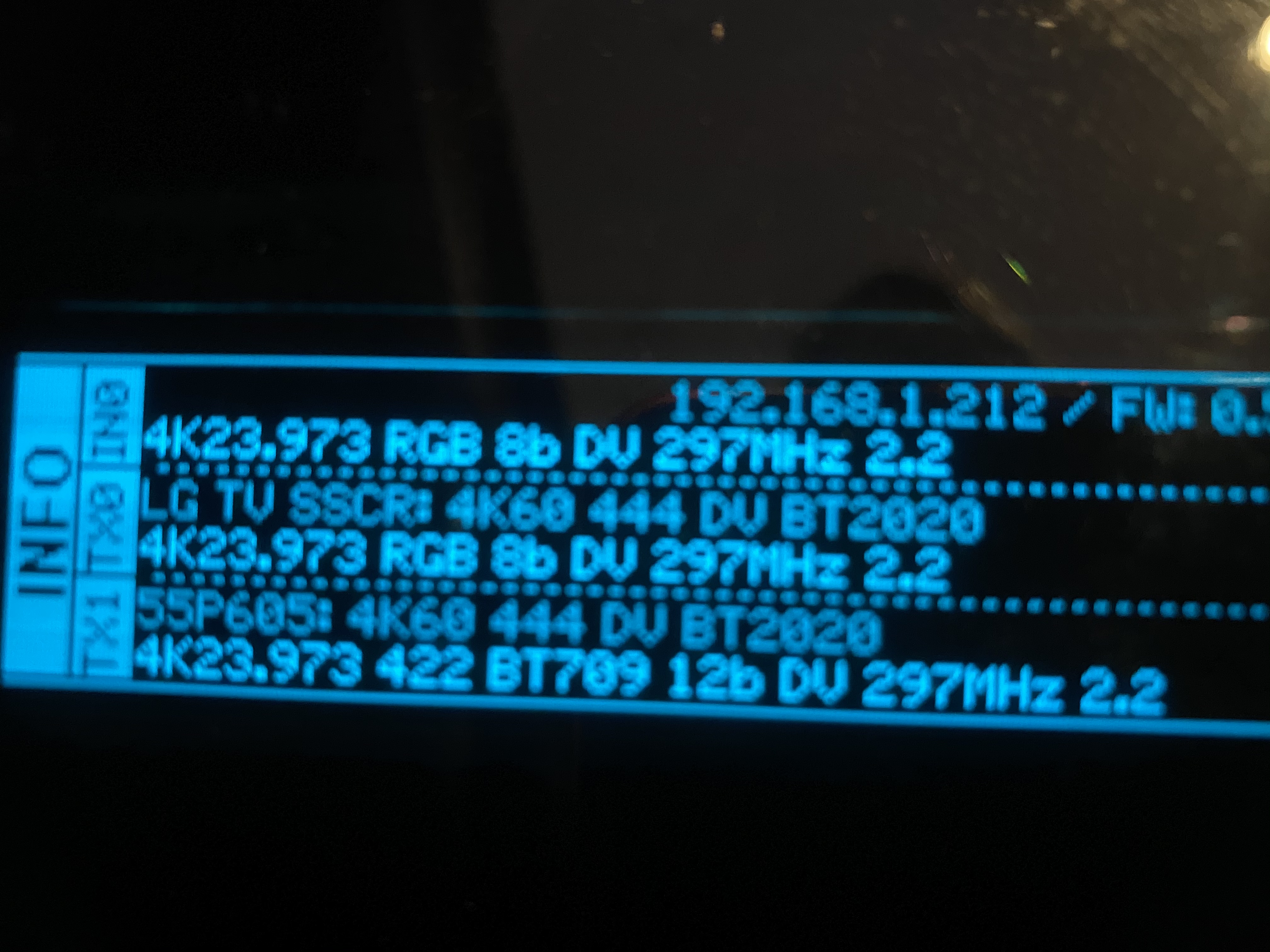

shawnc22 wrote: Fri Dec 04, 2020 9:21 pm Image
Still RGB 8bit here on my B9. Latest 5.0 firmware on the TV and 8.2.1 on the Shield experience. Tested with both UHD disk backup DV and Netflix DV.
Could you tell me how to access this menu on my CX?

Post by shawnc22 » Sat Dec 05, 2020 6:36 pm
magnetoeric wrote: Sat Dec 05, 2020 4:17 pm Could you tell me how to access this menu on my CX?
http://ltroyalshrimp.com/how-to-get-int ... tics-menu/
