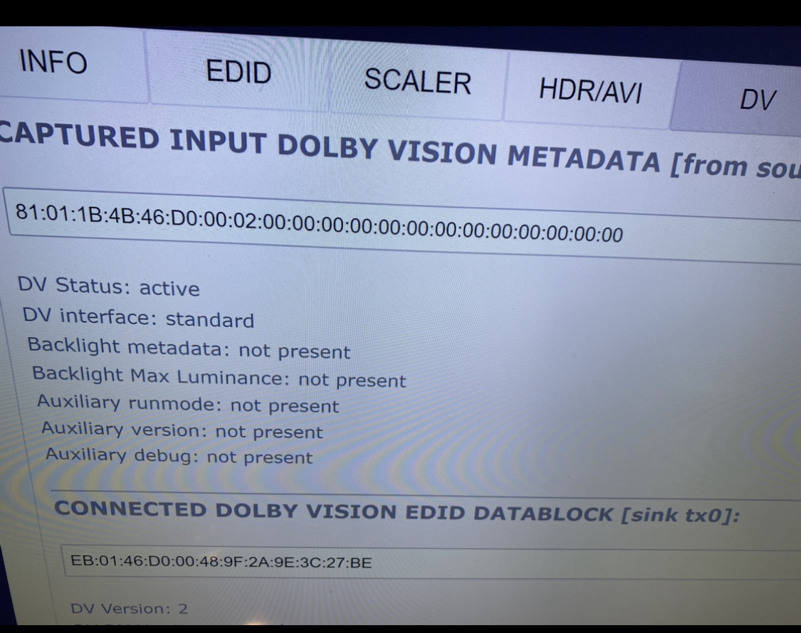

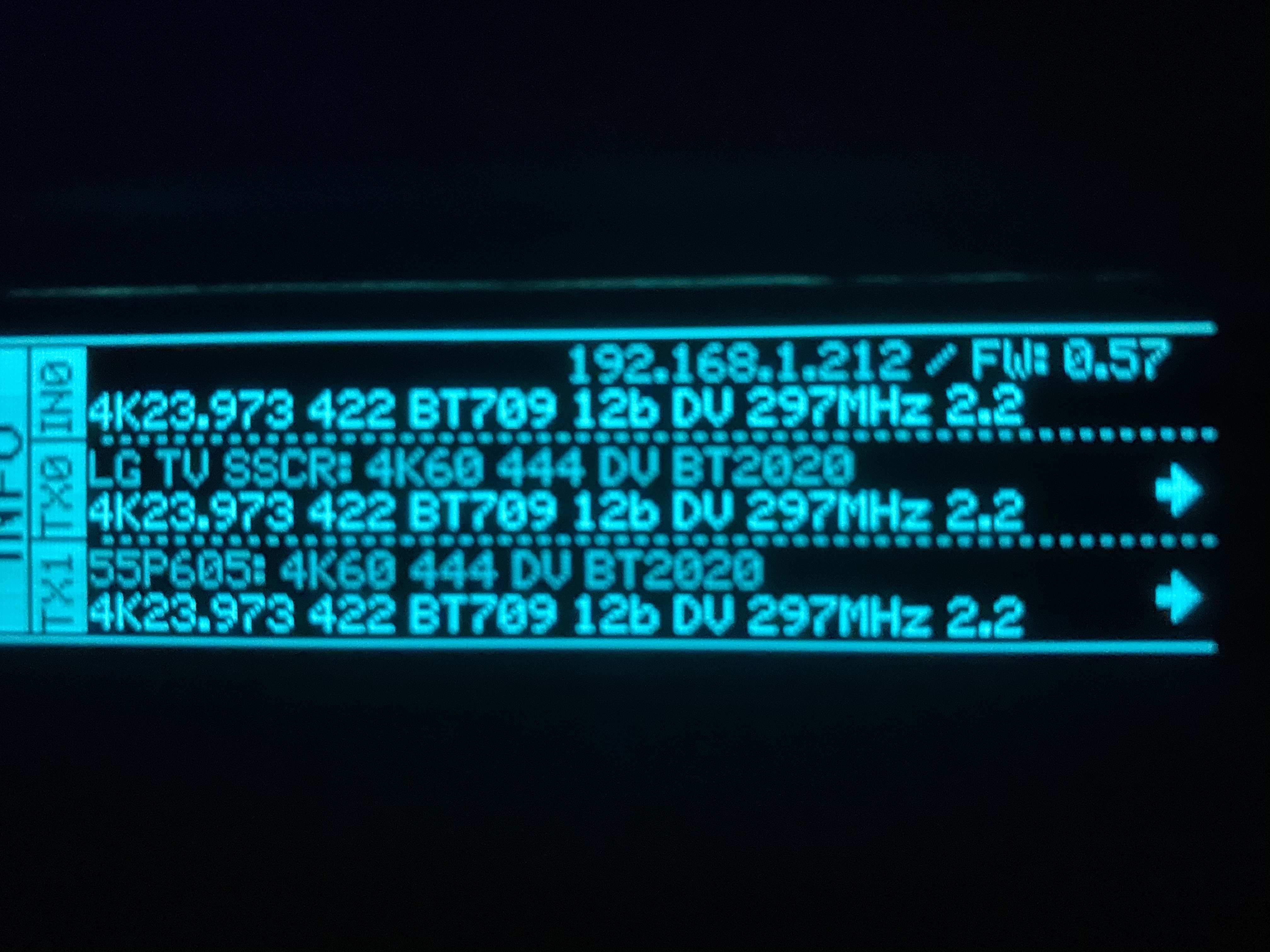

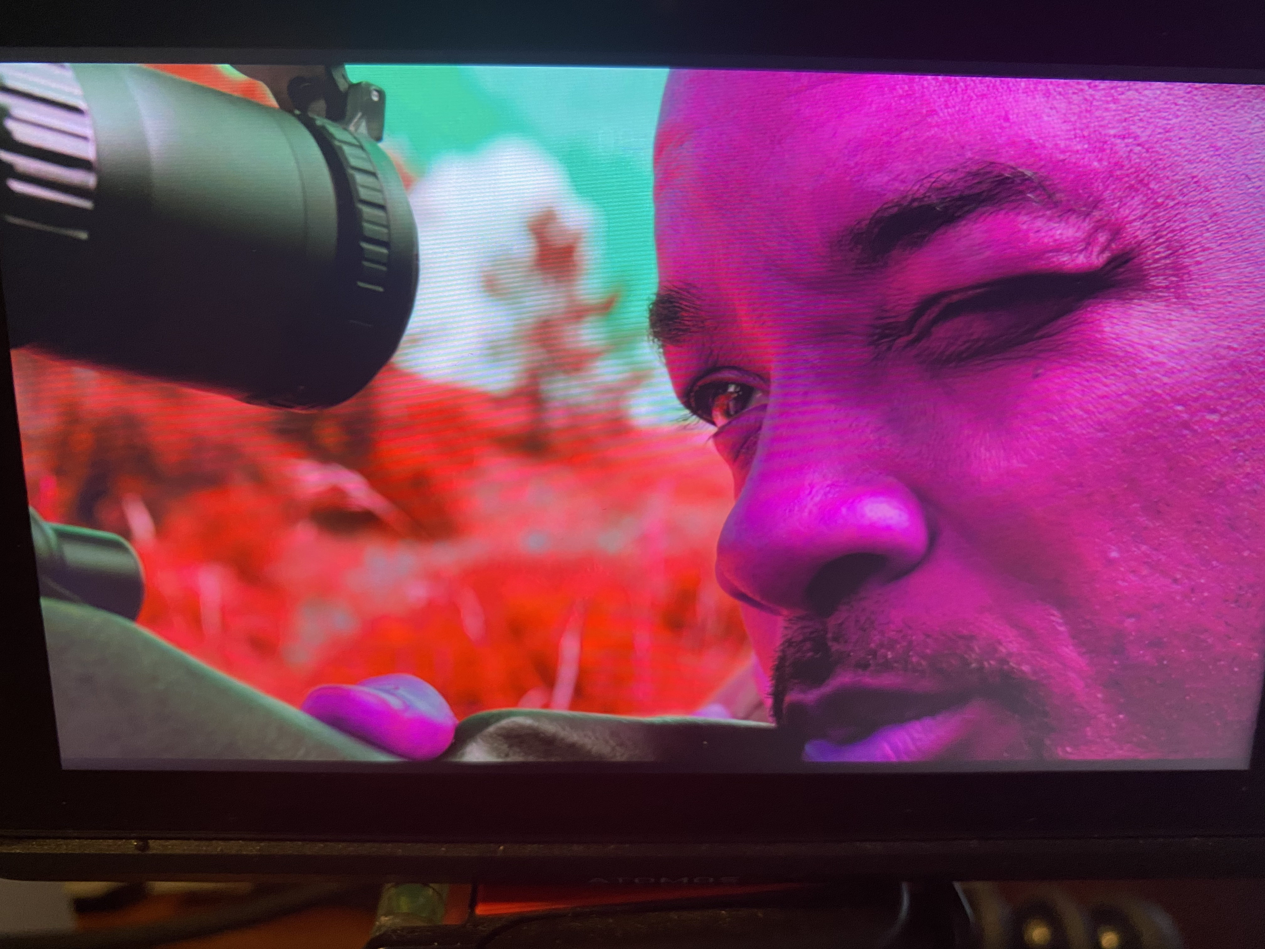

Post by Manixx2020beyound » Fri Dec 04, 2020 6:47 pm
Standard dv setting
Standard dv setting
Standard dv setting
Standard dv setting
There was an update a few days ago to LGCX
The shield is sending LLDV only to the CX10
When u try & get default DV RGB8 no GO
U only get it to playback in 12bit 709 DV
Pink colors but only on the CX I also have a doblyvision vizo & tlc 6 doblyvision connected all at the same time & ONLY the CX can’t read the dv 422 709 dv being outputed from the shield.
This could be the vertex2 fault.
So I did the same with the sony X700
I use LLDV so much I had to force my Sony to play back to regular dv by selecting rgb in settings.
Vertex says dv rgb8 on lg/CX
So something is wrong with the shield & CX
Not communicating properly.
Could also be that I don’t have the latest firmware on the vertex2 for the cx-edid
There is b9 & c8 edid but none for the CX on my firmware.
So I’m going to try my atmos player & see what it reads the shield tv directly to tv
Yep something is wrong with the shield no dv8 bit rgb
Can someone ellse try c8 & 9
My onkyo receiver won’t connect to my shield as well or pass the signal true
Don’t know if it’s 2.1 doing this
Now I’m going to take the CX out from the tv equation completely.
See if I get dv-rgb 8 latest shield firmware.
Colors u get on a none doblyvision set<br />CX does not show file while tlc&amp; vizo plays in doblyvision.
CX does not show file while tlc& vizo plays in doblyvision.
Vertex2 reading
Vertex2 reading
