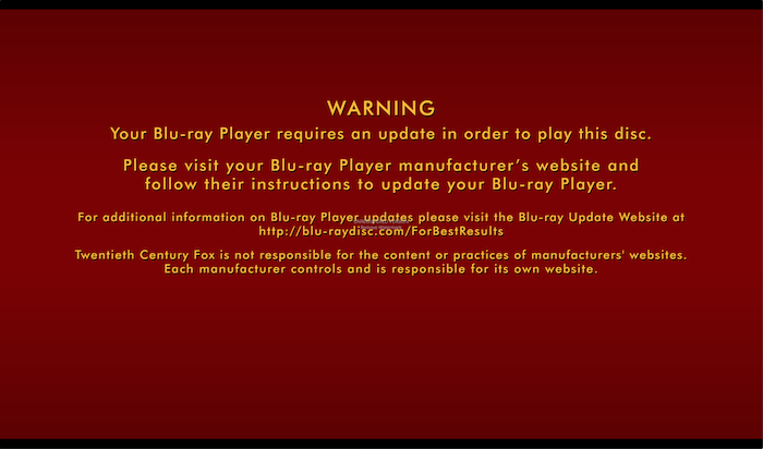

Apparently this problem has never been fixed, but not sure ... I am on a MAC so I got limited options for video tools. I got the Alien Anthology - really beautifully mastered Blu-rays with all the scary Alien movies. MakeMKV zipped thru them and produced a seemly good backup copy, and the individual .m2ts files seem to be properly decrypted. However, trying to play the backup with Blu-ray Player Pro gives me the " red screen of death"
Screen Shot 2020-11-13 at 4.57.36 PM.png (121.65 KiB) Viewed 32635 times
but if actually stick the blu-ray in the drive, Blu-ray Player Pro works fine - though it briefly shows the same (?) message above with a black background and white letters for a second or so, and moves on to show all the pretty menus. Seems that they have a mechanism to detect if I disk has been decrypted it becomes impossible to play it thru the menus.
