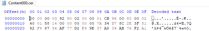

I first created a dump of a BD with MPF (media preservation frontend) that was reported as successful. Then I mounted it using DaemonTools and pointed MakeMKV towards the virtual drive to convert it into MKV files.
MakeMKV failed to open it. I then checked the BEE flags and the first two bytes were all zero. So even though it has AACS v16 it should have worked, right?
But instead MakeMKV showed an error about the host certificate being revoked by the drive. Which I'd be surprised by the DaemonTools virtual drive actually having done.
(I don't have a LibreDrive yet, but as far as I understood it, at worst I'd have ended up with an BEE encrypted image but as it isn't it should have been accessible by MakeMKV, right?)

- Content000.cer HEX

Hi what section is missing? I thought it was the keys for the Bus Encryption which would show up as the first bit of the second byte of the /AACS/Content000.cer being set to 1 (BEE enabled). And libre drive would allow one to read the raw disk without the drive encrypting it where that bit then would be set to 0 (BEE disabled).
Is there more? What else is redumper (which is what the MPF tool uses by default) leaving out? Would Aaru include that part?
