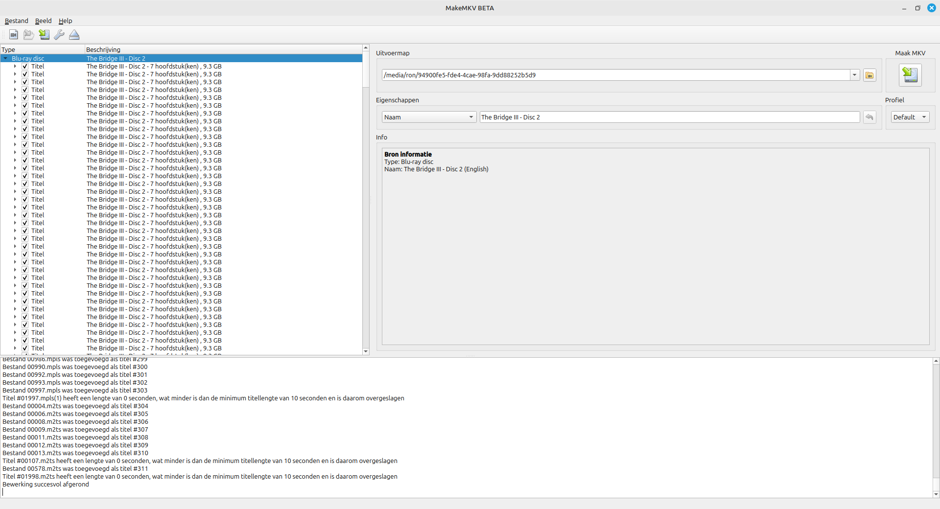

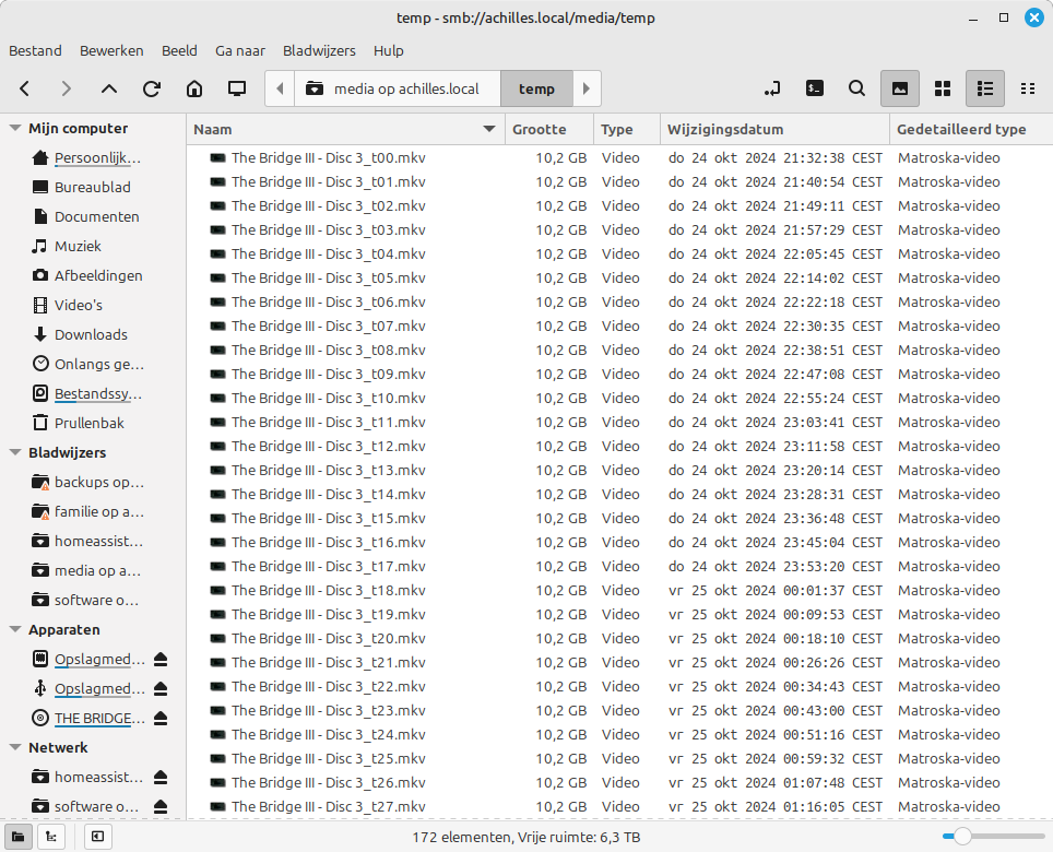

I have ripped manny DVDs and Bluryas without asny problem and the thirts season of the Bridge ( Bron/Broen) is no different. The discs rpi just fine except for one strange problem: All episodes are the same. After I ripped + 140 episodes they all show the same chapter.
I think it is some sort of copy protection but it works like a charm.
Anybody seen this?
I have made screenshots (I think I have attached them even).

Re: The Bridge season 3 hundreds of episodes that all appear the same
Fake playlists are annoying.
What is the correct play list [insert title here]?
I've written about this topic before: https://forum.makemkv.com/forum/viewtopic.php?p=97862#p97862
Someone might've already figured out The Bridge: https://forum.makemkv.com/forum/viewtopic.php?f=8&t=14819
I've also written about a better way to talk about which title is which: https://forum.makemkv.com/forum/viewtopic.php?p=160224#p160224 Using the '_t##" appended to the end of a file isn't a good idea.
Hi there, thanks for posting this and point me the right direction. I have found the chapters and can now add season three to my Plex machine
Bast regards
Ron
