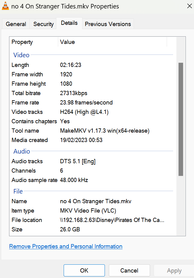

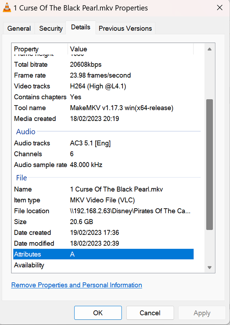

So I must have selected something in MKV ripper while doing 1 to 3, and something else when doing 4 and 5, Ive put an attachment on which has 1 that plays, and has AC3 5.1 English and the one that dont work is DTS 5.1 English

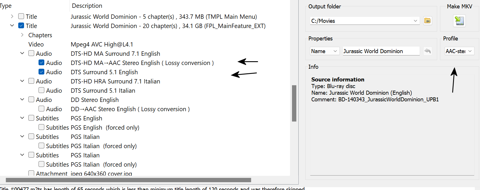

Which brings me back to MKV I really now dont know what I should select, Ive pout up an image (I think) of what Im about to do, so have I been just ripping stereo, and its not possible to make a dolby 5.1 that plays on the Panasonic, with the very high quality but 32Gb size
attachments works
dont work
dont work.png (45.39 KiB) Viewed 4375 times
Snapshot of what Im about to try

As an update to this, the last selection did work, and I transferred it to the NAS, the TV plays it, just by chance i had upgraded my router for wifi 6, and it has a 2.5g WAN port, i decided to connect the movie NAS drive to that, with great transfer results.
So the TV plays a perfect video now, and i am having special effects out of the sound bar, i cant fast foward the movie as it stutters, but it plays from start to end.
At last i can hear the thud in my woofer, and a rustle sound in the back speakers of the velociraptors, its amazing.
