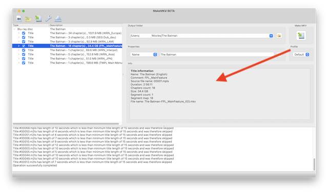

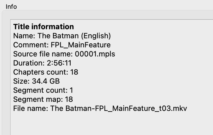

As for going from .m2ts file to playlist… I'm not sure. When I use the GUI, if I highlight a title, in a box on the right, there's a bunch of details about that title.
Those details contain the relationship between .m2ts file and .mpls playlist.
In this example, the playlist 00001.mpls (which lives in the BackupFolder/BDMV/PLAYLIST/ folder) has a single segment in it named 00018.m2ts (which lives in the BackupFolder/BDMV/STREAM folder). So, I'd just file up MPV and point it at 00018.m2ts and verify what that title is (which is obvious in this case). Unfortunately, the .mpls files are not vanilla text files, so you can't just look them to figure out the mapping between title and segment map.
Obviously MakeMKV can interpret the .mpls files. MediaInfo can read a .mpls but it doesn't always seem to tell you the name of the .m2ts files in the playlist (although sometimes it does). I've never had much of a reason to get at it from the command line, so I don't have a good answer.

I just made a .mkv from a decrypted backup (using the GUI). makemkvcon used 125% of my 4-core Intel CPU. The kernel kicked in for another 50%, undoubtedly dealing with all the io requests for the 450M/s writes MakeMKV was making to my SSD.
For fun, I also ripped using the command line:
/Applications/MakeMKV.app/Contents/MacOS/makemkvcon mkv file:/path/to/BACKUP all .
It went just as fast as the GUI, which is what I'd expect.
