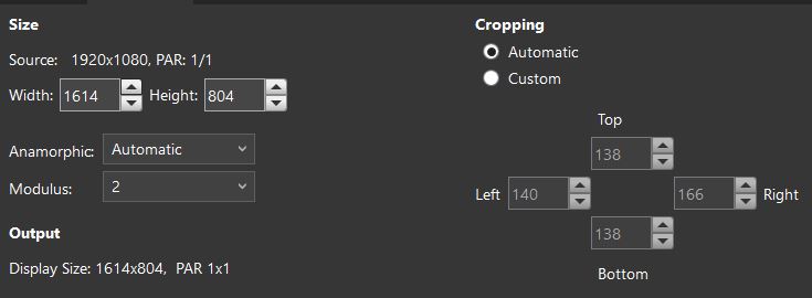

Having an issue where The Batman bluray shows a smaller storage size and display size in Handbrake (1614 x 804) and an aspect ratio of 2.01:1
Even though the source storage size and display size are 1920 x 1080.
The result after ripping multiple times is it says its 720p
I am not doing anything different than I normally do.
Any help???

DaveQ wrote:
Tue Jun 07, 2022 8:49 pm
Go back into Handbrake, set up your encode again, and check the "Cropping" section of the "Dimensions" tab. The top and bottom fields should have values in them, to eliminate the black bars. But the left and right fields shouldn't, unless the original blu-ray was encoded with pillarboxes (non-image areas on the left and right). But it shouldn't be. If the full width of the movie contains image data, then erase any values you find in those left and right fields, ensure the encode is set to produce something 1920 pixels wide, and re-encode.
Hi DaveQ, Are we suppose to change the width setting right below the source line also or leave that alone?
Below is the original settings...nothing changed.
source 1920x1080 par 1/1, width 1614x804.  automatic everything.

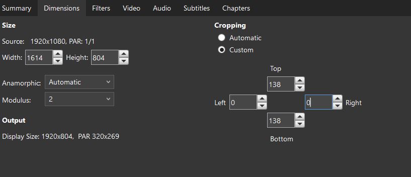

Option 1>>Below is just the cropping changed to custom and left and right zeroed. Width is unchanged and still shows 1614 instead of 1920 and PAR is 320x269
Just change the crop to 0.  Width still says 1614 instead of 1920 and par shows 320x269.
option 1- 0 Left right crop but width still shows 1614.jpg (23.26 KiB) Viewed 24768 times

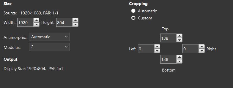

Option 2>> crop changed to custom. Left and right zeroed. Changed width from 1614 to 1920. Par now shows "1x1"
Also changed width to 1920 instead of 1614. par changed to 1x1
Do option 1 and also change width from 1614 to 1920.jpg (19.87 KiB) Viewed 24768 times

So I've been away from these forums for a while and only saw this question today. I apologize for the long delay in responding.
Short answer -- yes, after changing the custom crop settings, you may have to press the up arrow button next to the Width field, until the width reaches the maximum allowable value as determined by your other settings. It looks like those values (Width and Height) don't automatically update when you switch cropping from "Automatic" to "Custom."
The Batman is a very dark film, with deep shadows out near the edges of the frame in many scenes. It's not surprising to me that the auto-detect algorithm is reading that blackness as pillarbox (non-image) area.
Another example of the automatic crop algorithm incorrectly cropping image data is with many Mystery Science Theater 3000 films. Because the bottom part of the frame has the silhouettes of the MST3K characters sitting in theater seats, the dark seats area is mistakenly marked as letterboxed non-image data and the bottom part of the frame is often incorrectly cropped too much.
