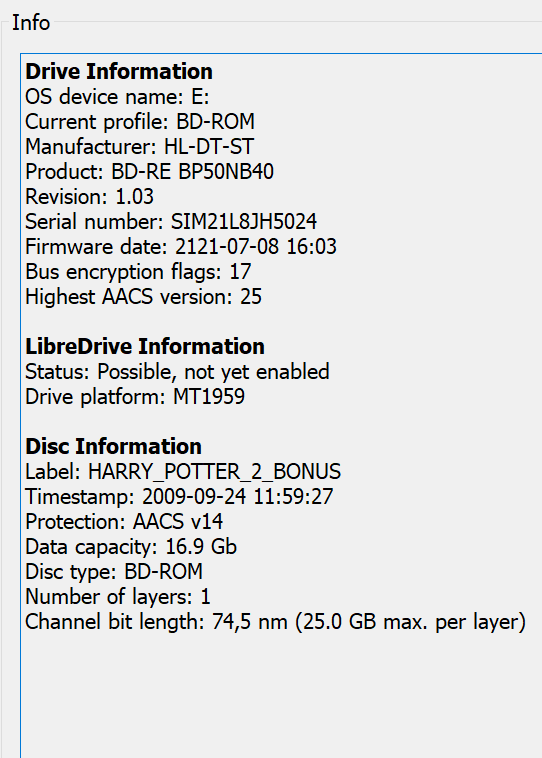

Here is the info it can read
Screenshot (830).png (42.58 KiB) Viewed 9219 times
