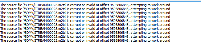

Hi all
I am attempting to rip Total Recall German special edition but it is failing wit the below error, can someone please advise?
Is this discs keys not been added?

There is a problem with reading the disk. Have you tried cleaning it?
If MakeMKV cannot figure out the key for a disk, it won't try reading it, and the log will show the creation of a .TGZ file to submit for analysis. If it starts reading it and then fails, that usually indicates that the drive said it couldn't read the disk, OR (even more diabolical), it sends back "maybe correct" data instead of reporting an error.

Thanks Woodstock
The disc was clean, I tried again and on the 4th attempt it read the entire disc...I assume it is a sensitive disc!
For my future reference, out of curiosity...where would it put the TGZ file, would I need to enable debug mode?...and would we email it to the support address or post it here?
